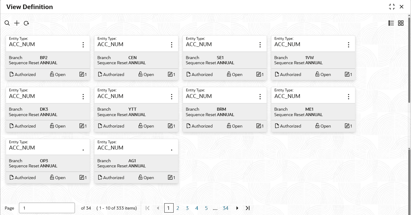

2.2.2 View Definition
This topic describes the systematic instructions to view the configuration of Auto Number generation.
  1. From Home screen, click Retail Lending. Under Retail Lending, click Maintenance.
  2. Under Maintenance, click Auto Number Generation, then click View Definition.
    The View Definition screen is displayed.
  3. Specify the fields on View Definition screen.
    Table 2-4 View Definition - Field Description
    Field Description
    Entity type Displays the entity type.
    Branch Displays the branch code.
    Sequence Reset Displays the frequency of the record.
    The options are:
    • Weekly
    • Semi-Annual
    • Quarterly
    • Monthly
    • Daily
    • Annual
    • None
    Authorization Status Displays the authorization status of the record.
    The options are:
    • Authorized
    • Unauthorized
    Record Status Displays the status of the record.
    The options are:
    • Open
    • Closed
    Modification Number Displays the number of modification performed on the record.
