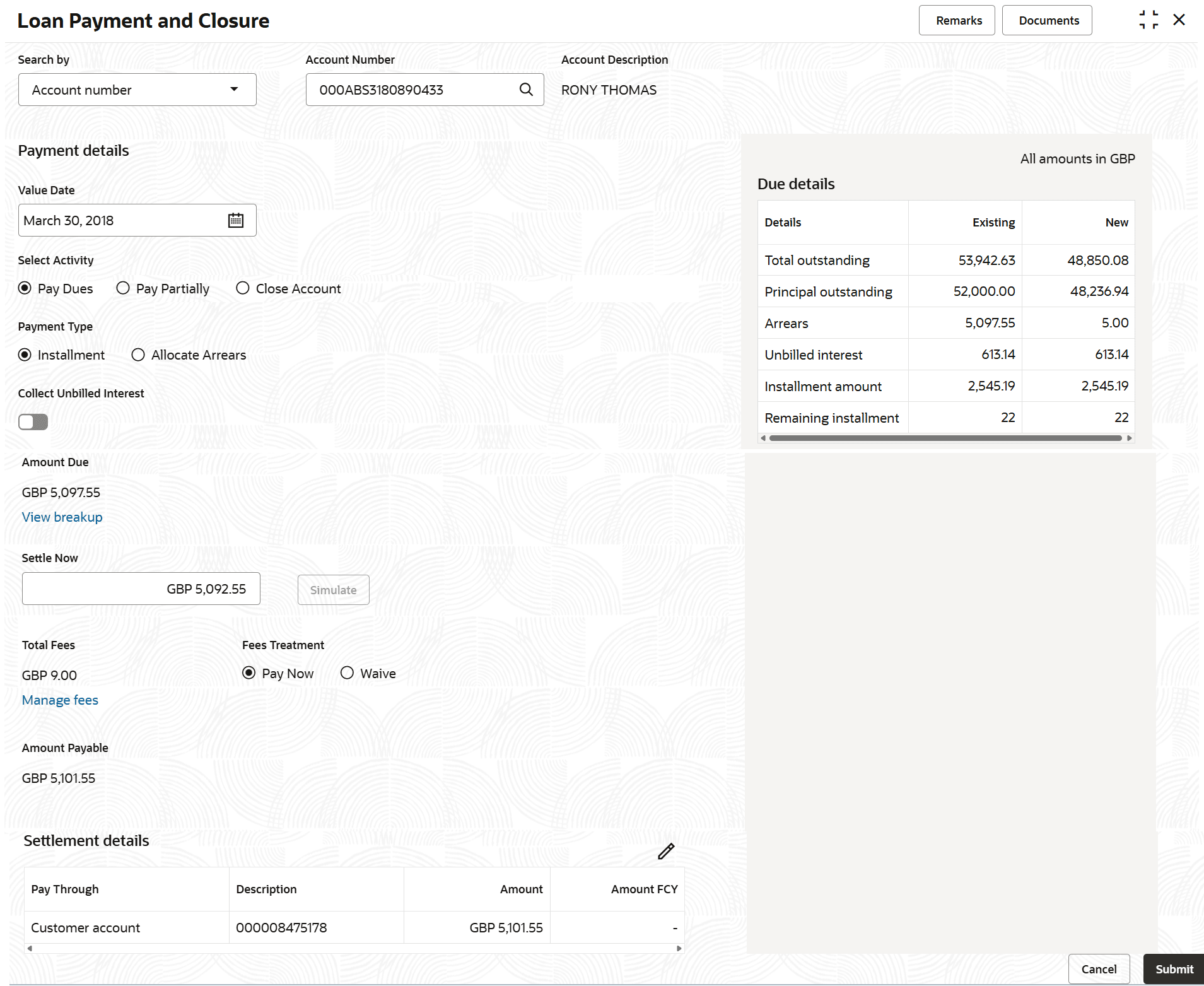

  1. From the Loan Payment and Closure screen, select the Pay Dues option from the Select Activity field.
    • To make payment by installment, select the Installment option from the Payment Type field.
      Figure 3-98 Pay Dues – Installment Payment
      For more information on fields, refer to field description table
          below:
      Table 3-63 Pay Due - Installment Payment – Field Description
      Field Description
      Select Activity Select the Pay Dues for paying the payment.
      For information on other options, refer Paying by Pay Partially Option and Paying by Close Account Option.
      Payment Type Select the appropriate type for paying the loan payment. The options are:
      • Installment Payment: The following fields are displayed, if you select this option.
      • Allocate Arrears: For more information on the related fields, refer Allocate Arrears.
      Collect Unbilled Interest
      Switch to Toggle On to collect all the unbilled interest till date.
      Switch to Toggle Off to not to collect all the unbilled interest till date.
      Amount Due Displays the total loan amount to be paid.
      You can view the details of amount due. For more information, refer View Breakup.
      Settle Now It displays the amount to be paid and it is editable.
      After adjusted the amount, the Simulate option is enabled and after click the Simulate option, the due details are adjusted and displayed.
      Total Fees Displays the fees amount to be paid.
      Fees Treatment There are two options to select the payment, that is Pay Now, and Waive.
      If Waive is selected, the total fees is updated as 0.
      Amount Payable Specify the total payment loan amount.
      You should specify amount less than or equal to the total dues to proceed ahead successfully.
      Settlement Details It displays the settlement details.
      Click the edit icon to edit the settlement details.

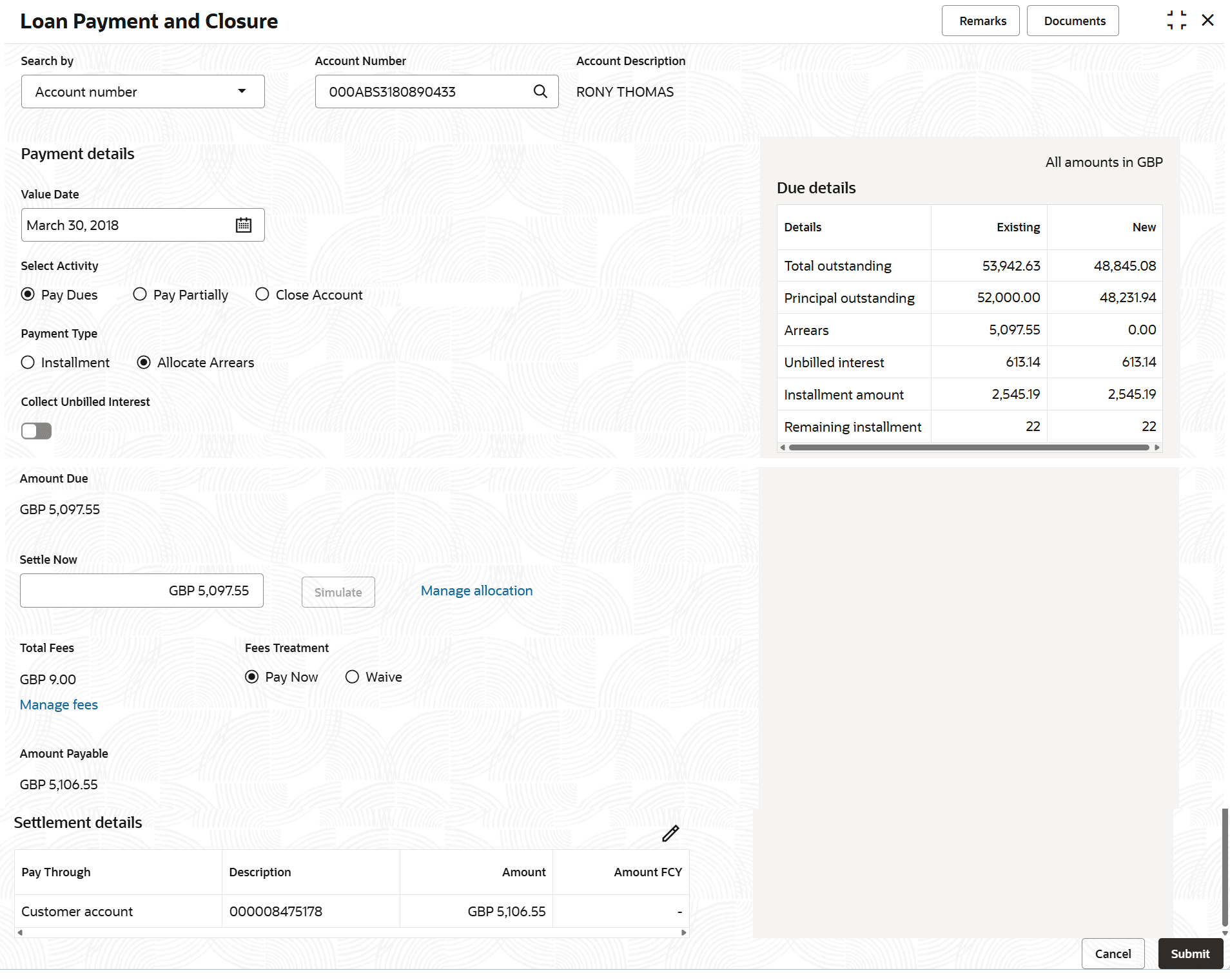

    • To make payment by allocating arrears, select the Allocate Arrears option from the Payment Type field.
      Figure 3-99 Pay Dues - Allocate Arrears
            below:
      Table 3-64 Pay Due - Allocate Arrears – Field Description
      Field Description
      <Other Fields> For information on the fields above this section, refer Installment Payment.

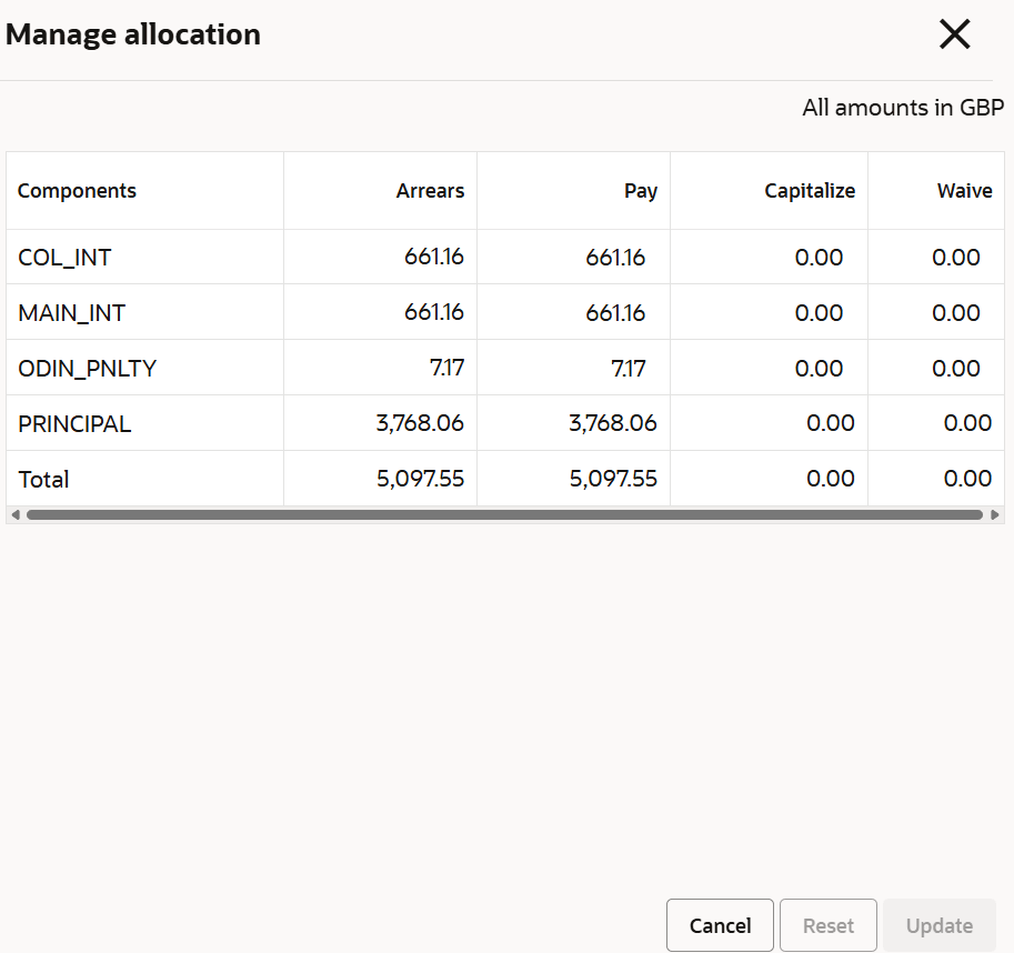

      Manage Allocation This link is displayed if you select the Allocate Arrears option from the Payment Type field.
      • You can specify either pay, capitalize, waive the existing arrears, or perform combination of three.
      • You need to total allocation amount should be less or equal to the arrears amount.
      • To view the amounts after updating the allocations, click Stimulate Allocation.
      Component Displays the components for the allocation.
      Arrears Displays the arrears amount.
      Pay Specify the amount to be paid towards the specific component.
      The system validates the sum of Pay, Capitalize, and Waive for a specific component is not more than the value of respective component's Arrear amount. Based on this validation, an appropriate message is displayed.
      Capitalize Specify the amount to be capitalized towards the specific component.
      For Principal Arrears, this field is not enabled for editing.
      Waive Specify the amount to be waived towards the specific component.
      Total Displays the total of arrears and pay amount.
