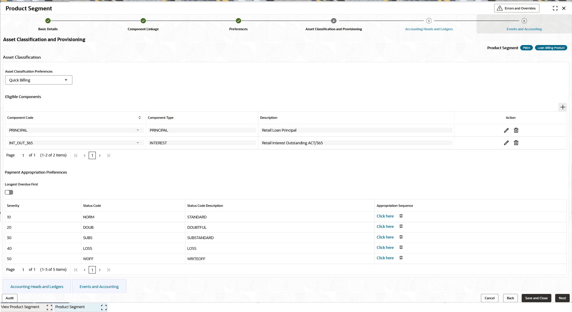

  1. Click Next in the Preferences screen to define the classification and provisioning.
    The Asset Classification and Provisioning screen displays.
    Figure 2-26 Asset Classification and Provisioning
  2. Specify the fields on Asset Classification and Provisioning screen.
    Table 2-27 Asset Classification- Field Description
    Field Description
    Asset Classification Preferences Displays the list of authorized asset classification preferences. The user can choose the one that is applicable to the product in question.
    Table 2-28 Eligible Components - Field Description
    Field Description
    + button Click to add a new row.
    Component Code Select the desired component from a pre-defined list of component codes as are associated to the product.
    Component Type The component type associated with the component code chosen will be displayed.
    Description The component description associated with the component code chosen will be displayed.
    Action The component codes can be added or removed as applicable, using the action button.
    Figure 2-27 Appropriation Sequence

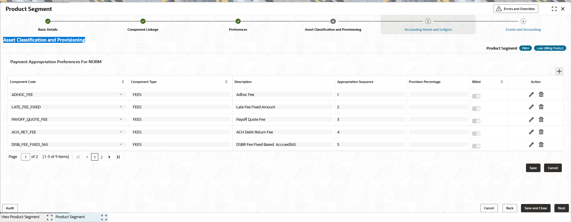

    Table 2-29 Payment Appropriation Preferences - Field Description
    Field Description
    Longest Overdue First The toggle can be used to enable the consideration for longest overdue first.
    If enabled, payment will consider the longest overdue arrears first followed by the appropriation sequence for arrears settlements.
    Note: For Line of Credit, the longest Overdue flag is set as N.
    Severity The severity as carried forward from the asset classification preferences will be displayed.
    Status Code The status codes as carried forward from the asset classification preferences will be displayed.
    Status Code Description The status code description, as applicable for the related status code, as carried forward from the asset classification preferences will be displayed.
    Appropriation Sequence Appropriation sequence for adjusting dues on payments made by the borrowers will be specified using the Click Here link. Refer Appropriation Sequence Updation screenshot for more information.
    The lender can define liquidation order for every status code for components associated to the product. The behavior of this parameter will correlate to the longest overdue first parameter, as applicable.
    • To support the reversal of allocated payments (including those post-backdated transactions and post-backdated allocated payments), the sequence of allocation must be recorded to enable automated reversal and re-posting.
    • This feature restricts user-entered allocations, providing additional flexibility to support bank-level restrictions on supported allocated payment sequences.
    • The Appropriation Liquidation sequence for Line of Credit is as follows:
      • Billed Interest
      • Billed Fees
      • Billed LOC Principal Arrear
      • LOC Principal Balance
      • Unbilled Interest
    Provision Percentage Specify the Provision Percentage.
    Values allowed between greater than 0 and less than or equal to 100, with up to 2 decimal places.
    This field gets displayed only if the Billing Required toggle is disabled in Preferences.
    Billed Click the toggle status to enable the billing for the component code.
    This field gets displayed only if the Billing Required toggle is enabled in Preferences.
    Action The component codes can be added or removed as applicable, using the action button. The appropriation sequence can also be edited, as required.

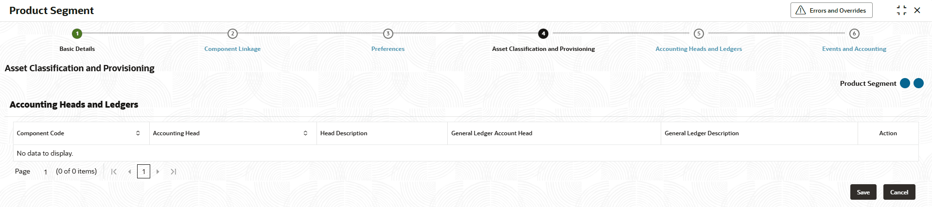

  3. On Asset Classification and Provisioning screen, click Accounting Heads and Ledgers tab.
    The Accounting Heads and Ledgers screen is displayed.
    Figure 2-28 Accounting Heads and Ledgers
    Table 2-30 Accounting Roles and Ledgers - Field Description
    Field Description
    Component Code Displays the Business component code linked in Component Linkage section.
    Accounting Head Displays the accounting head created.
    Head Description Displays the description of the accounting head.
    General Ledger Account Head ClickSearch icon and select the appropriate general ledger from the list. The ledgers are defined in common core and available for the lender to select.
    General Ledger Description Displays the description of the general ledger selected.

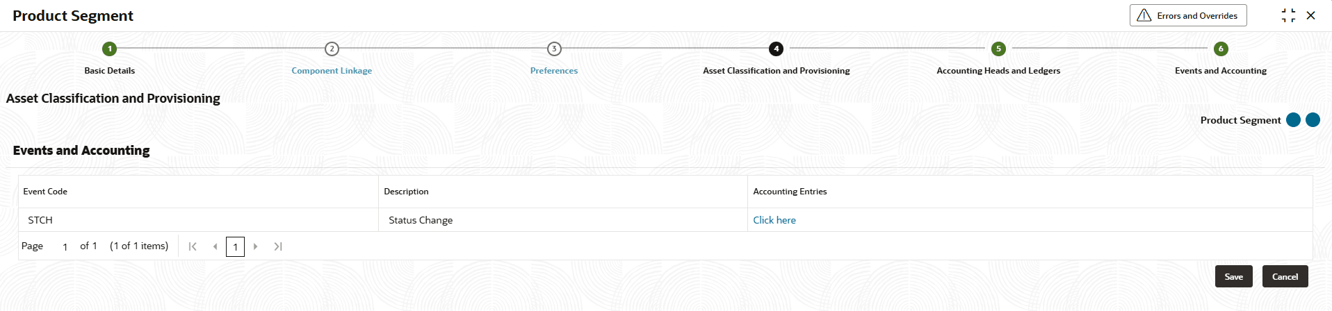

  4. On Asset Classification and Provisioning screen, click Events and Accounting tab.
    The Events and Accounting screen is displayed.
    Figure 2-29 Events and Accounting
    Table 2-31 Events and Accounting - Field Description
    Field Description
    Event Code Displays the event codes.
    Description Displays the description of the event codes.
    Accounting Entries For more information on defining the accounting entries, refer Event and Accounting.
