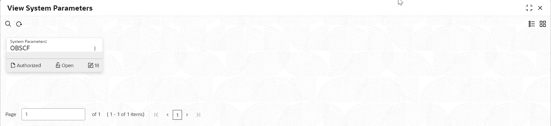

2.1.1 View System Parameters
This topic describes the systematic instruction to view, modify, or authorize the day zero system parameters for Supply Chain Finance module.
A tile is present for each record that has been created. The bottom portion of each record-tile displays the following:
  • The status, whether Authorized, Unauthorized, or Rejected
  • Open or Closed
  • The number of times the record has been submitted by the Maker added.
  1. On Home screen, click Supply Chain Finance. Under Supply Chain Finance, click Maintenance. Under Maintenance, Click System Parameters.
  2. Under System Parameters, click View System Parameters.
    The View System Parameters screen displays.
    Figure 2-1 View System Parameters
  3. Click Options icon and select Unlock to modify the records.

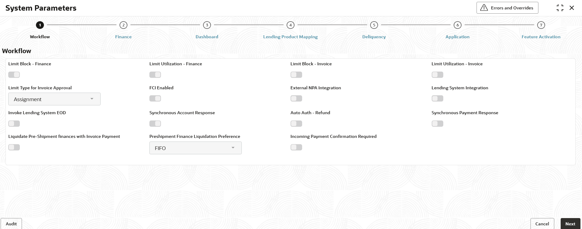

    The System Parameters - Workflow (parameters) screen displays.
    Figure 2-2 System Parameters - Workflow
  4. On Workflow tab, default configuration of workflow parameters is displayed and can be configured as per the bank's requirements.
    Table 2-1 Workflow - Field Description
    Field Name Description
    Limit Block – Finance Switch the toggle ON to enable limit blocking during finance transactions.
    Limit Utilization – Finance Switch the toggle ON to enable limit utilization and release during finance transactions.
    Limit Block – Invoice Switch the toggle ON to enable limit blocking during invoice transactions.
    Limit Utilization – Finance Switch the toggle ON to enable limit utilization and release during invoice transactions.
    Limit Type for Invoice Approval Select the limit type required for invoice approval.
    FCI Enabled Switch the toggle ON to enable or disable the FCI integration.
    External NPA Integration Switch the toggle ON to enable the NPA integration with external system.
    Lending System Integration Switch the toggle ON to enable the Integration with lending system.
    Invoke Lending System EOD Switch the toggle ON to enable the Integration of EOD process with the Lending System.
    Synchronous Account Response Switch the toggle ON to enable the account response as synchronous.
    Auto Auth – Refund Switch the toggle ON to enable the auto authorization required for the refund transactions.
    Synchronous Payment Response Switch the toggle ON to enable the payment response as synchronous.
    Liquidate Pre-Shipment finances with Invoice Payment Switch this toggle ON to enable the liquidation of pre-shipment finances where post-shipment finance is not identified for an invoice.
    Pre-Shipment Finance Liquidation Preference
    Select the liquidation preference for the settlement of pre-shipment finance.
    The available options are:
    • FIFO
    • Invoice linked with PO and FIFO
    This field is mandatory if Liquidate Pre-Shipment finances with Invoice Payment is enabled.
    Incoming Payment Confirmation Required Switch the toggle ON to enable the confirmation for the incoming payment.
    For existing implementations where pre-shipment finances exist, a new parameter Liquidate Pre-Shipment finances for Invoice Disbursement is introduced at the system level.
    During version upgrade, the system will read the value of Liquidate Pre-Shipment finances for Invoice Disbursement and update the data for Pre-Shipment Finance Liquidation Preference and Liquidation Order for Auto Debit fields in Post-shipment programs based on this maintenance in the System Parameters. A migration script will be prepared for relevant Post-shipment programs during upgrade.

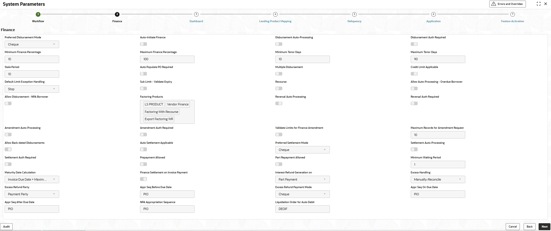

    The System Parameters - Finance (parameters) screen displays.
    Figure 2-3 System Parameters - Finance
  6. On Finance tab, default configuration of finance parameters is displayed and can be configured as per the bank's requirements.
    Table 2-2 Finance - Field Description
    Auto-Initiate Finance Switch the toggle ON to enable the Auto-Initiation of the finance disbursement transaction.
    Preferred Disbursement Mode
    Select the preferred disbursement mode for the finance transaction.
    • Cheque
    • EFT
    • CBT - Cross Border Transfer
    • Account Transfer
    Disbursement Auto – Processing Switch the toggle ON to enable the auto processing of the finance disbursement transaction.
    Disbursement Auth Required Switch the toggle ON to enable the authorization required for the disbursement of the finance transaction.
    Minimum Finance Percentage Specify the minimum finance percentage of Invoice amount allowed for financing.
    Maximum Finance Percentage Specify the minimum finance percentage of Invoice amount allowed for financing.
    Minimum Tenor Days Specify the minimum tenor allowed for a finance.
    Maximum Tenor Days Specify the maximum tenor allowed for a finance.
    Stale Period Specify the stale period in days after which the invoice cannot be financed any more. Stale period is calculated from Invoice date.
    Multiple Disbursement Switch this toggle ON if multiple disbursement is allowed on same invoice.
    Auto Populate PO Required Switch this toggle ON to auto populate the PO required.
    Credit Limit Applicable Switch the toggle ON to enable the credit limits applicability to the product.
    Default Limit Exception Handling
    Select the default exception handling for the Limit services.
    • Stop
    • Skip
    • Utilize
    Sub Limit - Validate Expiry Switch the toggle ON to enable the Expiry date validation for the sub-limits.
    Recourse Switch the toggle ON to enable recourse for the program.
    Allow Auto-Processing - Overdue Borrower Switch the toggle ON to enable the auto processing of disbursement for Overdue borrower.
    Allow Disbursement - NPA Borrower Switch the toggle ON to enable the disbursement for NPA borrower.
    Factoring Products Select the preferred products for the finance transaction.
    Reversal Auto Processing Switch the toggle ON to enable the auto processing of finance reversal transaction.
    Reversal Auth Required Switch the toggle ON to enable the authorization required for the reversal of the finance transaction.
    Amendment Auto-Processing Switch the toggle ON to enable the auto processing of finance amendment transaction.
    Amendment Auth Required Switch the toggle ON to enable the authorization required for the amendment of the finance transaction.
    Validate Limits for Finance Amendment Switch this toggle ON to enable limits validation for finance amendment transaction.
    Maximum Records for Amendment Request Specify the maximum number of finance amendment requests that can be raised.
    Allow Back-Dated Disbursements Switch the toggle ON to enable the back-dated disbursements.
    Auto Settlement Applicable Switch the toggle ON to enable Auto-Initiation of the finance repayment transaction.
    Preferred Settlement Mode
    Select the preferred settlement mode for the finance transaction.
    • Account Transfer
    • Cheque
    • EFT
    Settlement Auto – Processing Switch the toggle ON to enable the auto processing of the finance repayment transaction.
    Settlement Auth Required Switch the toggle ON to enable the authorization required for the repayment of the finance transaction.
    Prepayment Allowed Switch the toggle ON to enable the prepayment for the finance. That is Part or full repayment before the finance due date.
    Part Repayment Allowed Switch the toggle ON to enable the part repayment for the finance.
    Minimum Waiting Period Specify the minimum period up to which the finance cannot be closed. This should be enabled only if pre-closure is allowed.
    Maturity Date Calculation
    Select the finance maturity date calculation method.
    • Business Date + Maximum Tenor
    • Payment Due Date
    • Invoice Due Date
    • Invoice Due Date + Maximum Tenor
    Finance Settlement on Invoice Payment Switch the toggle ON to enable the underlying Finance repayment post the manual recon for the Invoice payment.
    Interest Refund Generation on
    Select the type of payment for Interest Refund to be generated.
    • Part Payment
    • Full Payment
    Excess Handling
    Select how excess payment made towards settling of outstanding invoice/finance should be handled.
    • Auto-Reconcile
    • Auto-Reconcile and Refund
    • Manually-Reconcile
    • Refund to beneficiary or payment party
    Excess Refund Party
    Select the party to refund the excess amount.
    • Beneficiary/Counter Party
    • Payment Party
    Appr Seq Before Due Date
    Specify the appropriation sequence for the repayment amount if the payment is received before due date.
    • I - Interest
    • P - Principal
    • E - Penalty on Interest
    Valid Values – PIE, PEI, IPE, IEP, EIP, EPI
    Excess Refund Payment Mode
    Select the mode of payment for the excess payment refund.
    • Account Transfer
    • Cheque
    • EFT
    Appr Seq On Due Date
    Specify the appropriation sequence for the repayment amount if payment is received on due date.
    • I - Interest
    • P - Principal
    Appr Seq After Due Date
    Specify the appropriation sequence for the repayment amount if payment is received after due date.
    • I - Interest
    • P - Principal
    • O - Penalty on Principal
    Valid Values – EOIP, EIOP, etc.,
    NPA Appropriation Sequence
    Specify the appropriation sequence for the repayment amount if payment is received after the finance has turned NPA.
    • I - Interest
    • P - Principal
    Valid Values – EOIP, EIOP and so on.
    Specify the default auto-debit liquidation order to be applied in case partial funds are debited from the payment party on auto-debit.
    • E - Penalty on Interest Outstanding
    • O - Penalty on Principal Outstanding
    • I – Monthly Interest Due
    • D - Overdue Finance (Delinquent finances)
    • F - Finance Due or Overdue (Outstanding Finances)
    This field is mandatory if Auto Debit Applicable is enabled.

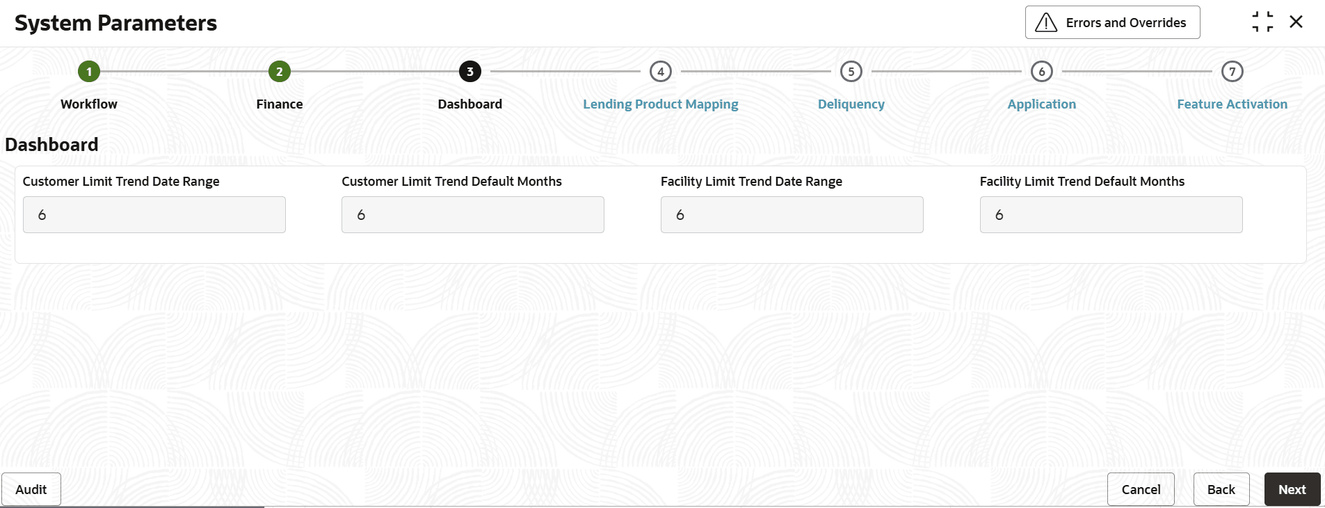

    Figure 2-4 System Parameters - Dashboard
  8. On Dashboard tab, default configuration of dashboard parameters is displayed and can be configured as per the bank's requirements.
    Table 2-3 Dashboard - Field Description
    Field Description
    Customer Limit Trend Date Range Specify the date range for the customer limit trend in the dashboard.
    Customer Limit Trend Default Months Specify the month range for the customer limit trend in the dashboard.
    Facility Limit Trend Date Range Specify the date range for the facility limit trend in the dashboard.
    Facility Limit Trend Default Months Specify the month range for the facility limit trend in the dashboard.

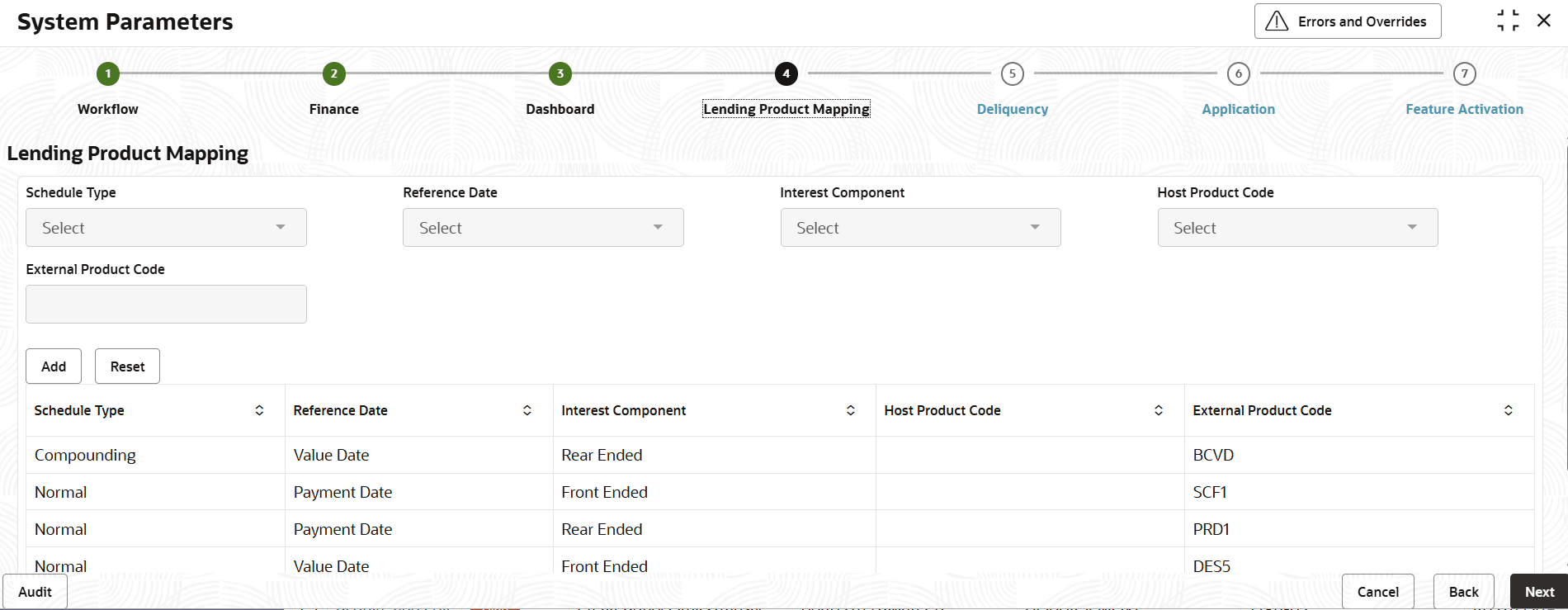

    The System Parameters - Lending Product Mapping screen displays.
    Figure 2-5 System Parameters - Lending Product Mapping
  10. On Lending Product Mapping tab, default configuration of lending product mapping parameters is displayed and can be configured as per the bank's requirements.
    Table 2-4 Lending Product Mapping - Field Description
    Field Description
    Schedule Type
    Select the interest rate schedule.
    • Normal
    • Compounding
    Reference Date
    Select the reference date for the interest schedule.
    • Value Date
    • Payment Date
    Interest Component
    Select the type of Interest component.
    • Front Ended
    • Rear Ended
    Host Product Code Select the host product code to map individual supply chain products to external product codes.
    External Product Code
    Specify the product code defined in the Lending System.
  11. Once you enter the details, click Add or click Reset to reset the fields, if required.

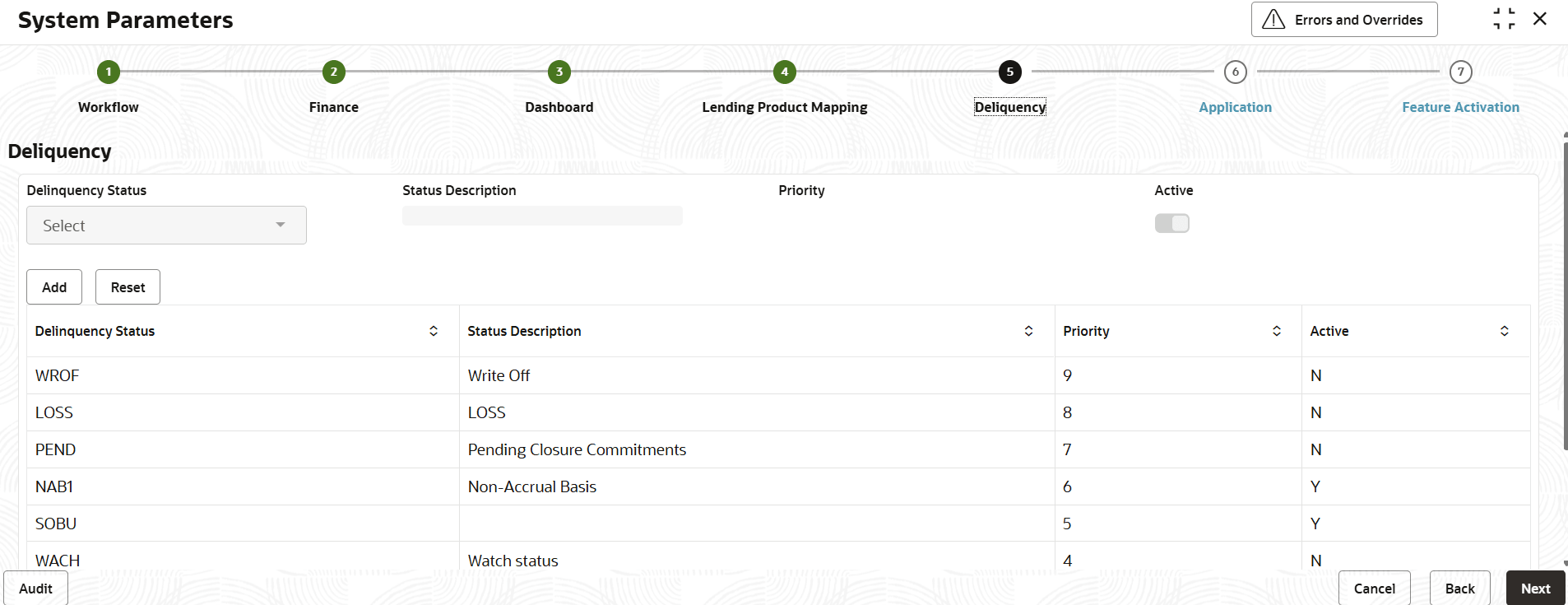

    The System Parameters - Delinquency (parameters) screen displays.
    Figure 2-6 System Parameters - Delinquency
  13. On Delinquency tab, default configuration of delinquency parameters is displayed and can be configured as per the bank's requirements.
    Table 2-5 Delinquency - Field Description
    Delinquency Status
    Select the delinquency status as per the regulatory requirements. Relevant statuses maintained in lending system gets populated here.
    Example:
    • NORM - Normal Status
    • CAU - Caution
    • WACH - Watch Status
    Status Description
    Displays the description of the delinquency status selected.
    Example:
    • NAB - Non-Accrual Basis
    Priority Displays the priority of the delinquency status selected.
    Active Switch the toggle ON to enable the type of delinquency status as Active depending on regulatory requirements.
  14. Once you enter the details, click Add. or click Reset to reset the fields, if required
    1. Once an entry is made in the grid, click in the Action column, to Edit or Delete it.

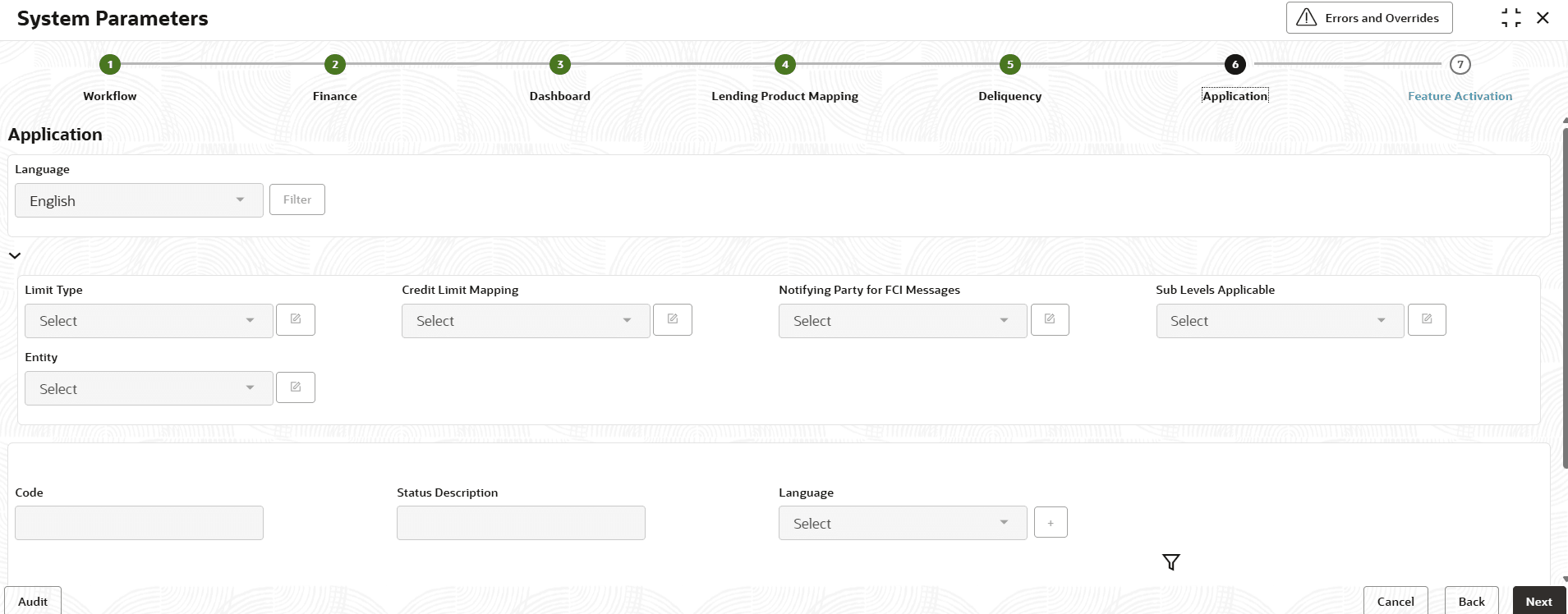

    The System Parameters - Application (parameters) screen displays.
    Figure 2-7 System Parameters - Application
  16. On Application tab, default configuration of application parameters is displayed and can be configured as per the bank's requirements.
    Table 2-6 Application - Field Description
    Language Select the language from the drop-down and click Filter. This displays the existing codes created for each application parameter in the selected language.
    Limit Type
    Displays the list of limit types to be mapped with entity in the Limits Structure maintenance.
    Click the Modify icon to add new, or view the existing limit types.
    Notifying Party for FCI Messages
    Displays the list of notifying parties on whose behalf the relevant FCI message is sent for the applicable events such as Raise Dispute action in the Receivables and Payables Management screen.
    Click the Modify icon to add new, or view the existing notifying parties.
    Sub Levels Applicable
    Displays the list of entities that are applicable for maintaining sub level exception handling in the Credit Limit Mapping tab in Product Parameters maintenance.
    Click the Modify icon to add new, or view the existing entities for sub level exception handling.
    Entity
    Displays the list of entities in the Supply Chain Finance application.
    Click the Modify icon to add new, or view the existing entities.

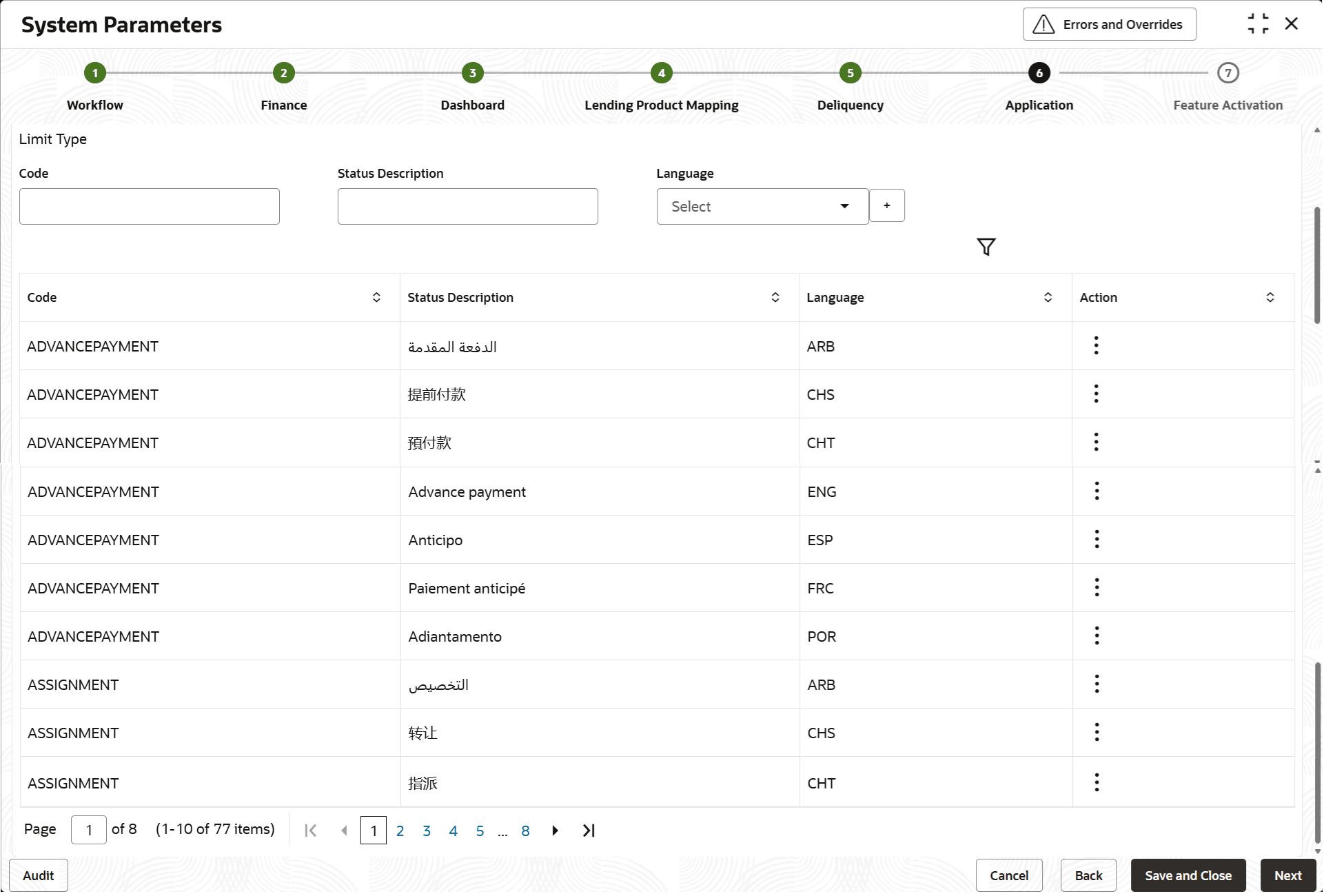

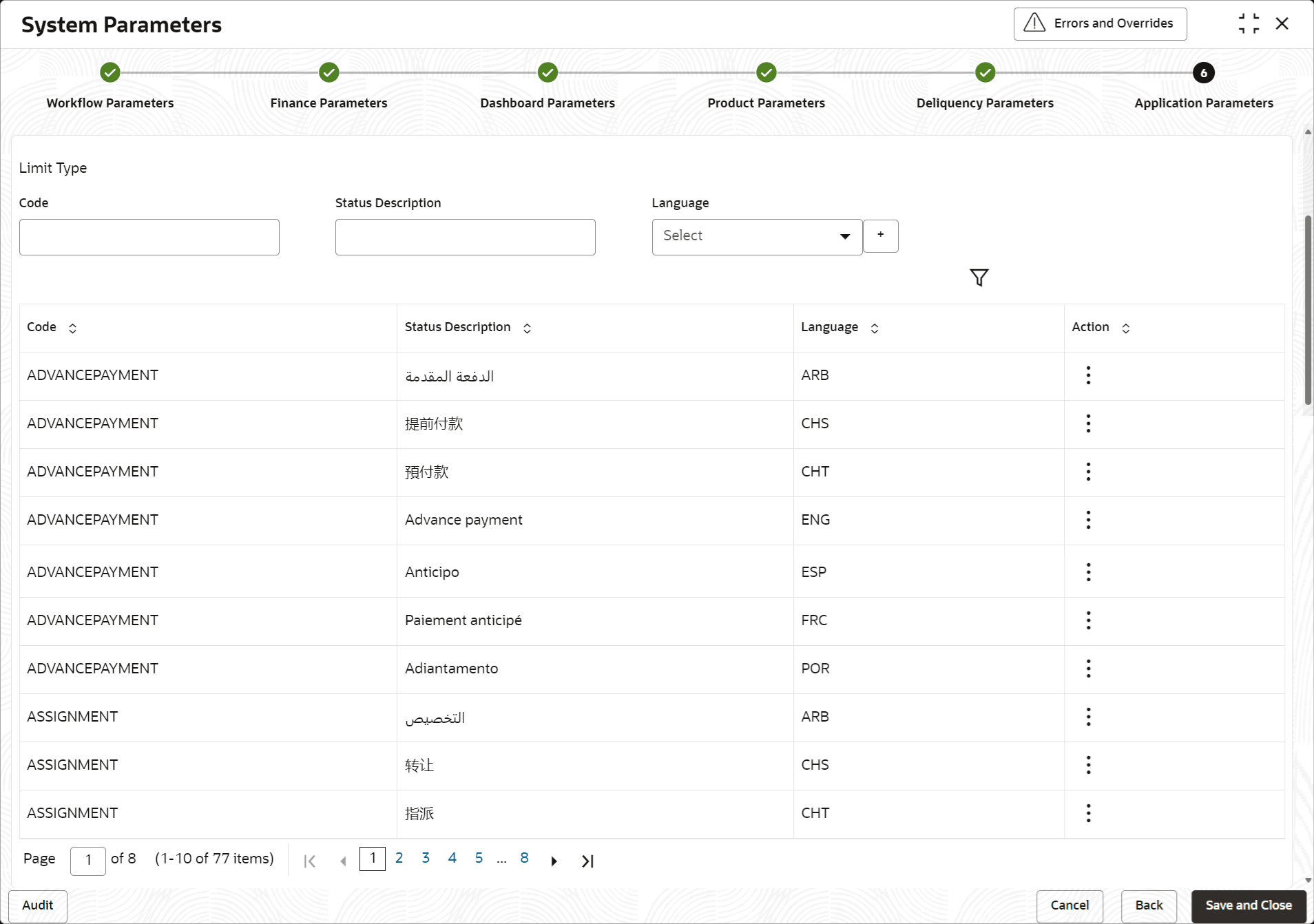

  17. Click the Modify icon next to the required application parameter for which a new code needs to be created.
    The application displays the selected parameter in the section below. You can create new codes or view the existing codes.
    Figure 2-8 Application - Parameter Modification
  18. Specify the values in the below fields and click the Add icon to add the new codes.
    Table 2-7 Parameter Modification - Field Description
    Parameter Name Displays the name of the application parameter selected for modification.
    Code Specify the unique code to be created for the selected application parameter.
    Status Description Specify the description for the code to be created. You can specify the description in the required language.
    Language Select the language for which the code is to be created.
  19. Click Next button.
