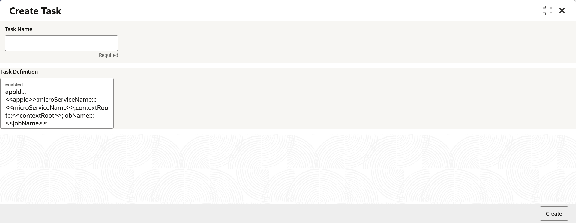

- On Home screen, click Task
Management. Under Task Management, click
Create Task.The Create Task screen displays.
- On Create Task screen, specify the fields.For more information on fields, refer to the field description table.
The fields marked as Required are mandatory.Table 1-1 Create Task - Field Description
Field Name Description Task Name Specify a unique name for the task being created. Task Description Specify the description for the task being created. The syntax is: appId:::<<appId>>;microServiceName:::<<microServiceName>>;contextRoot:::<<contextRoot>>;type:::<< type Of Schedule >>;jobName:::<< JOB to be triggered >>;destination:::<<Topic for which the trigger is defined>>;cronExpression:::<<cronExpression>> (without spaces)
