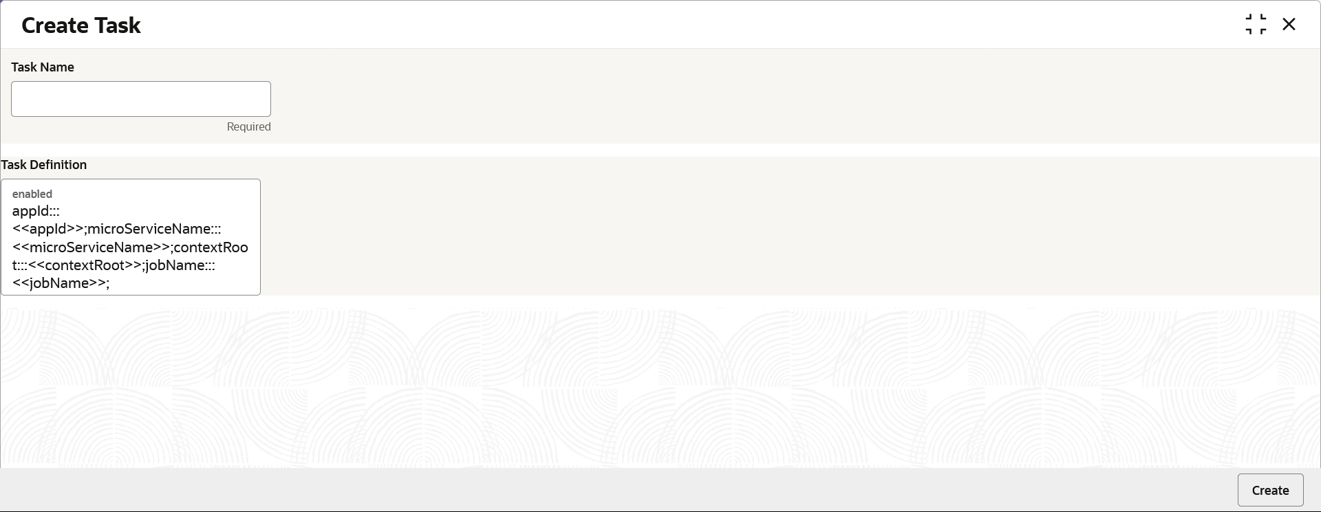

1.1 Create Tasks
This topic describes the systematic instruction to create a task for a specific purpose.
- On Home screen, click Task
Management. Under Task Management, click
Create Task.The Create Task screen displays.
- On Create Task screen, specify the fields.For more information on fields, refer to the field description table.
The fields marked as Required are mandatory.Table 1-1 Create Task - Field Description
Field Name Description Task Name Specify a unique name for the task being created. Task Description Specify the description for the task being created. The syntax is: appId:::<<appId>>;microServiceName:::<<microServiceName>>;contextRoot:::<<contextRoot>>;type:::<< type Of Schedule >>;jobName:::<< JOB to be triggered >>;destination:::<<Topic for which the trigger is defined>>;cronExpression:::<<cronExpression>> (without spaces)
The values that must be provided for the appId, the microServiceName, the contextRoot, and the jobName are detailed in the Table 1-2 table. Some of these tasks come as part of the day 0 set up.
