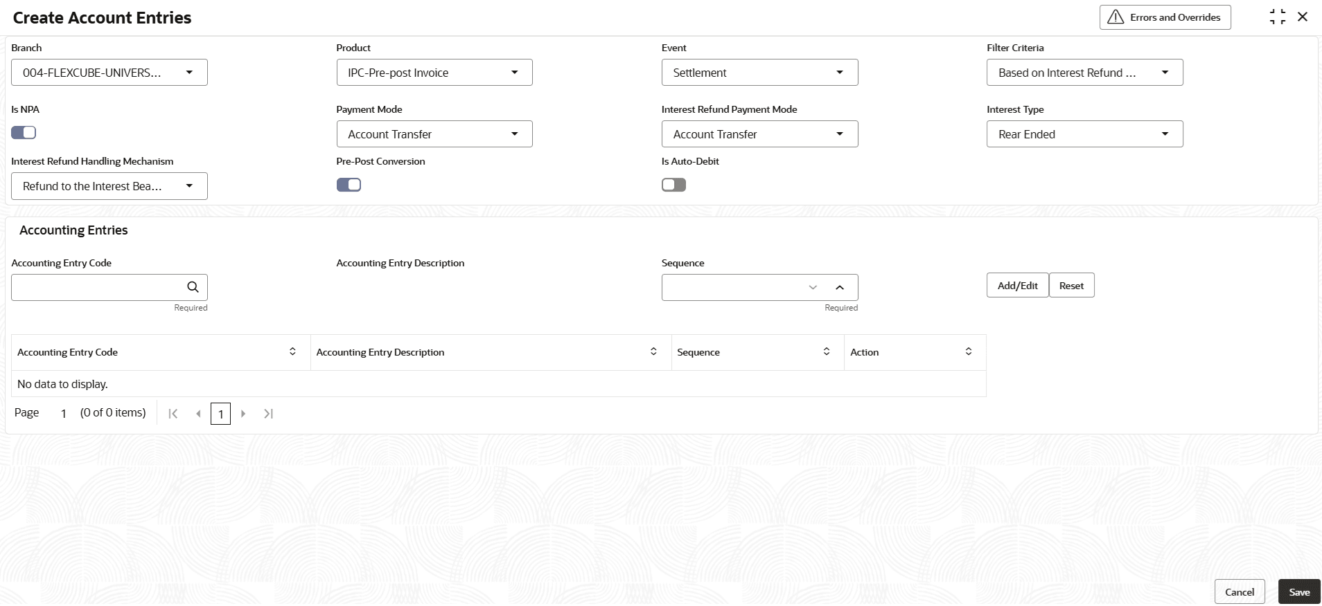

    The Create Account Entries screen displays.
    Figure 2-25 Create Account Entries
  4. Specify the fields on Create Account Entries screen.
    The fields marked as Required are mandatory.
    Table 2-19 Create Account Entries - Field Description
    Field Description
    Branch Select the branch to add accounting entries for. Values in this field are listed based on your access rights.
    Product Select the product to add accounting entries for. User can select ALL to create the entry code for all the products.
    Event
    Select the event to add accounting entries for.
    The available options are:
    • Amendment
    • Auto Debit
    • Disbursement
    • Disbursement Reversal
    • Excess Refund
    • Interest Refund
    • Margin Refund
    • Residual Payment Refund
    • Settlement
    • Settlement Reversal
    Filter Criteria Select the filter criteria for specific application of accounting entries. Based on the selected filter criteria, select the type/mode from the respective field(s) that appear. For more information, refer to Table 2-20.
    Charge Category Select the charge category from the drop-down. The available options are:
    • Tax
    • Standard
    This field appears if the Filter Criteria is selected as Based on Charges.
    Charge Type Select the charge type from the drop-down. The available options are:
    • Credit
    • Debit
    Charge Liquidation Type Click the drop-down list and select the options from below:
    • Liquidate Online
    • Defer Charges
    • Liquidate Deferred Charges
    Is NPA Switch this toggle ON if the accounting entry is for an NPA.
    Payment Mode
    Select the mode of the payment.
    • Account Transfer
    • CBT – Cross Border Transfer
    • Cheque
    • EFT
    Interest Refund Payment Mode
    Select the mode of the payment for interest refund.
    • Account Transfer
    • Cheque
    • EFT
    Interest Type
    Select the type of interest collection.
    • Front Ended
    • Rear Ended
    Interest Refund Handling Mechanism
    Select how the interest refund should be handled.
    • Manually Settle O/s Finances
    • Refund to the Interest Bearing Party
    • Settle with Outstanding Finances
    Pre-Post Conversion Switch this toggle ON if the accounting entry is for a pre-post conversion.
    Is Auto-Debit Switch this toggle ON if the accounting entry is for a debit initiated through auto-debit.
    Charge Type Select the charge type as Credit or Debit.
    Payment Party
    Select the payment party if the accounting entry set up is separate for a specific payment party.
    • Buyer
    • Supplier
    Account Type
    Select the type of account to be mapped.
    • OD A/C
    • CASA
    Accounting Entries This section displays the following fields to select the accounting entry code and map it to an accounting entry.
    Accounting Entry Code Click the Search icon to select the required accounting entry code.
    Accounting Entry Description Displays the description of the selected entry code.
    Sequence Select the sequence to be set for the accounting entry code.
    Table 2-20 Filter Criteria for Events - Field Description
    Event Filter Criteria Additional Filter Options
    Amendment Interest Collection Type
    • Interest Type
    Charge Based
    • Charge Type
    Disbursement Payment Mode, Interest Collection Type and Pre-Post conversion
    • Payment Mode
    • Interest Type
    • Pre-Post Conversion
    Charge Based
    • Charge Type
    Settlement Based on Interest Refund Payment Mode
    • Is NPA
    • Payment Mode
    • Interest Refund Payment Mode
    • Interest Type
    • Interest Refund Handling Mechanism
    • Is Auto-Debit
    Based on Interest Refund Handling Mechanism
    • Is NPA
    • Payment Mode
    • Interest Type
    • Is Auto-Debit
    Based on Interest Collection Type
    • Is NPA
    • Payment Mode
    • Interest Type
    • Is Auto-Debit
    Based on Charges
    • Charge Category
    • Charge Type
    • Charge Liquidation Type
    Auto-Debit Default
    • NA
    Payment Party, Account Type and Payment Mode Based
    • Payment Party
    • Account Type
    • Payment Mode
    Interest Refund Payment Mode Based
    • Payment Mode
    Margin Refund Payment Mode Based
    • Payment Mode
    Excess Refund Payment Mode Based
    • Payment Mode
    Residual Payment Refund Payment Mode Based
    • Payment Mode

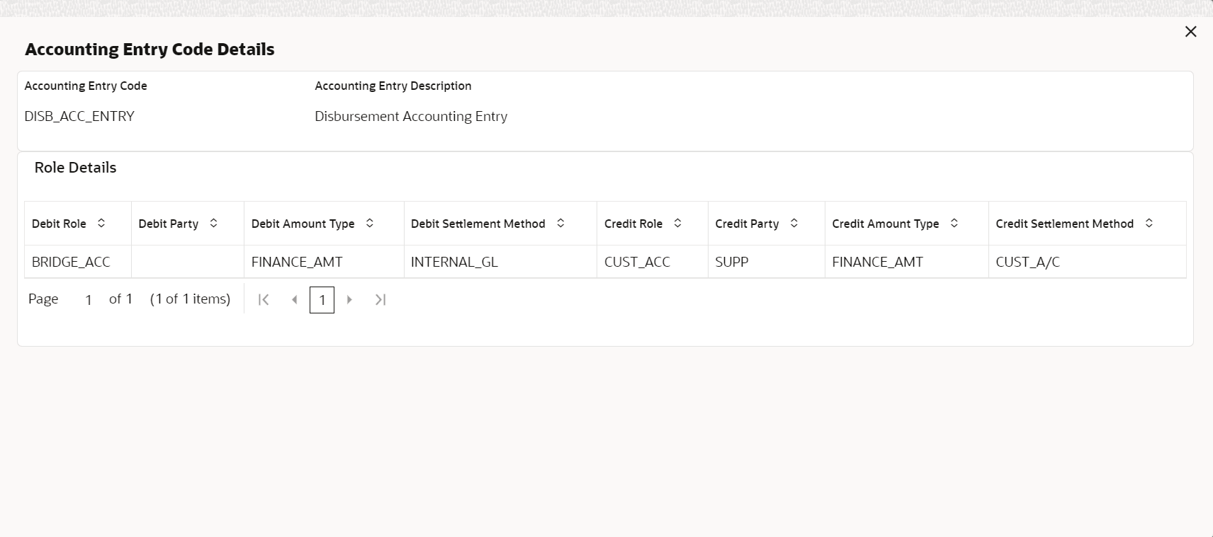

  6. Click the hyperlink to view the details of the selected Accounting Entry Code.
    The Accounting Entry Code Details screen displays.
    Figure 2-26 Accounting Entry Code Details
