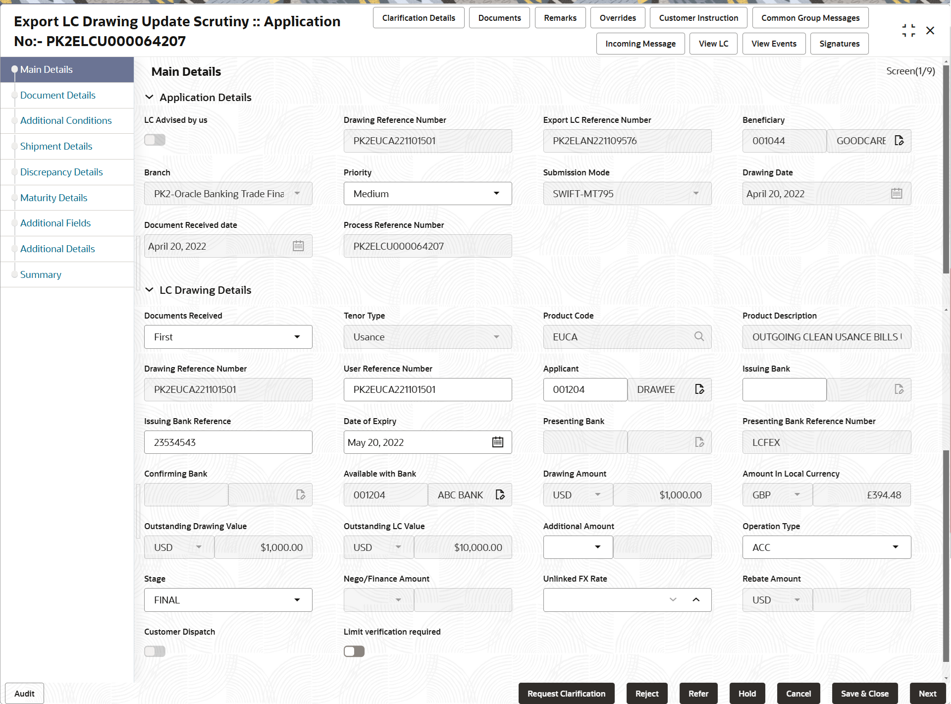

2.3.1 Main Details
This topic provides the systematic instructions to initiate the main details of Scrutiny stage of Export LC Update Drawings request.
- Application Details
- LC Details.
All fields displayed under Application Details section, would be read only except for the 'Priority'.
- On Scrutiny - Main Details screen, specify the fields
that were not entered at Registration stage.
Figure 2-7 Scrutiny - Main Details
Description of the illustration scrutinymainapplicationdetails.pngFor more information on fields, refer to the field description table below.Table 2-6 Export LC Update Drawings - Main Details - Application Details - Field Description
Field Description LC Advised by us Read only field. The value is auto-populated from the Registration stage.
Drawing Reference Number Read only field. The value is auto-populated from the Export LC Drawing.
Export LC Reference Number Read only field. The value is auto-populated from the Export LC Drawing.
Beneficiary Read only field. The value is auto-populated from the Export LC Drawing.
Branch Read only field. Branch details is auto-populated based on the selected Export LC Reference Number.
Priority System populates the priority of the customer based on priority maintenance. If priority is not maintained for the customer, system will populate 'Medium' as the default priority. User can change the priority populated any time before submit.
Submission Mode Read only field. System populates the submission mode of Export LC Drawing request.
By default the submission mode will have the value as ‘Desk’.
- Desk - Request received through Desk
- Courier - Request received through Courier
- Email - Request received through email
- Fax - Request received through Fax
Drawing Date Read only field. System displays the drawing date.
By default, the application will display branch’s current date.
Document Received Date Read only field. By default, the application will display branch’s current date.
Process Reference Number Read only field. Unique sequence number for the transaction.
This is auto generated by the system based on process name and branch code.

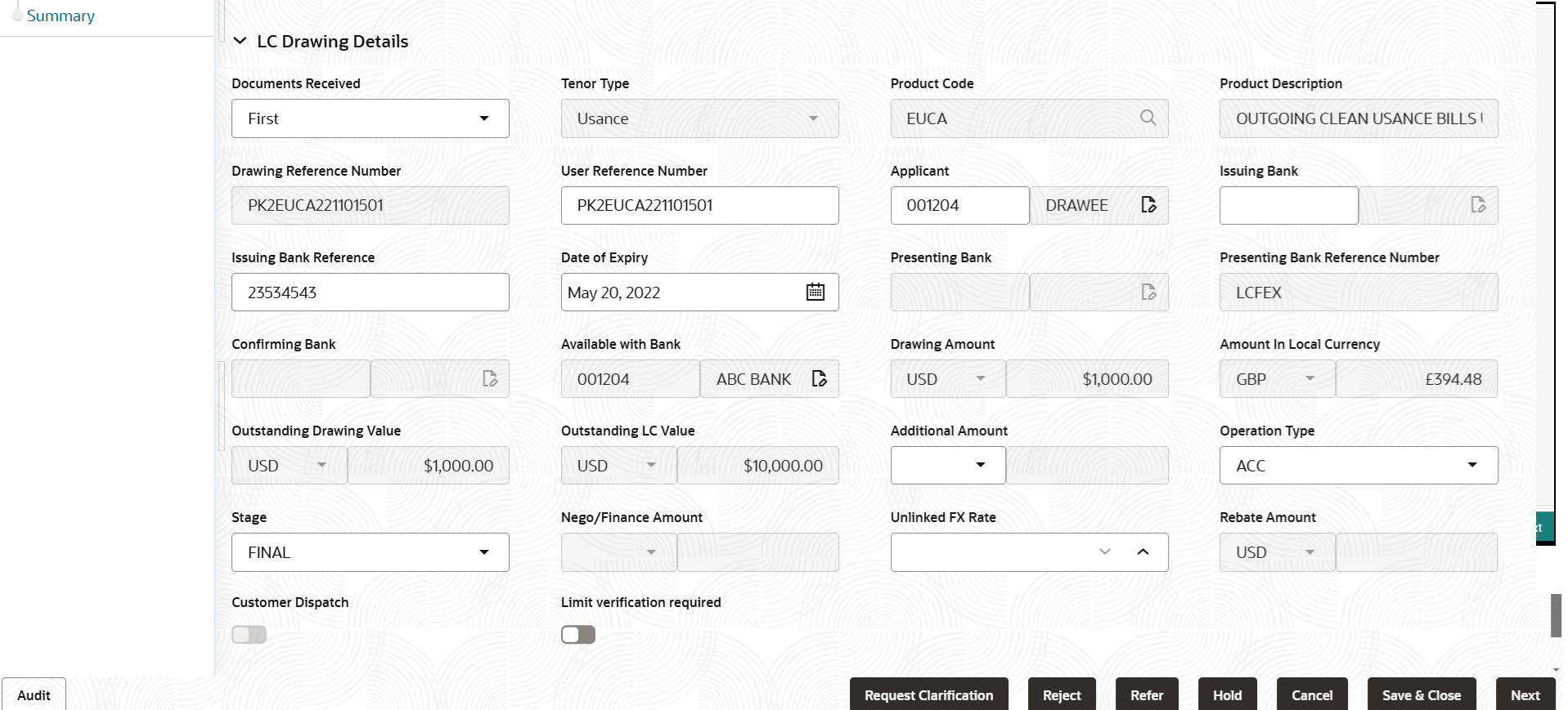

LC DetailsThe fields listed under this section are same as the fields listed under the LC Details section in Registration stage. For more information on the fields, refer to LC Details of Registration stage. During registration, if user has not captured input, then user can capture the details in this section.
Figure 2-8 LC Details
Description of the illustration scrutinymainlcdetails.pngFor more information on fields, refer to the field description table below.
Table 2-7 Export LC Update Drawings - LC Details - Field Description
Field Description Documents Received Select the number of sets of documents received from the drop-down. The options are:- First
- Second
- Both
Tenor Type Read only field. Tenor type is auto-populated based on the selected drawing.
Product Code Read only field. Product code is auto-populated based on the selected drawing.
Product Description Read only field. This field displays the description of the product as per the product code.
Drawing Reference Number Read only field. Drawing reference number is auto-populated based on the selected drawing.
User Reference Number System defaults the user reference number based on the product code. The user can change the user reference number.
Applicant Read only field. Applicant details is auto-populated based on the selected drawing.
Issuing Bank Read only field. Issuing Bank details is auto-populated based on the selected drawing.
Issuing Bank Reference Read only field. Issuing bank reference is auto-populated based on the selected LC from the look-up.
Date of Expiry Read only field. Date of expiry is auto-populated based on the selected drawing.
Presenting Bank Specify the presenting bank or click Search to search and select the presenting bank. Note:
In case the selected Bank is not RMA Compliant, the system displays error message “RMA arrangement not available”.Presenting Bank Reference Number Presenting bank reference number is auto-populated based on the selected drawing. Confirming Bank Click Search to search and select the confirming bank. Available with Bank Click Search to search and select the value for available with bank from the look-up. Drawing Amount Drawing amount is auto-populated based on the selected drawing. The user can change the drawing amount.
Amount In Local Currency Read only field. System fetches the local currency equivalent value for the LC amount from back office (with decimal places).
Outstanding Drawing Value Read only field. Outstanding drawing value is auto-populated.
This field displays the value as per the latest LC.
Outstanding LC Value Read only field. Outstanding LC value is auto-populated.
Additional Amount Specify any additional amount to be processed under this LC drawing. Operation Type Operation type is auto-populated based on the selected LC. User can edit the details, if required.
Stage Stage value is auto-populated based on the selected LC. User can edit the details, if required.
Nego/Finance Amount If LC Advised by us toggle is enabled, this field is read-only. Negotiation/Financing amount is auto-populated based on the selected LC from the look-up. If LC Advised by us toggle is disabled, specify the negotiation/Financing amount.
Unlinked FX Rate If LC Advised by us toggle is enabled, this field is read-only. Unlinked FX Rate is auto-populated based on the selected LC from the look-up. If LC Advised by us toggle is disabled, specify the Unlinked FX Rate.
Rebate Amount Rebate amount is auto-populated. User can edit the details, if required.
Customer Dispatch The value will be populated from back office based on the maintenance. If the option is enabled, the customer has the option to dispatch the documents directly to the importer’s bank.
Bank user is not allowed to edit the field, if the value defaulted from the back office is “No”,
If the option is enabled, the bank has to dispatch the documents to the importer’s bank.Audit

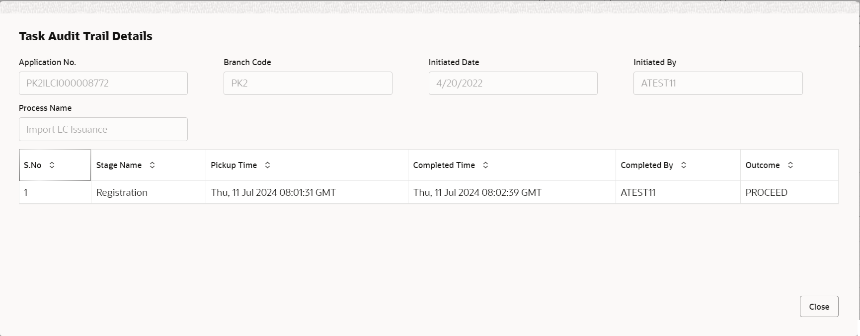

Description of the illustration audit.pngThis button provides information about user initiated the transaction, initiated date, stage wise detail etc.
For more information on audit, refer to the field description table below.Table 2-8 Audit - Field Description
Field Description Application No. This field displays the appliation number of the process. Branch Code This field displays the branch code. Initiated Date This field displays the date on which process is initiated. Initiated By This field displays the user ID of the user who had initiated the process. Process Name This field displays the name of the process which is initiated. S. No This field displays the serial number of the audit record. Stage Name This field displays the current stage of the process. Completed Time This field displays the time on which the audit of the current stage is completed. Completed By This field displays the user ID of the user who had completed the audit. Outcome This field displays the outcome of the audit. - Click Next.The task will move to next data segment. For more information refer Document Details

Field Description Clarification Details Clicking the button opens a detailed screen, user can see the clarification details in the window and the status will be ‘Clarification Requested’. Documents Upload the required documents. The user can view and input/view application details simultaneously.
When a user clicks on the uploaded document, Document window get opened and on clicking the view icon of the uploaded document, Application screen should get split into two. The one side of the document allows to view and on the other side allows to input/view the details in the application.
Remarks Specify any additional information regarding the Export LC Update Drawings. This information can be viewed by other users handling the request. Overrides Click to view the overrides accepted by the user. Customer Instruction Click to view/ input the following. - Standard Instructions – In this section, the system will populate the details of Standard Instructions maintained for the customer. User will not be able to edit this.
- Transaction Level Instructions – In this section, OBTFPMCS user can input any Customer Instructions received as part of transaction processing. This section will be enabled only for customer initiated transactions.
Common Group Messages Click Common Group Message button, to send MT759,790,91,92,95,96,98,799,999 messages from within the task. Incoming Message Displays the incoming message, if any. In case of MT798-MT726-MT759 request, user can view MT798 message(726-759) in this placeholder in Header of the task.
In case of MT798_MT788-MT799 request, user can view MT798 message (788-799) in this placeholder in Header of the process-task.
View LC Click to view the latest LC values displayed in the respective fields. All fields displayed in LC details section are read only fields.. Signatures Click the Signature button to verify the signature of the customer/ bank if required. The user can view the Customer Number and Name of the signatory, Signature image and the applicable operation instructions if any available in the back-office system.
If more than one signature is required, system should display all the signatures.
Request Clarification User should be able to submit the request for clarification to the “Trade Finance Portal” User for the transactions initiated offline. Reject On click of Reject, user must select a Reject Reason from a list displayed by the system. Reject Codes are:
- R1- Documents missing
- R2- Signature Missing
- R3- Input Error
- R4- Insufficient Balance/Limits
- R5 - Others
Select a Reject code and give a Reject Description.
This reject reason will be available in the remarks window throughout the process.
Refer Select a Refer Reason from the values displayed by the system. Refer Codes are:
- R3- Input Error
- R5 - Others
Hold The details provided will be saved and status will be on hold. User must update the remarks on the reason for holding the task. This option is used, if there are any pending information yet to be received from applicant.
Cancel Cancels the Export LC Update Drawings task. Details entered will not be saved and the task will be removed Save & Close Save the information provided and holds the task in ‘My Task’ queue for working later. This option will not submit the request.
Next On click of Next, system validates if all the mandatory fields have been captured. Necessary error and override messages to be displayed. On successful validation, system moves the task to the next data segment. Checklist Click to view the list of items that needs to be completed and acknowledge. If mandatory checklist items are not selected, system will display an error on submit.
Parent topic: Scrutiny
