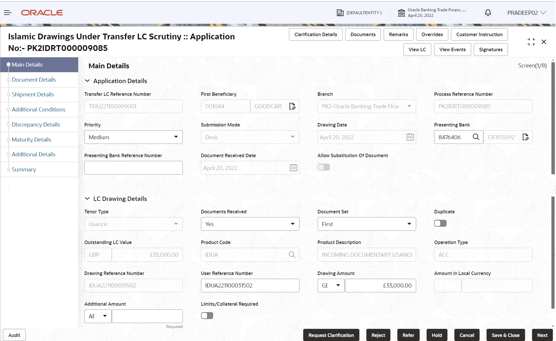

Application Details
This section provides a quick snapshot of details of LC.  This section is collapsible.
  1. On Scrutiny - Main Details screen, specify the fields that were not entered at Registration stage.
    The fields which are marked as Required are mandatory.
    Table 2-6 Scrutiny - Main Details - Field Description
    Field Description
    Transfer LC Reference Number Read only field.
    System displays the LC Reference Number to be transferred as selected in the Registration stage.
    First Beneficiary Read only field.
    System displays the First Beneficiary details.
    Branch Read only field.
    System displays the branch details.
    Process Reference Number Read only field.
    Unique sequence number for the transaction.
    This is auto generated by the system based on process name and branch code.
    Priority System will populate the priority of the customer based on priority maintenance. If priority is not maintained for the customer, system will populate 'Medium' as the default priority.
    User can change the priority populated.
    Submission Mode Read only field.
    System displays the selected submission mode.
    Drawing Date Read only field.
    System displays the branch’s current date.
    Presenting Bank System displays the Presenting Bank name and address as per presenting bank ID selected.
    The usser can change the presneting bank.
    Presenting Bank Reference Number Specify the presenting bank reference number.
    Document Received Date Read only field.
    Allow Substitution Of Document Read only field.
    If enabled, allows the bank to substitute the Export Documents received from Transferee with the documents from Beneficiary during Drawing.

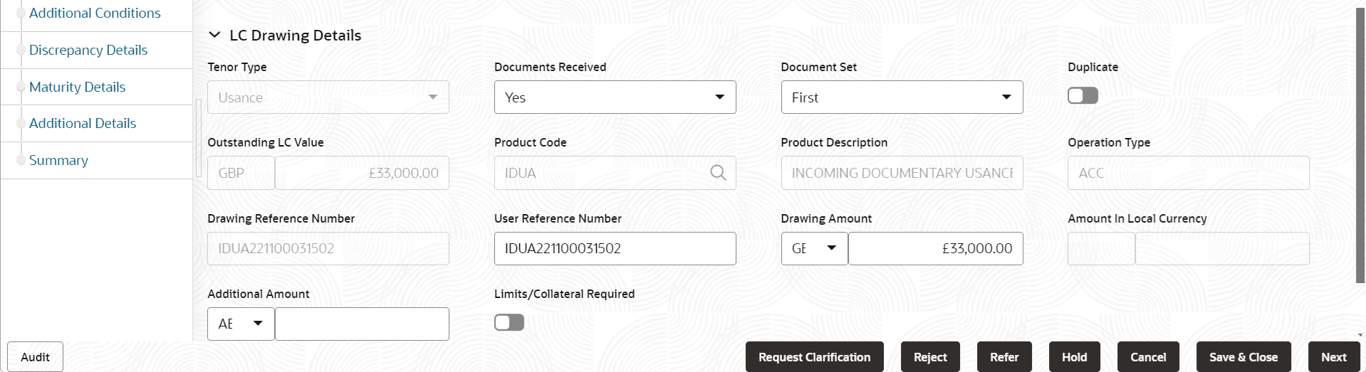

    LC Drawing Details
    The fields listed under this section are same as the fields listed under the LC Drawing Details section in Registration stage. During Registration, if user has not captured input, then user can capture the details in this section.
    Provide the details for the fields based on the description in the following table:
    Table 2-7 LC Drawing Details
    Field Description
    Tenor Type Select the tenor type.
    • Sight
    • Usance
    • Multi Tenor
    Documents Received Select the document received status from the drop-down.
    • Yes
    • No
    Documents Set Select the number of sets of documents received from the drop-down.
    • First
    • Second
    • Both
    Duplicate If documents received are duplicate and if the drawing is already completed, user can mark this as duplicate and submit.
    Outstanding LC Value Read only field.
    This field displays the value as per the latest LC details.
    Product Code Select the product code for the drawing.
    Only the products that are allowed for Bills under Transfer LC should be displayed in the look up list.
    Product Description Read only field.
    This field displays the description of the product as per the product code.
    Operation Type Read only field.
    The operation type can be:
    • ACC
    • DIS
    • undefined
    Drawing Reference Number This is auto generated by the back end system.
    User Reference Number User reference number is defaulted based on the selected LC.
    User can change the value.
    Drawing Amount Outstanding LC Amount as per the latest LC details is displayed.
    Amount In Local Currency Read only field.
    System fetches the local currency equivalent value for the LC amount from back office (with decimal places).
    Additional Amount This field can have value only if an MT 750 has been processed for this drawing earlier.
    Limits/ Collateral Required Enable the option, if limit check is applicable.
    Disable the option, if limit check is not applicable.

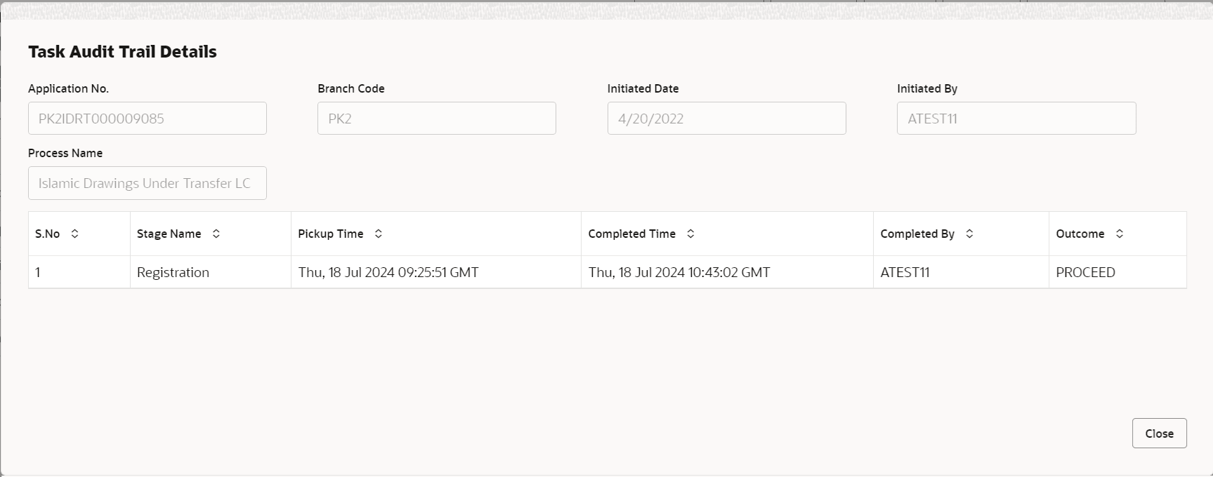

    Audit
    This button provides information about user initiated the transaction, initiated date, stage wise detail etc.
    For more information on action buttons, refer to the field description table below.
    Table 2-8 Audit - Field Description
    Field Description
    Application No. This field displays the appliation number of the process.
    Branch Code This field displays the branch code.
    Initiated Date This field displays the date on which process is initiated.
    Initiated By This field displays the user ID of the user who had initiated the process.
    Process Name This field displays the name of the process which is initiated.
    S. No This field displays the serial number of the audit record.
    Stage Name This field displays the current stage of the process.
    Completed Time This field displays the time on which the audit of the current stage is completed.
    Completed By This field displays the user ID of the user who had completed the audit.
    Outcome This field displays the outcome of the audit.
