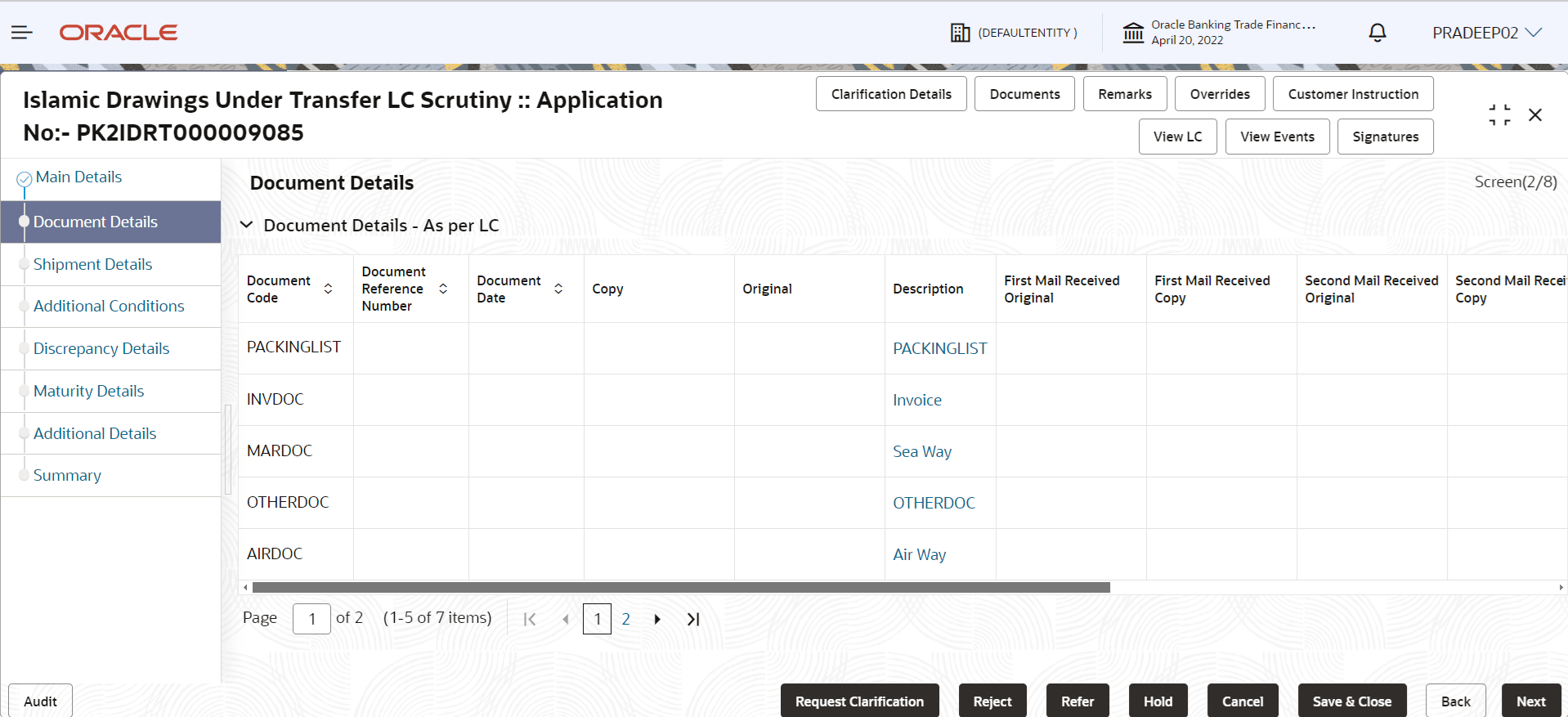

2.3.2 Document Details
This topic provides the systematic instructions to capture the details of the documents received.
As part of Data Enrichment user verifies and enter the basic document details for Islamic Drawing Under Transferred LC.
  1. On Document Details screen, specify the fields.
    Figure 2-9 Scrutiny - Document Details
    Description of scrutinydocumentdetails.png follows
    For more information on fields, refer to the field description table below.
    Table 2-10 Document Details - Field Description
    Field Description
    Document Details - As per LC This table will fetches the document details as maintained in the underlying LC in the back office system.
    User can modify the details only which are fetched from underlying LC. User can not add or delete any document details.
    Once bill drawing is authorized and if update drawing is processed, details of this table will be fetched from underlying bill drawing.
