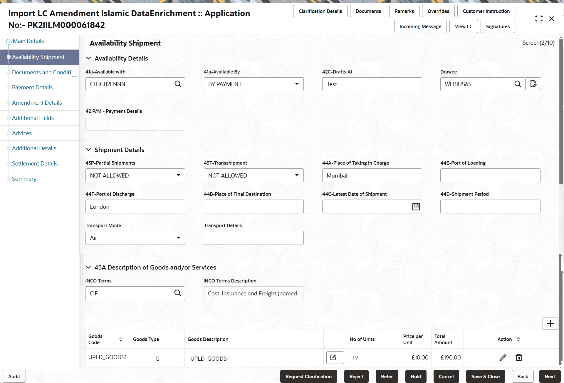

2.3.2 Availability Shipment
This topic provides the systematic instructions to capture the availability details.
Scrutiny user can scrutinize the Availability, Shipment and Goods details of an Import LC request for the different fields under the respective data segments.
  1. On Availability Shipment screen, specify the fields.
    Figure 2-11 Availability Shipment
    For more information on fields, refer to below field description table.

    Availability Details
    Available with Click Search to search and select the bank with which the credit is available.
    This field identifies the bank with which the credit is available of the issued LC.
    • If the LC is restricted to any particular bank, search the bank with SWIFT code (BIC) or Bank Name.
    On selection of the record if SWIFT code is available, then SWIFT code will be defaulted. If SWIFT code is not available then the bank's name and address gets defaulted.
    • If the LC is not restricted to any bank, provide free text - (YOURSELVES, WITH ANY BANK etc.).

    Latest Date Of Shipment This field displays the value of Latest Date of Shipment as per the issued LC and can be amended if required.
    Select the latest date for loading on board/dispatch/taking in charge as per the issued LC.
    This field is alternate to Shipment Period. Latest date of shipment or shipment period must have value and if both the fields has values, application will display an error message.

    Description of Goods and/or Services
    This field contains a description of the goods and/or services of the issued LC and can be amended if required. Provide the Shipment Details based on the description in the following table:
    INCO Terms Click Search to search and select the INCO terms from the document received.
    INCO Terms Description System displays the description of the INCO term.
    The user can click + to add multiple descrption of goods and services.
    Goods Code Click Search to search and select the goods code. Once you select goods code, value will default in Goods Type and Goods Description.
    Goods Type This field displays the goods type depending on selected goods code.
    Goods Description This field displays the description of goods based on goods code.
    No of Units Specify the number of units being imported or exported.
    Price per Unit Specify the value for price per unit.
    Total Amount System calculates the total price. In case of online request, the system should populate the total amount from incoming request. System validates that the total amount is equal to the value of the transaction (LC/Collection).
    Action Click Edit icon to edit the goods code.
    Click Delete icon to delete the goods code.
  2. Click Next.
    The task will move to next data segment.
