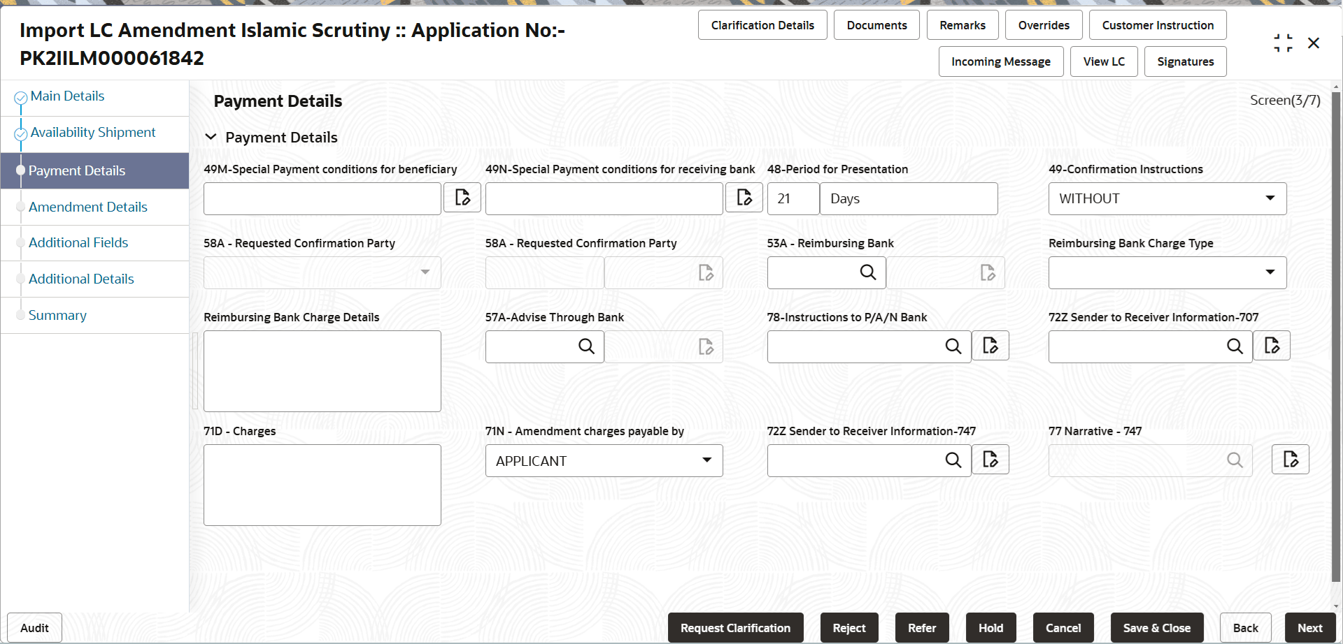

2.3.3 Payment Details
This topic provides the systematic instructions to initiate the payment scrutiny stage of import LC amendment request.
A Scrutiny user, can enter the Payment data segment details of an Islamic Import LC Amendment.
  1. On Scrutiny - Payment screen, specify the fields.
    For more information on fields, refer to the field description table below.
    Table 2-12 Payment Details - Field Description
    Field Description
    Payment Details
    Special Payment conditions for beneficiary
    This field displays the value of special payment condition -
    beneficiary as per the issued LC and can be amended if required.
    If any special payment condition has to be provided to beneficiary, the details for the same must be captured in this field.
    Special Payment conditions for receiving bank This field displays the value of special payment condition - receiving bank as per the issued LC and can be amended if required.
    If any special payment condition has to be provided to receiving bank, the details for the same must be captured in this field. This field specifies special payment conditions applicable to the receiving bank without disclosure to the beneficiary, for example, post-financing request/ conditions for receiving bank only.
    Period for Presentation
    This field displays the value of Period for Presentation as per the issued LC and can be amended if required.
    If the period of presentation is based on any event other than shipment, then you can capture the event name in text along with the number of days in number.
    Confirmation Instructions
    This field displays the value of Confirmation Instructions as per the issued LC and can be amended if required.
    Select the confirmation instruction for the LC from the list. The options are:
    • CONFIRM
    • MAY ADD
    • WITHOUT
    Requested Confirmation Party This field displays the value of Requested Confirmation Party as per the issued LC and can be amended if required.
    Requested Confirmation Party If the Requested Confirmation Party has the value as Others then click Search icon and select the appropriate requested confirmation party, in case of online and non-online channels.
    This field is enabled if the Confirmation Instructions is CONFIRM or MAY ADD and Requested Confirmation Party is Others.
    Reimbursing Bank Click Search to search and select the reimbursing bank. Party type with banks will be displayed in look-up.
    • SWIFT code (if available)
    • Name and address of the bank
    On selection of the record if SWIFT code is available, then SWIFT code will be defaulted. If SWIFT code is not available then the bank's name and address to be defaulted.
    In case the selected Bank is not RMA Compliant, the system prompts the user to use a different advising bank or use non SWIFT Media to transmit the LC and displays error message “RMA arrangement not available, please change the bank or use MAIL Medium”.
    This field indicates the value of Reimbursing Bank as per the issued LC and can be amended if required.
    Reimbursing Bank Charge Type Select the reimbursing bank charge type.
    The options are:
    • Claimants - Select this option, if the charges are to be claimed from Beneficiary
    • Ours - Select this option, if the charges are to be borne by Applicant
    This field should be enabled only if Reimbursing Bank field has value.
    Reimbursing Bank Charge Details Specify the reimbursing bank charge details.
    Advise Through Bank This field displays the value of advising through bank in case of online channel and can be amended if required.
    Click Search to search and select the advise through bank, in case of Non - Online channel.
    Instructions to P/A/N Bank This field displays the value of Instructions to P/A/N Bank as per the issued LC and can be amended if required.
    Click Search to search and select the instructions to P/A/N Bank, in case of Non - Online channel.
    Sender to Receiver Information-707 This field displays the value of Sender to Receiver Information (FFT Details) as per the issued LC and can be amended if required
    Click Search to search and select thesender to receiver information, in case of Non - Online channel.
    Charges Charge Description as maintained in FFT will be available. User can modify the description.
    Specify the charges details(FFT), in case of non-online channel.
    Amendment Charges Payable by This field specifies the party who bear the amendment charges.
    Select the value for Amendment Charges Payable by. The options are:
    • APPLICANT
    • BENEFICIARY
    • OTHERS
    Narrative Specify the narrative.
    Sender to Receiver Information - MT747 Select the FFT maintained for MT740 and change the description if required.
    Narrative - MT747 Select the FFT maintained for Narrative- MT747 and change the description if required, if Reimbursement bank field has value.
    Instructions to P/A/N Bank Click Search icon and select the instructions to P/A/N Bank, as per the issued LC and can be amended if required.
    Sender to Receiver Information Click Search icon and select the sender to receiver information, as per the issued LC and can be amended if required.
  2. Click Next.
    The task will move to next data segment.
