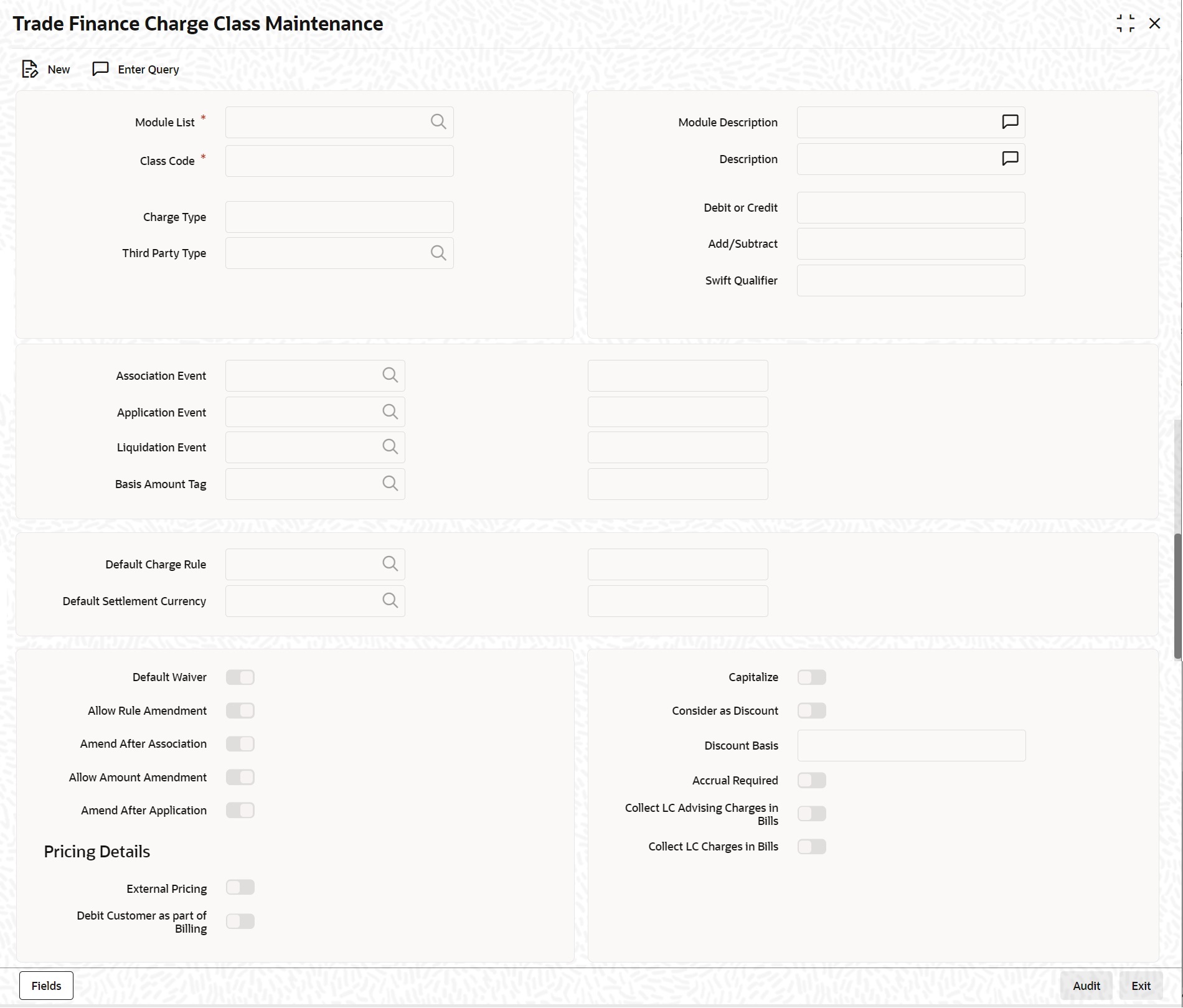

- On the Homepage, type ‘CFDTFCCM’ in the text box, and click the next arrow.The ‘Trade Finance Charge Class Maintenance’ screen is displayed.
- On Trade Finance Charge Class Maintenance screen, specify the fields.For more information on fields, refer to Table 2-2:
