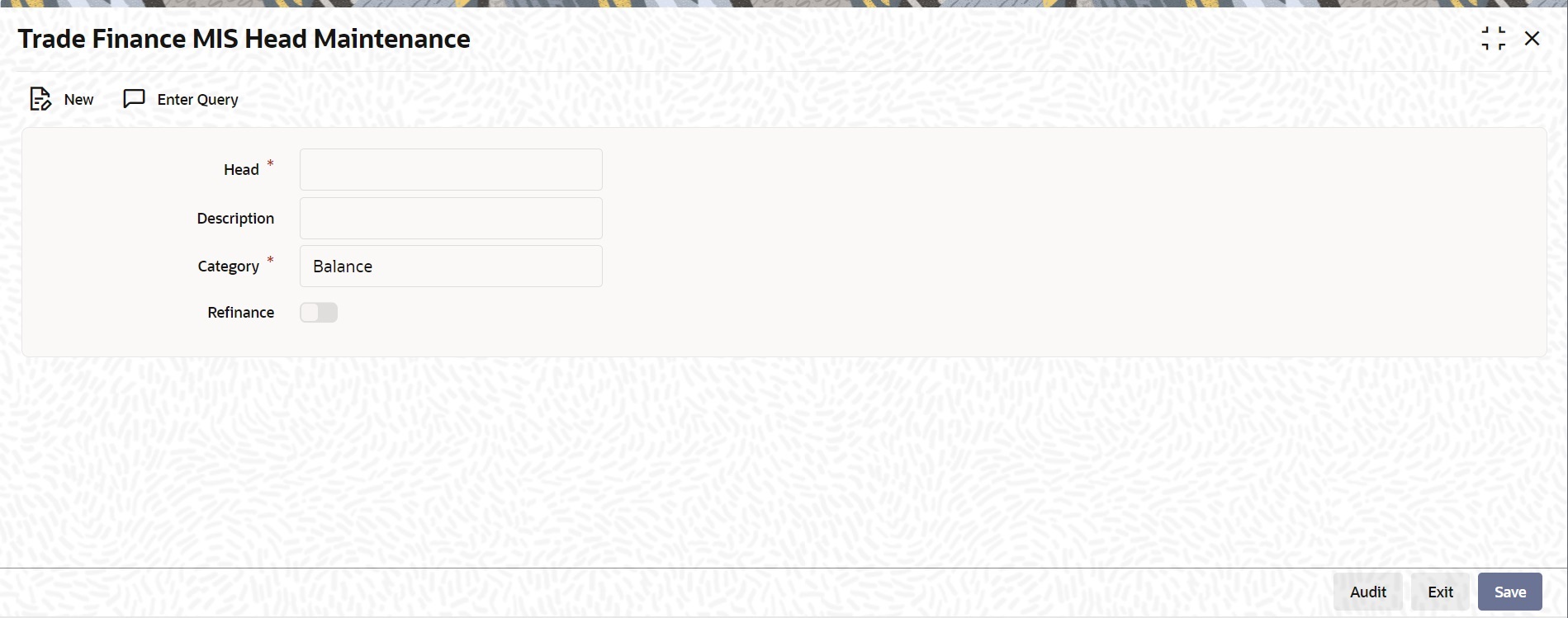

  1. On Homescreen, specify MIDTFHED in the text box, and click next arrow.
    Trade Finance MIS Head Maintenance screen is displayed.
    Figure 1-16 Trade Finance MIS Head Maintenance
    Description of Figure 1-16 follows
    Description of "Figure 1-16 Trade Finance MIS Head Maintenance"
  2. On Trade Finance MIS Head Maintenance screen, specify the fields. If you are calling an MIS Head that has already been defined, double-click an MIS Head from the summary screen.

    Table 1-17 Trade Finance MIS Head Maintenance
    Field Description
    Head Specify the fields. The field is mandatory.
    Description Specify the description.
    Category The field is Mandatory.
    The MIS Head Category classification indicates the method in which the accounting entry will be reported in the profitability report. It could be one of the following:
    • Balance
    • Income
    • Expense
    • Contingent
    Balance
    Indicates that the accounting entry should be considered for calculating the Cumulative Average Balance. Typically, an asset entry would be classified under the balance type MIS Head. The GL entry leg of a loan disbursement transaction, would typically be classified under a Balance type of MIS Head.
    Income
    Indicates that the accounting entry should be considered as an income for the purpose of profitability reporting. Clearly, any interest or charge income would be classified under an Income type of MIS Head.
    Expense
    Indicates that the accounting entry should be considered as an expense for the purpose of profitability reporting. Any interest, or tax expense would be classified under an expense type of MIS Head.
    Contingent
    Indicates that the accounting entry should be considered as a contingent entry for the purpose of profitability reporting. The issue of an import Letter of Credit, etc., are examples of contingent type of entries. You can generate a report that gives the balances due to such contingent type of entries. Under each type of MIS Head, you may define additional MIS Heads, as per your reporting requirement. For example, you can have an MIS Head for each loan product, so that you can have the cumulative average balance due to all the loans disbursed under the product.
