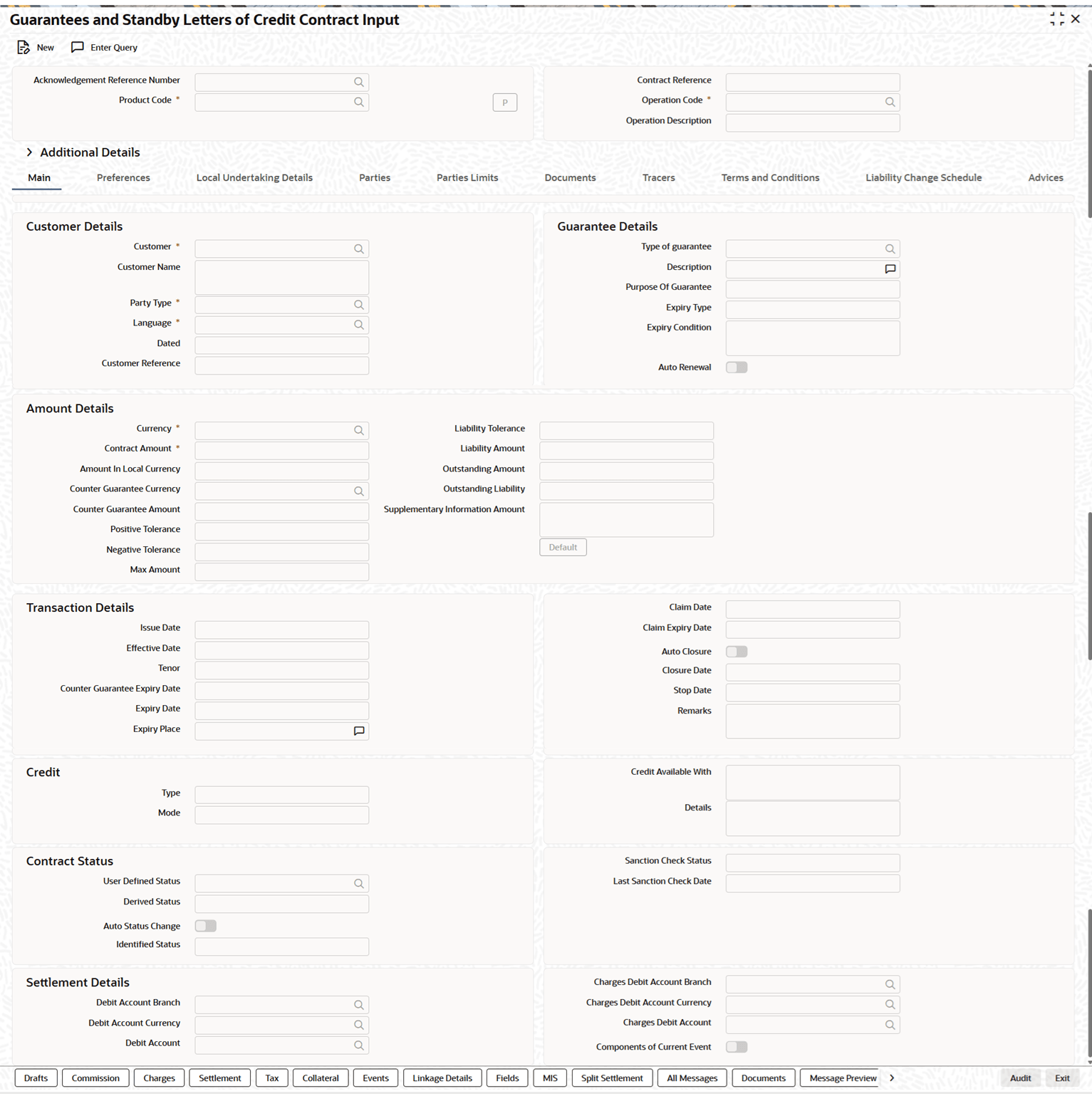

  3. Specify the field details in the Main tab.
    For more information on the fields, refer the Field Description table given below.
    Table 9-2 Main - Field Description
    Field Description
    Customer Details Specify the Customer Details.
    Customer Specify the customer for which you need to maintain or select the customer from the option list. The list displays all valid customer numbers.
    BIC Code appears next to the Customer only if the BIC code is mapped with that customer number. If the BIC Code is not mapped with that customer number, then the BIC Code will not appear next to the Customer in the option list.
    This field is mandatory.
    Customer Name The system displays the customer name.
    Party Type Specify the party type of the customer who is the counter party of the Guarantee/SBLC. Alternatively, you can select the party type from the option list. The list displays all the valid party types maintained in the system.
    During amendment, add a new party type REB and save the amendment.
    On Amendment initiation (AMNV) MT767 will be generated.
    On confirmation, advices of Guarantee and StandbyLC contract input screen (LCDGUONL) should list the message MT740. On confirmation authorization, MT740 should be processed and generated.
    During amendment confirmation of SBLC contract for which REB already exists and the REB party id has been amendment in this amendment, on confirmation advices of LCDGUONL should list the messages MT740 and MT747 along with the amendment message, and those will be processed and generated on authorization. MT740 will be generated with new party id as receiver and MT747 will be generated with old party id as a receiver.
    During amendment confirmation of SBLC contract for which REB is deleted, on confirmation advices of LCDGUONL should list the messages MT747 along with MT767 message and those will be processed and generated on authorization. MT740 should be automatically suppressed.
    LIB will be a party in Counter Guarantee if purpose of guarantee to be request.
    Counter Guarantee Issuing Bank will be captured as APB if purpose of guarantee is selected as Issue.
    Language Specify the language to be used for Guarantees/SBLC. You can select the language from the option list. The list displays all valid language codes.
    Dated Enter the date of the customer reference. This would normally be the date on which you have a correspondence from the party regarding the Guarantees/SBLC.
    This field is optional.
    Customer Reference Specify the customer reference number.
    Guarantee Details Specify the Guarantee Details.
    Type of guarantee Select the guarantee type from the option list. This is maintained using static type maintenance screen.
    Description The system displays the guarantee description based on the type of guarantee you select.
    Purpose of Guarantee If the LC that you are processing is a guarantee you should specify the purpose of guarantee. Click the drop-down list and select one of the following values:
    • Issue
    • Request
    Expiry Type Select the type of validity from the list provided. The list is as follows:
    • Fixed
    • Open
    • Conditional - With Expiry
    • Conditional - Without Expiry
    Expiry Condition Specify the details for conditional guarantee.
    Auto Renewal This flag specifies if the Open ended guarantee is to be auto renewed on EOD.
    Amount Details Specify the Amount Details:
    Currency Specify the currency of the transaction. Alternatively, you can select the currency from the option list. The list displays all valid currencies maintained in the system.
    Contract Amount Specify the amount for which the Guarantee and SBLC is drawn.
    Amount in Local Currency When FCY amount is given in 'Contract Amount' field for Guarantee, system converts in local currency and respective value is displayed in this screen. This field is mandatory for FCY contracts
    Counter Guarantee Currency Select the currency of the counter guarantee from the list of values. Ensure that it matches the Local Guarantee Currency.
    This field is mandatory, if the counterparty type is APB (Applicant Bank).
    Counter Guarantee Amount Specify the amount of the counter guarantee. Ensure that it matches the Local Guarantee Amount.
    This field is mandatory, if the counterparty type is APB.
    Positive Tolerance It indicates the increment, expressed as a percentage that must be made to the amount of a letter of credit, to arrive at the Maximum LC Amount.
    Negative Tolerance It indicates the reduction, expressed as a percentage that must be made to the amount of a letter of credit, to arrive at the Minimum LC Amount.
    Max Amount Maximum contract amount will be defaulted. This is the sum of contract amount and (%(tolerant) of contract amount).
    Liability Tolerance The liability percentage is used to track the maximum LC amount against a given percentage. A bank would like to limit its exposure to a new or existing customer as LC is a commitment given by the bank. Although the bank sanctions an LC limit (maximum LC amount which includes tolerance) to a customer it may like to specify a percentage over and above this limit. This will result in the customer being shown to be liable or tracked for a higher amount. Specifying a liability percentage is from the perspective of risk management and provides cushion to the bank.
    Liability Amount Based on the value you specify in Revolves In field, the LC Liability Amount will be computed and displayed.
    Outstanding Amount The balance amount available after the availment of Guarantee/SBLC is displayed here.
    Outstanding Liability The system displays the liability amount.
    Supplementary Information Amount This field specifies the supplementary information about amount related to the undertaking.
    Default Click the Default button.
    The following details will be defaulted:
    Issue Date will be defaulted to application date and Effective Date will be defaulted to issue date. If you accept the overrides, you can modify the defaulted details.
    The tenor for Open ended/Conditional Without Expiry Guarantees/Standby LCs will default with 3 years and Open ended/Conditional Without Expiry counter guarantees with 3 years 30 days and
    corresponding local guarantee with 3 years. For Open ended guarantee under URDG Applicable rule, the defaulted expiry date cannot be modified. In other cases, if you accept the overrides, you can modify the defaulted details.
    The system displays Liability Amount, Max Amount, Tenor, Expiry Date, Claim Expiry Date, Closure Date, Stop Date by default. .
    Transaction Details Specify the transaction details:
    Issue Date Specify the issue date using the calendar icon.
    Effective Date Specify the effective date using the calendar.
    Tenor Specify the tenor of the contract.
    Counter Guarantee Expiry Date Specify the expiry date of the counter guarantee. Ensure that the date specified is later than the Local Guarantee Expiry Date.
    Expiry Date Specify the date on which the Guarantee/SBLC contract expires from the calendar.
    Expiry Place Specify the expiry place in the text box and click Ok.
    The typed text is displayed against the expiry place.
    Claim Date Select the claim date from the calendar. Claim date indicates the date by which all claims needs to be lodged for the guarantee. Claim Date should be on or before Claim Expiry Date.
    Claim Expiry Date
    Select the claim expiry date from the calendar. Claim expiry date indicates the date by which all claims lodged need to be settled. Claim Expiry Date = Expiry Date + Claim Days.
    System defaults Claim Expiry date as Expiry Date + Claim Days on Product default. If Claim Days is zero, Claim Expiry date will be Expiry Date. Claim Expiry Date can be modified. On Save, system will validate the following:
    • Claim Expiry Date cannot be before Claim Date
    • Claim Expiry Date can be on or after Guarantee Expiry Date
    • Claim Expiry Date should not be after Closure Date
    The Commission is computed till Claim Expiry Date. During Guarantee Issuance Claim Expiry Date is considered to validate Limit Line expiry date.
    Auto Closure Check this option to indicate that the Guarantee/SBLC should be automatically closed.
    Closure Date The date of closure is based on the Closure Days maintained for the product involved in the Guarantees/SBLC. The number of days specified as the Closure Days is calculated from the expiry date of the Guarantee/SBLC, to arrive at the Closure Date.
    Closure Date = Expiry Date + Closure Days
    Stop Date This date will be defaulted to Claim Expiry date. Stop date cannot be earlier than Issue date and later than claim expiry date. Stop date will default from the main tab to commission sub system.
    Remarks Specify remarks, if any.
    Credit Specify the credit details:
    Type Select the type from the drop-down list. The available option are
    • Straight
    • Negotiable
    Mode Select the mode from the drop-down list. The available option are
    • Sight Payment
    • Acceptance
    • Deferred Payment
    • Mixed Payment
    • Negotiable
    Credit Available With Specify the credit available with in the text box and click Ok.
    The typed text is displayed against the Credit Available With field.
    Details Specify the details in the text box and click Ok.
    The typed text is displayed against the details field.
    Contract Status Specify the Contract Status details.
    User Defined Status Specify the status of the Guarantee/SBLC contract. The option list displays all valid statuses that are applicable. Choose the appropriate one.
    Derived Status The system displays the derived status of the Guarantee/SBLC contract. You cannot modify this.
    Auto Status Change The system defaults the status of the check box based on the product maintenance. However, you can modify this. If you check this box, the system picks up the contract during EOD operations for status processing. If you do not check this, the system will not consider the Guarantee/SBLC contract for automatic status processing.
    Sanction Check Status The system displays the sanction check status. The statuses can be any of following:
    • P- Pending
    • X- Pending
    • A-Approved
    • R- Rejected
    • N- Not Required
    Last Sanction Check Date The system displays the last sanction check date.
    Settlement Details Specify the Settlement Details.
    Debit Account Branch Specify the debit account branch. Select the debit account branch from the option list. The list displays all valid values.
    Debit Account Currency Specify the debit account currency. Select the currency from the option list. The list displays all valid values.
    Debit Account Specify the debit account. Select debit account from the option list. The list display all valid values.
    Charges Debit Account Branch Specify the charges debit account branch. Select the charges debit account branch from the option list. The list displays all valid values.
    Charges Debit Account Currency Specify charges debit account currency. Select charges debit account currency from the option list. The list displays all valid values.
    Charges Debit Account Specify the charges debit account. Select charges debit account from the option list. The list displays all valid values.
    Components of Current Event System enhanced to show the amount tags pertaining to the current event in settlement screen for LC contracts.
    • During settlement pickup of LC contract input screen, current value of components of current event on contract input screen is considered to show the amount tags in ‘Settlements’ screen.
    • If the flag is checked at contract input screen, the amount tags pertaining only to the current event will be available in settlement screen with ‘Current event’ checked.
    If the flag at contract input screen is unchecked, the amount tags of all the events will be available in ‘Settlements’ screen with current event flag checked for those amount tags of current event and unchecked for those amount tags not pertaining to current event. This field is optional. By default the field will be unchecked.

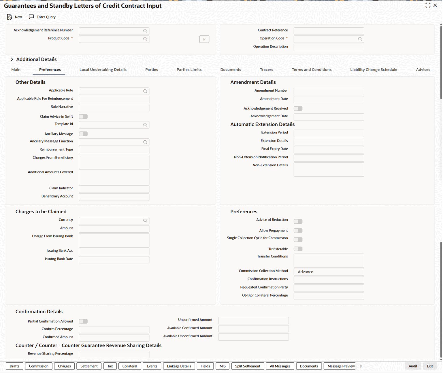

    The preferences details is displayed. For more information on the fields, refer to the Field Description table given below:
    Table 9-3 Preferences
    Field Description
    Other Details Specify the Other Details.
    Applicable Rule The system defaults the applicable rule for the product type. However, you can modify this.
    Please refer to the section Specifying the Applicable Rules under topic Defining Product Attributes in this user manual.
    Applicable Rule For Reimbursement
    Select the applicable rule for reimbursement from the drop-down list.
    The available options are
    • URR Latest Version
    • Not URR
    Reimbursement Type
    Select the reimbursement type from the drop-down list.
    • Ours
    • Claimants
    Rule Narrative
    This is enabled only if Applicable Rule is set to OTHR. It is mandatory to specify the rule narrative if the applicable rule is OTHR.
    Claim Advice in Swift
    Check this box to generate the charge claim advice in MT799 SWIFT format.
    Template Id
    Specify the template ID related to MT799 message types from the option list.
    Ancillary Message
    Check this box to generate MT 759 on contract authorization.
    Ancillary Message Function
    Specify the ancillary message function. Select the ancillary message from the option list. The list displays all valid options maintained in the
    system. Ancillary Message Function is mandatory if Ancillary Message is checked.
    Reimbursement Type Select the Reimbursement Type from the drop-down list. The available options are
    • Ours
    • Claimants
    Charges From Beneficiary
    Specify the charge amount borne by the beneficiary.
    Additional Amounts Covered
    Specify the additional amount covered.
    Claim Indicator Select the indicator for claim from the drop-down list. The list displays the following options:
    • Multiple demands not permitted
    • Multiple and partial demands not permitted
    • Partial demands not permitted
    Beneficiary Account
    Specify the account details of beneficiary.
    This field is read only.
    Amendment Details Provide the Amendment Details.
    Amendment Number
    The system displays the amendment number.
    Amendment Date
    Specify the amendment date from the calendar icon.
    Acknowledgement Received
    Check this box to indicate that the acknowledgment has received.
    Acknowledgement Date
    Specify the date on which the acknowledgement is received.
    Automatic Extension Details
    Extension Period Select the extension period. You can select one of the following options:
    • Days
    • One Year
    • Others
    Extension Details
    Specify the extension details. Extension Details is mandatory when Period is Days/Others.
    Final Expiry Date
    Select the final expiry date for automatic extension from the calendar. This date indicates the final expiry date after which undertaking will no longer be subject to automatic extension.
    Non-Extension Notification Period
    Specify the non-extension notification period. Notification Period will be minimum number of calendar days prior to the current expiry date. This indicates period by which notice of non-extension must be sent.
    Non-Extension Details
    Specify the non-extension details. Non-extension details are applicable only when notification period is provided.
    Charges to be Claimed
    Specify the charges to be claimed.
    Currency
    Specify the currency in which the charges attributed to the issuing bank is expressed.
    Amount
    Specify the charge amount.
    Charge From Issuing Bank
    Give a brief description of the charge.
    Issuing Bank Account
    Specify the account from which charge should be collected.
    Issuing Bank Date
    Specify the date of charge collection.
    Preferences Specify preferences details:
    Advice of Reduction
    The system displays the value for Advice of Reduction (MT 769) message.
    Allow Prepayment
    Check this option to indicate that the customer can make a prepayment on the contract.
    Single Collection Cycle for Commission
    When the flag is selected, on contract amount increase amendment, commission is collected till issuance commission good until date. For the last period, commission is collected till expiry date on pro rate basis.
    If the amendment commission good until date falls after expiry date, expired period commission is collected on expiry date EOD and accrual entries are triggered, if maintained.
    During closure/cancel, if any remaining commission exists from the expiry date to actual good until date, gets collected for amendment commission.
    Transferable
    Check this box to indicate that the Guarantee/SBLC is transferable. Guarantee/SBLC can be transferred only if SWIFT 2019 is enabled.
    Transfer Conditions
    Specify the transfer conditions for the Guarantee/SBLC transfer.
    Commission Collection Method This field indicates when the commission components of an Letter of Credit is collected. Commission on an LC can be collected in the following ways:
    • Advance - Select Advance to indicate that the commission components of the Letter of Credit should be collected at the time the Letter of Credit is initiated.
    • Arrears - Select Arrears to indicate that the commission components of the Letter of Credit should be collected on the maturity date of the Letter of Credit.
    This field is defaulted from product maintenance. User can change it at contract level.
    Confirmation Instructions
    Select the confirmation instructions from the drop-down list. The available options are:
    • May Confirm
    • Confirm
    This option indicates that the SBLC can have an associated confirmation message. In Guarantee/SBLC if Confirmation Instruction option is checked. It cannot be amended to Uncheck.
    Requested Confirmation Party
    Select the confirmation party type. You can select one of the following messages:
    • Advising Bank
    • Advise Through Bank
    • Confirming Bank
    Obligor Collateral Percentage
    Specify the Obligor collateral percentage. If Obligor Collateral Percentage is provided, system will collect the collateral partially from Applicant and Obligor Party depending on the percentage provided. Else system will collect the entire collateral from Applicant.
    Revenue Sharing Percentage
    Specify the Revenue sharing percentage maintained at TF customer level for CO-BANK.
    Partial Confirmation Allowed
    Select Partial Confirmation Allowed check box to confirm the partial amount. The remaining amount can be confirmed after you receive the approval from the external agent.
    Confirm Percentage
    Specify the percentage of Contract Amount to be confirmed. If percentage is not specified, the system will calculate the percentage based on the confirm Amount specified.
    Confirmed Amount
    Specify the amount to be confirmed. If Confirm Amount is not specified, the system will calculate the confirmed amount based on the Confirm Percentage specified.
    If both Confirm Amount and Confirm Percent are specified then the system will display an override message as “Both Confirm Amount and Confirm Percent are entered. Confirm Percent is considered for calculation.”
    The system will calculate and display the Confirm Amount based on the confirm percentage specified. Confirm Percentage and Confirm Amount can be changed or recalculated either on save or on pressing Default Button available in Main tab of Guarantee Contract Online screen.
    The system will display an error message for the following conditions:
    • If Partial Confirmation Allowed check box is unchecked and if you specify the value Confirmation Percentage and Confirmation Amount fields.
    • If the value of the amount confirmed is greater than the unconfirmed unavailed amount.
    • If the value of the confirm amount is lower than the availed confirmed amount.
    • If Operation is confirm or advice and confirm and confirm percent is greater than 100 or confirm Amount is greater than Guarantee current availability.
    Unconfirmed Amount
    The system displays the current maximum unconfirmed Guarantee amount. This amount is derived by deducting the confirmed amount from the maximum Guarantee amount.
    Available Confirmed Amount
    The system displays the available confirmed portion of the maximum Guarantee amount.
    Available Unconfirmed Amount
    The system displays the available unconfirmed portion of the maximum Guarantee amount.

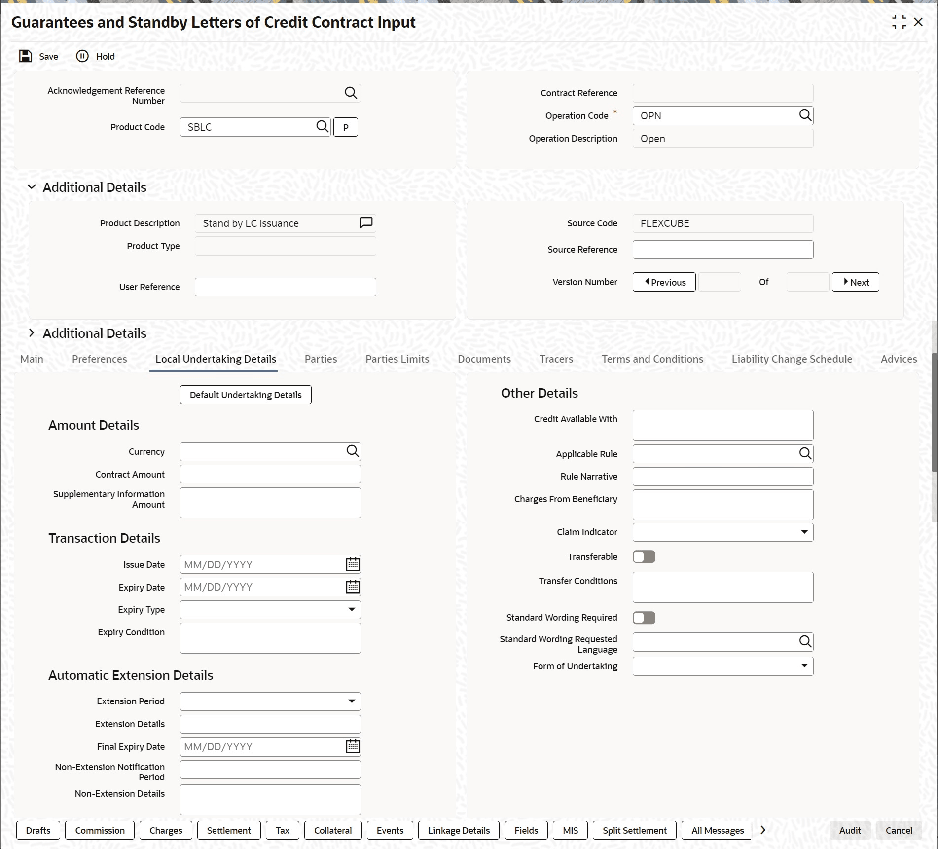

  5. On the Guarantees and Standby Letters of Credit Contract Input screen, click the Local Undertaking Details tab.
    The Local Undertaking Details screen is displayed.
    Figure 9-3 Local Undertaking Details
    For more information on the fields, refer the Field Description table given below:
    Table 9-4 Local Undertaking Details - Field Description
    Field Description
    Currency Select the local undertaking currency from the list.
    Contract Amount Specify the local undertaking contract amount.
    Default Undertaking Details The system will provide an override message and the local undertaking details will be defaulted. On accepting the override, you can modify the defaulted details.
    Issue Date Specify the issue date from the calendar.
    Expiry Date Specify the expiry date from the calendar icon.
    Expiry Type Select the Expiry Type from the drop-down list.
    • Fixed
    • Open
    Expiry Condition Specify the expiry condition and click Ok.
    You can provide expiry condition details if the expiry type is selected as ‘conditional’. If Expiry Type is ‘Fixed’ or ‘Open’ then Expiry Condition is NULL.
    Other Details Specify the other details:
    Specify the Credit Available with details for local SBLC and click Ok.
    Applicable Rule
    Select the applicable rule for local undertaking from the list of values.
    Rule Narrative
    This is enabled only if ‘Applicable Rule’ is set to ‘OTHR’. It is mandatory to specify the rule narrative if the applicable rule is ‘OTHR’.
    Specify the charges from Beneficiary for Local Undertaking and click Ok.
    Claim Indicator
    Select the claim indicator for local undertaking. The available options are:
    • Multiple demands not permitted.
    • Multiple and partial demands not permitted.
    • Partial demands not permitted.
    Transferable Select this check box to indicate the Local Undertaking is transferable.
    Transfer Conditions Specify the transfer conditions:
    Standard Wording Required Check this option to indicate that the customer needs standard wording for local undertaking details.
    Standard Wording Requested Language Specify the language in which the standard wording is requested. Alternatively, you can select the standard wording requested language from the list.
    Automatic Extension Details Specify the automatic extension related details for local undertaking.
    Extension Period
    Select the extension period from the drop-down list.
    • Days
    • One Year
    • Others
    Extension Details The extension details is mandatory when extension period is selected as Days/Others.
    The Extension Details should be a positive number from 1 to 999 when Extension Period is Days.
    Specify the non-extension details and click Ok.. Non-extension details are applicable only when notification period is provided.
    Select the Notification Period for non-extension of Local Undertaking.
    Final Expiry Date Select the Final Expiry Date for Automatic Extension.
    The Final Expiry Date should be greater than Local Guarantee Expiry Date. If the final expiry date is not greater than local guarantee then the system will display an override and default it to Local Guarantee Expiry Date.

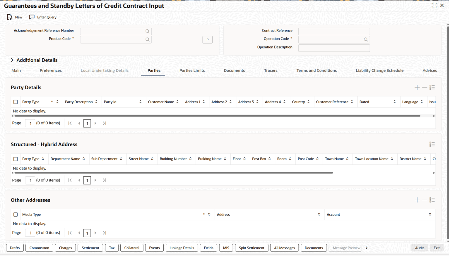

  6. On the Guarantees and Standby Letters of Credit Contract Input screen, click the Parties tab.
    The Parties Details is displayed. For more information on fields, refer the Field Description table given below:
    Table 9-5 Parties - Field Description
    Field Description
    Party Type
    Specify the party type. Select the party type from the option list. The list displays all the valid party types maintained in the system.
    Party Description
    The system displays the party description.
    Party Id Specify the Party ID for which you need to maintain. Select the Customer No from the option list.
    BIC Code appears next to the Customer No only if the BIC code is mapped with that customer number. If the BIC Code is not mapped with that customer number, then the BIC Code will not appear next to the Customer No in the option list.
    Customer Name
    Specify the customer name.
    Address 1-4
    Specify the address of the customer.
    Country
    Specify the country code. Select country code from the option list. The list displays all valid values.
    Customer Reference
    Dated
    SBLC.
    Language
    Specify the language in which advices should be sent to the customer.
    Issuer
    Check this option to indicate that the issuer is a bank.
    Structured Payment Address Specify the following payments releated details.
    Party Type Specify the Party Type of a customer.
    Department Name Specify the Department Name of a customer.
    Sub Department Specify the Sub Department of a customer.
    Street Name Specify the Street Name of a customer.
    Building Number Specify the Building Number of a customer.
    Building Name Specify the Building Name of a customer.
    Floor Specify the Floor of a customer.
    Post Box Specify the Post Box of a customer.
    Room Specify the Room number of a customer.
    Post Code Specify the Post Code of a customer.
    Town Name Specify the Town Name of a customer.
    Town Location Name Specify the Town Location Name of a customer.
    District Name Specify the District Name of a customer.
    Country Sub Division Specify the Country Sub Division of a customer.
    Country Specify the Country Code of a customer.
    Address Line1 Specify the Address of a customer.
    Address Line2 Specify the Address of a customer.
    Other Addresses Specify Other Addresses
    Media Type
    Specify the media type. Select the media type from the option list. The list displays all valid values.
    Address
    Specify the address of the party.
    Account
    The system defaults the account number. However, you can edit this field.
    The parties involved in a Guarantee/SBLC depend upon the type of guarantee/SBLC you are processing. The following table indicates the minimum number of parties required for the types of Guarantee/SBLC that you can process.
    For more information, refer Table 9-6.

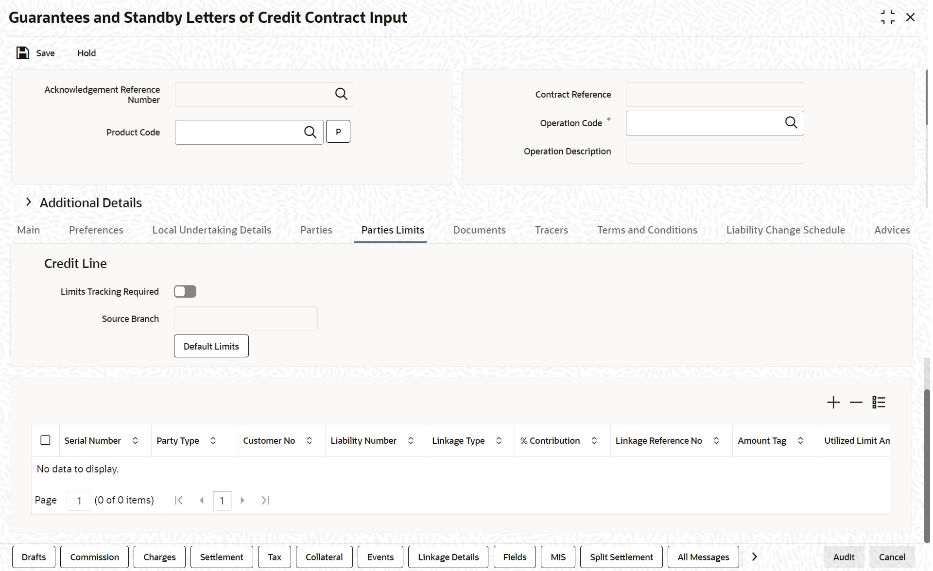

  7. On the Guarantees and Standby Letters of Credit Contract Input screen, click the Parties Limits tab.
    The Parties Limits details is displayed.
    You can add new records or delete defaulted records and then click the save button. The saved details is available in the system.
    Table 9-7 Parties involved in Guarantee/SBLC - Field Description
    Field Description
    Credit Line Specify the details.
    Limits Tracking Required Specify whether the credit granted under the LC you are processing should be tracked against the credit limit assigned to the customer under a Credit Line.
    Check this box to indicate that limit tracking is required for the Guarantee/SBLC.
    If left unchecked, the system will display an override message Limit tracking not done for the contract’ while saving the record. In the subsequent fields of this screen, you can specify details of the line under which the credit is to be tracked.
    Default Limits Click the Default Limits button.
    The system will default the following basic limit details.
    Serial Number On the Guarantees and Standby Letters of Credit Contract Input screen, click on the save button. The , serial number details is displayed.
    Party Type The system defaults the party type of the counter party of the contract.
    Customer No The system defaults the Customer Noor CIF Id of the counterparty.
    Liability Number Specify the Liability Number. The system displays multiple liabilities that are attached to the Customer.
    Linkage Type
    The system defaults the linkage type as Facility.
    The drop-down list has the following options:
    • Facility
    • Liability
    % Contribution
    Specify the proportion of limits to be tracked for the credit line.
    Linkage Reference No Specify the reference number that identifies the facility/liability. Linkage Reference No displays all valid facilities and liabilities for the specific liability number. Choose the appropriate one.
    Amount Tag
    The system defaults the Amount Tag.as Liability Amount.
    The system tracks the limits for non joint venture customers based on the amount tag.
    Limit Amount When you click Default button, the system defaults the amount tracked for each credit line. The amount is derived based on the amount tag specified above.
    You can add more rows to the list of credit lines using add button. Similarly, you can remove a selected row from the list using delete button. This field is optional.
    JV Parent
    When you click ‘Default Limits’ button, the system defaults the joint venture customer number of the party. This customer number is defaulted based on the details
    maintained in ‘Joint Venture’ sub-screen of ‘Customer Maintenance’ screen.

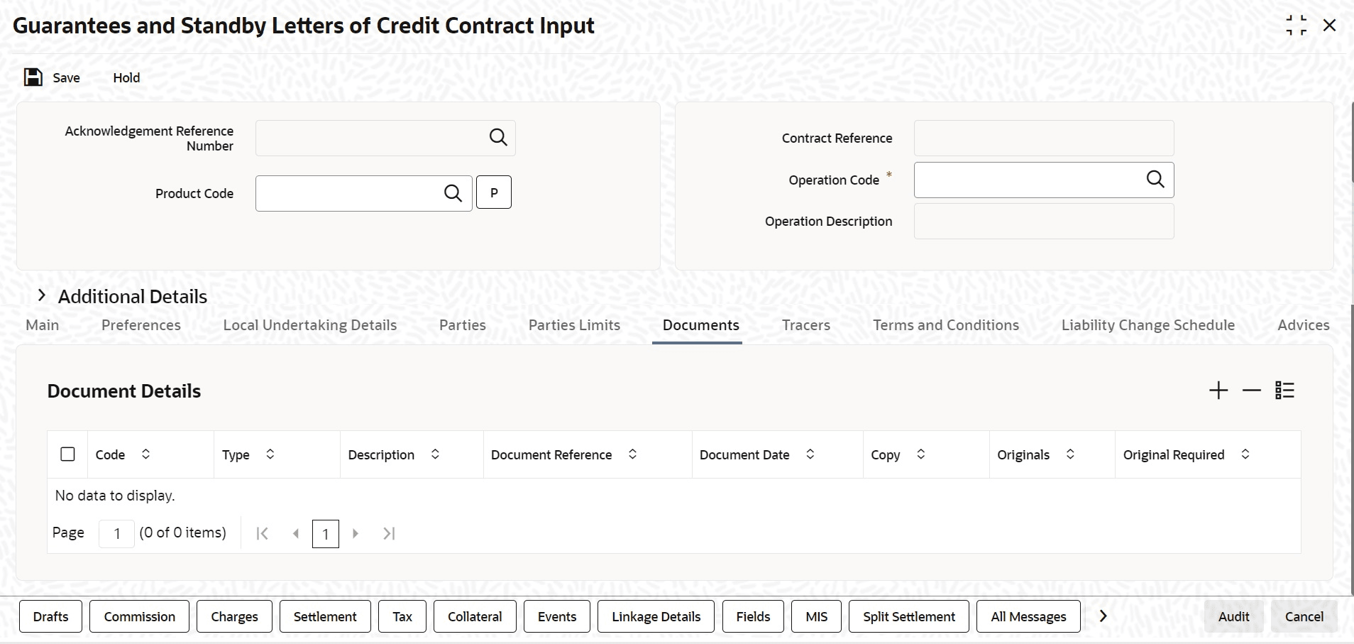

  8. On the Guarantees and Standby Letters of Credit Contract Input screen, click the Documents tab.
    The Document Details tab is displayed. For more information on fields, refer to the Field Description table given below:
    Table 9-8 Documents - Field Description
    Field Description
    Code
    Specify the document code. Select the document code from the option list.
    Type
    Select the type of document from the drop-down list.
    Description
    The system displays the document description.
    Document Reference
    Enter the document reference number based on which the Guarantee/SBLC issued.
    Document Date
    Specify the Document Date.
    Document date should be less than or equal to issue date.
    Copy
    Enter the number of copies of the document.
    Originals
    Enter the number of Original documents here.
    Original Required
    Check this box if original document is required.

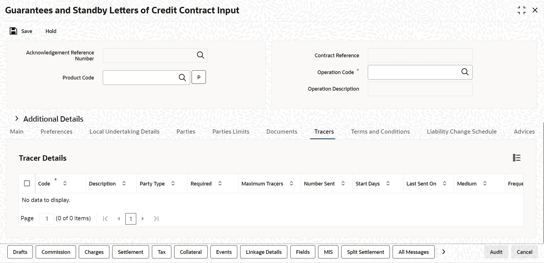

  9. On the Guarantees and Standby Letters of Credit Contract Input screen, click the Tracers tab.
    The Tracer Details is displayed.
    Tracers are reminders that can be sent to various parties involved in Guarantees and SBLCs. The list of tracers that you can send for an Guarantee/SBLC is predefined (hard coded in the system) and is as follows:
    • The Non-Extension Notification (NTF_FOR_NENX) tracer (sent to the advising bank to intimate that the undertaking will no longer be considered for automatic extension)
    Table 9-9 Tracers - Field Description
    Field Description
    Code
    The tracers, specified for the product to which you have linked the Guarantee/SBLC is defaulted to this screen.
    Description
    By default, the system displays the description for the product to which you have linked the Guarantee/SBLC.
    Party Type
    By default, the system displays the party type for the product to which you have linked the Guarantee/SBLC.
    Required
    By default, the system displays the required for the product to which you have linked the Guarantee/SBLC.
    Maximum Tracers
    By default, the system displays the maximum tracers for the product to which you have linked the Guarantee/SBLC.
    Number Sent
    By default, the system displays the number sent for the product to which you have linked the Guarantee/SBLC.
    Start Days
    By default, the system displays the start days for the product to which you have linked the Guarantee/SBLC.
    Last Sent On
    By default, the system displays the last sent on for the product to which you have linked the Guarantee/SBLC.
    Medium
    By default, the system displays the medium for the product to which you have linked the Guarantee/SBLC.
    Frequency
    By default, the system displays the frequency for the product to which you have linked the Guarantee/SBLC.
    Template Id
    By default, the system displays the template id for the product to which you have linked the Guarantee/SBLC.

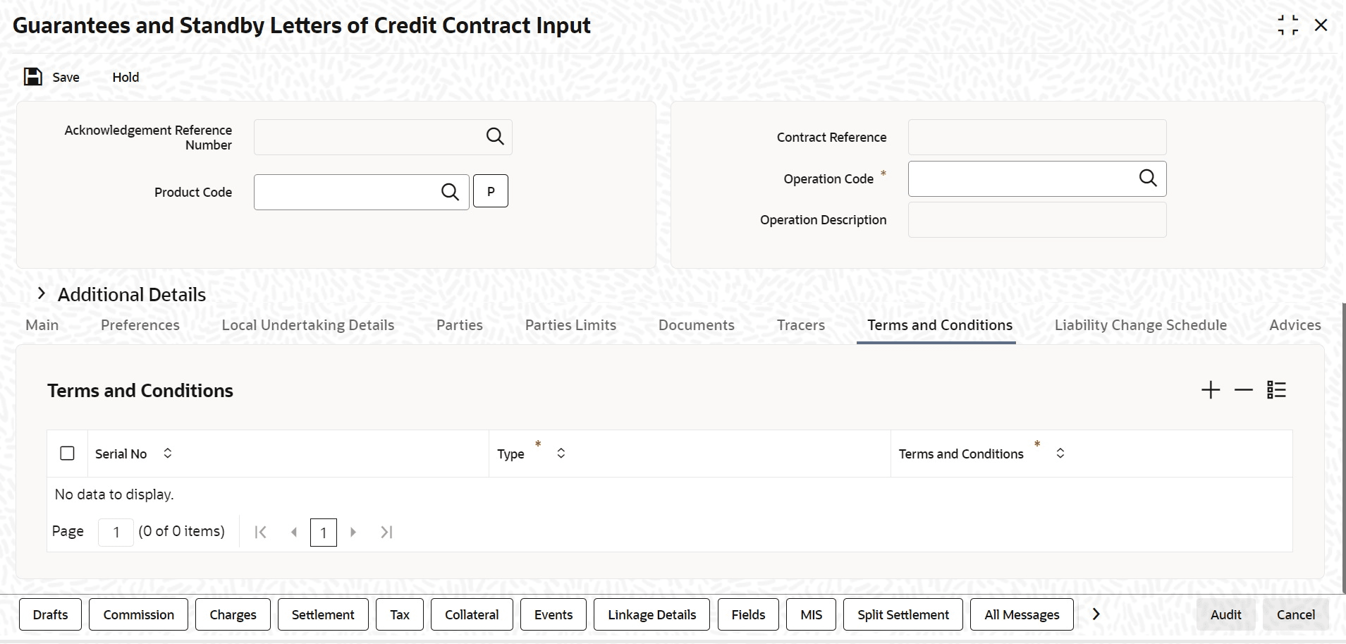

  10. On the Guarantees and Standby Letters of Credit Contract Input screen, click the Terms and Conditions tab.
    The Terms and Conditions is displayed.
    Figure 9-8 Terms and Conditions
    Table 9-10 Terms and Conditions - Field Description
    Field Description
    Serial No.
    Specify the serial number for terms and conditions.
    Type
    Select the guarantee type from the drop-down list.
    • Guarantee
    • Local Guarantee
    Specify the terms and conditions.
    Terms and Conditions for Guarantee are mandatory.

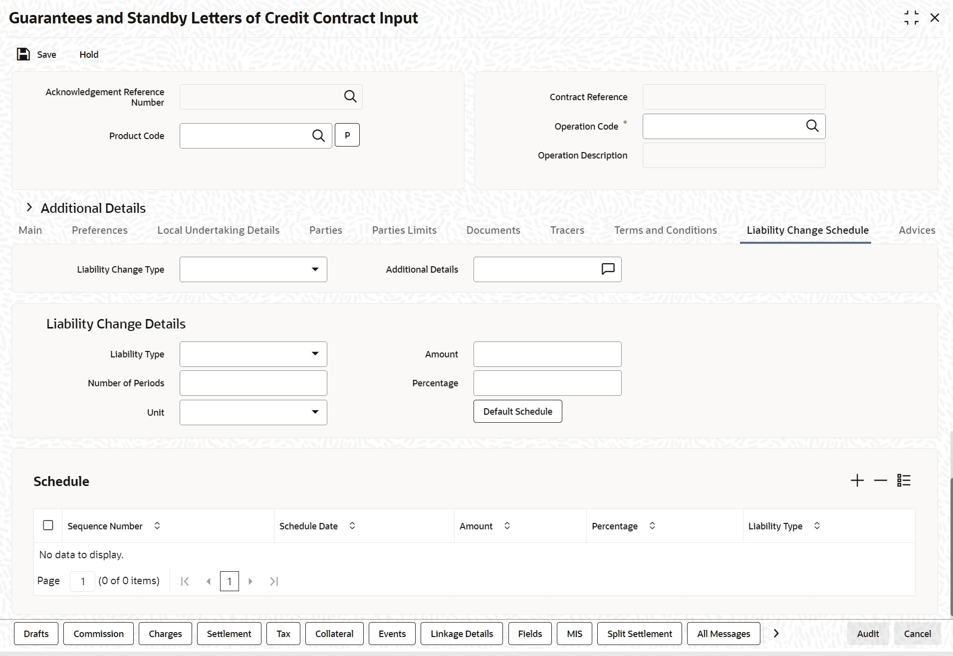

  11. On the Guarantees and Standby Letters of Credit Contract Input screen, click the Liability Change Schedule tab.
    The Liability Change Schedule screen is displayed.
    Figure 9-9 Liability Change Schedule
    Table 9-11 Liability Changes Schedule - Field Description
    Field Description
    Liability Change Type Indicates whether Liability Change is Time Based or Event Based:
    1. Processing will be scheduled in case of Time Based
    2. Additional details can be provided in case of Event Based. There is no functional impact.
    Additional Details Additional details can be provided in case of Event Based
    Liability Type
    Indicates Increase or Decrease or Both increase and decrease of liability
    Increase to be provided to increase the Guarantee amount
    • Decrease to be provided to decrease the Guarantee amount
    • Both to be provided in case of increase and decrease of Guarantee amount.
    Drop-down will be provided for the same.
    Number of Periods Indicates Number of Schedules. Should be greater than zero.
    Unit Indicates Unit of Payment or Retention namely: Yearly / Half-Yearly / Quarterly / Monthly Drop-down will be provided for the same.
    Amount
    Indicates schedule amount. Amount should be greater than zero.
    If Liability Type is decrease, Amount should not be less than Contract Amount.
    Percentage Indicates percentage of Contract amount to be considered for Liability change. Value should be 1 to 100.
    Default Schedule Button to default Liability Change Schedules based on above input parameters.
    Schedule The system displays the schedules.
    Sequence Number Indicates Schedule sequence number. System derives the same and will be display field.
    Schedule Date
    Indicates date on which system will initiate Liability Change Schedule.
    User can modify the defaulted schedule date. Schedule date will be defaulted based on Unit.
    If Units is Yearly, schedule date will be one Year
    from Guarantee Issue Date.
    • 366 Days will be considered in case of leap year
    • 365 Days will be considered if not a leap year
    If Units is Half-Yearly / Quarterly / Monthly , schedule date will be 6 months, 3 months, 1 month from the issue date respectively.
    • Calendar Days will be considered
    Schedule date should not be greater than Expiry Date for Guarantees without Automatic Extension. Schedule date should not be greater than Final Expiry Date for Guarantees with Automatic Extension.
    Amount Indicates amount applicable for each schedule:
    • If Liability change is increase, schedule amount can be greater or lesser than the Contract Amount
    • If Liability change is decrease, schedule amount should not be lesser than the Contract Amount
    Percentage will be derived based on Amount, if percentage is not available.
    Percentage Indicates percentage of Contract amount. Should be 1 to 100.
    1. Amount will be computed based on percentage, if amount is not available
    2. If both Percentage and Amount is available, percentage will be considered to derive the amount.
    Liability Type Indicates Increase or Decrease based on liability processing. User can modify the same.
    1. System will default Increase when Liability processing is Increase
    2. System will default decrease when Liability processing is Decrease.
    User should provide manually, when Liability processing is Both

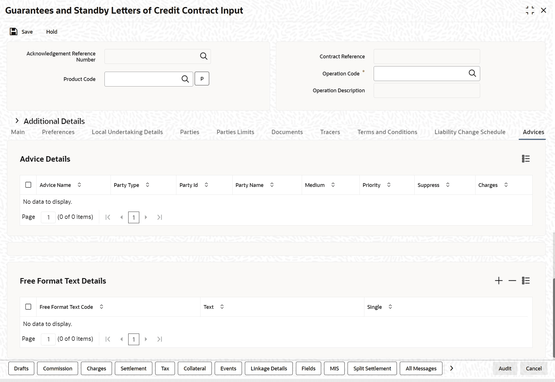

  12. On the Guarantees and Standby Letters of Credit Contract Input screen, click the Advices tab.
    The Advice Details is displayed. The details of the advices for an event are displayed in the Advices screen. The party type to whom a specific advice should be sent is picked up automatically based on the type of Guarantee/SBLC being processed and the parties involved.
    Table 9-12 Advice Details - Field Description
    Field Description
    Advice Name
    Specify the advice name.
    Party Type
    The system displays the party type for which the message is generated.
    Party Id
    The system displays the party ID for which the message is generated.
    Party Name
    The system displays the name of the party for which the advice is generated.
    Medium
    The medium by which an advice will be transmitted
    and the corresponding address will be picked up based on the media and address maintenance for a customer.
    You can change either of these while processing the LC. If changed, both of them will be changed. After selecting the advices to be generated for the LC, click Ok to save it. Click Exit or Cancel button to reject the inputs you have made. In either case, you will be taken to the Contract Main screen.
    Priority For a payment message by SWIFT, you also have the option to change the priority of the message. By default, the priority of all advices is marked as low. The priority of a payment message can be changed to one of the following:
    • Low
    • Medium
    • High
    Suppress
    By default, all the advices that have been defined for a product will be generated for the LCs involving it. If any of the advices are not applicable to the LC you are processing, you can suppress its generation by checking against the Suppress field.
    Charges
    The system displays the charges configured.
    Free Format Text Details
    Specify Free Format Text Details:
    Free Format Text Code
    To add an FFT to the list, click add icon. Select an FFT code from the option list that is displayed.
    New FFTs 24GDLYCOLAMD and 24GDLYCLAMDC introduced for Tag 24G in MT760. BENE or OTHR can be provided in FFT. If OTHR is provided , then Address details must be provided.
    CANC has to be provided against MT747 for message generation.
    Text
    After selecting the code that identifies the FFT you wish to attach to the advice, its description is automatically picked up and displayed. The FFT description can be changed to suit the requirements of the LC you are processing.
    Single
    Check this option to indicate that the FFT is a
    single message.

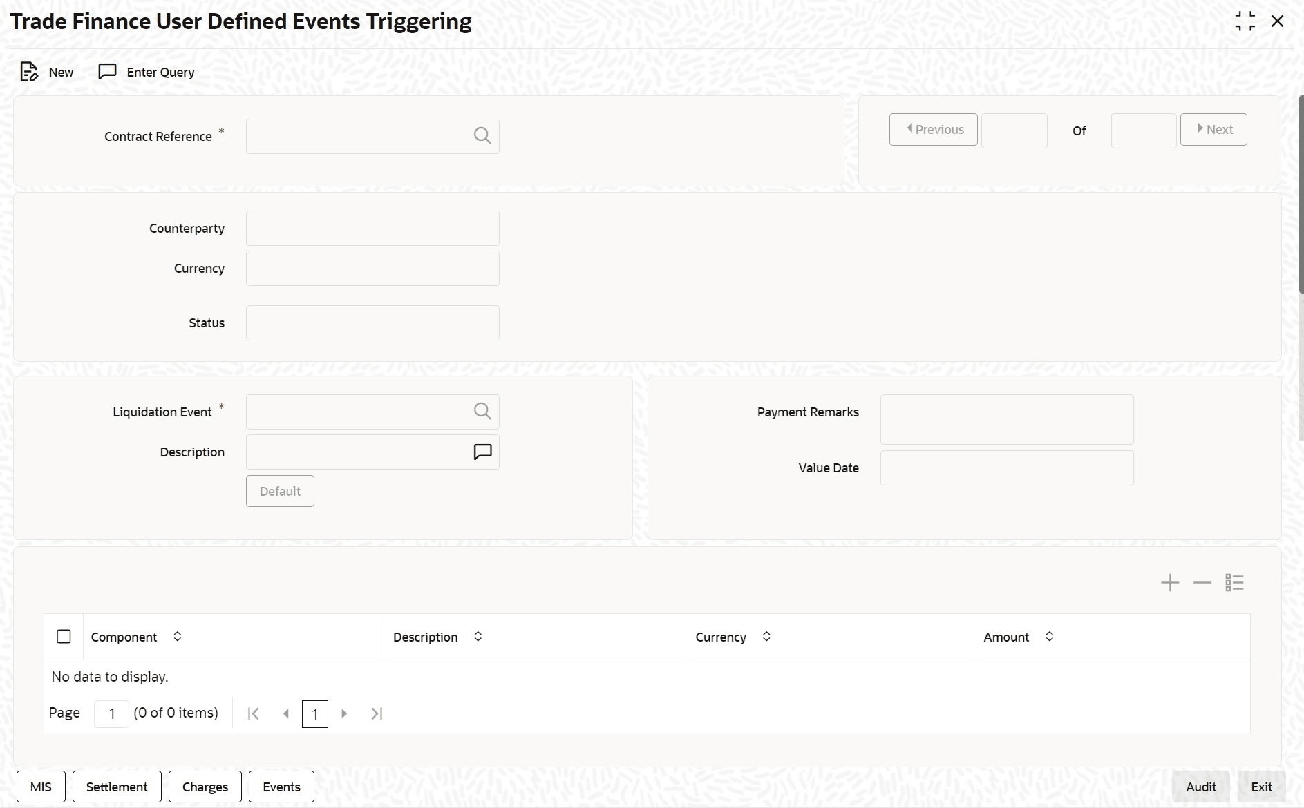

  13. On Query from contract input screen click UDE to launch the Trade Finance User Defined Events Triggering screen (UDDTFEVT) and perform additional accounting entries for active and authorized contracts.
    The UDE screen is displayed.
    Figure 9-11 Trade Finance User Defined Events Triggering
    Table 9-14 Trade Finance User Defined
    Field Description
    Contract Reference Number On click of New the contract reference number defaults.
    Counterparty On click of New the counterparty defaults.
    Status On click of New the status defaults.
    Currency On click of New the currency defaults
    Liquidation Event Select the event from the adjoining option list.
    Description Description defaults on select of event from the field liquidation event
    Payment Remarks Specify remarks pertaining to the payment on the account.
    Payment Remarks If the value date derivation rule has been maintained for the event code, the system will calculate the value date and display it here. However, you can change it
    Click ‘Default’ to default the following details:
    Amount Details: The system displays the following amount details
    Component
    Description
    Currency
    Amount

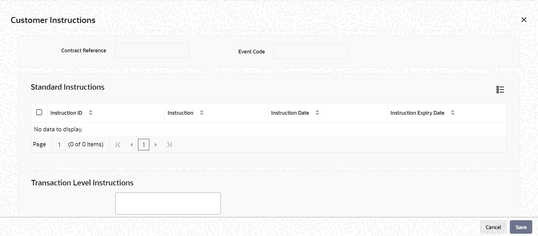

  14. On the Guarantees and Standby Letters of Credit Contract Input screen, click the Customer Instructions tab.
    The Customer Instructions screen is displayed.
    Figure 9-12 Customer Instructions
    Table 9-15 Customer Instructions - Field Description
    Field Description
    Contract Reference Number System displays the contract reference number.
    Event Code System displays the Event Code of the contract.
    Standard Instructions
    Customer would want to give Standard instructions in advance to the bank that need to be referred by the bank while processing certain type of transactions.
    Instruction ID System displays the Instruction ID.
    Instruction System displays the customer standard instruction.
    Instruction Date System displays the start date of the customer instruction.
    Instruction Expiry Date System displays the expiry date of the customer instruction.
    Transaction Level Instruction Enter the transaction level instructions for the event.
