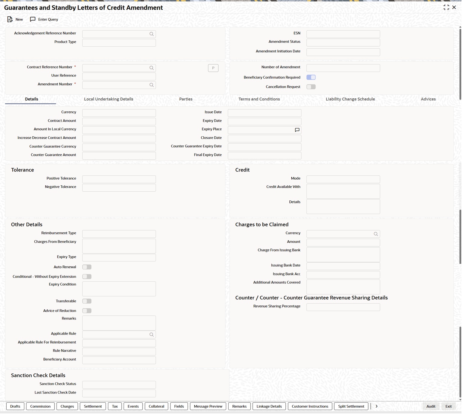

  4. On the Guarantees and Standby Letters of Credit Amendment screen, click the Details tab.
    The Details screen is displayed.
    Field Description
    Currency
    The system displays the currency.
    This field is optional.
    Contract Amount
    The system displays the contract amount.
    Amount in Local Currency
    When FCY amount is given in 'Contract Amount'
    field for Guarantee during Amendment, system converts in local currency and respective value is displayed in this screen. This field is mandatory for FCY contracts
    Increase Decrease Contract Amount
    The system displays the contract amount increased
    or decreased.
    Counter Guarantee Currency Select the currency of the counter guarantee from the list of values. Ensure that it matches the Local Guarantee Currency.
    This field is mandatory, if the counterparty type is APB (Applicant Bank).
    Counter Guarantee Amount Specify the amount of the counter guarantee. Ensure that it matches the Local Guarantee Amount.
    This field is mandatory, if the counterparty type is APB.
    Issue Date
    The system displays the issue date.
    Expiry Date
    Select the date on which the Guarantee/SBLC is scheduled to expire. On confirmation of guarantee amendment, revised Expiry Date is propagated to LCDGUONL. System derives Claim Expiry date based on the new Expiry Date.
    Expiry Place Specify the expiry place in the text box and click Ok.
    Closure Date
    Specify the date LC is scheduled to be closed. You
    can modify this.
    Counter Guarantee Expiry Date Specify the expiry date of the counter guarantee. Ensure that the date specified is later than the Local Guarantee Expiry Date.
    Final Expiry Date
    Select the final expiry date for automatic extension from the calendar. This date indicates the final expiry date after which undertaking will no longer be subject to automatic extension. This field is optional.
    Tolerance Specify the tolerance details:
    Positive Tolerance Specify the positive tolerance.
    Negative Tolerance Specify the negative tolerance.
    Credit Specify the credit details:
    Mode Select the mode from the drop-down list. The available options are:
    • Sight Payment
    • Acceptance
    • Deferred Payment
    • Mixed Payment
    • Negotiation
    Credit Available With Specify the credit available with in the text box and click Ok.
    Details Specify the details in the text box and click Ok.
    Other Details Specify the other details.
    Charges from Beneficiary
    Specify the charge amount borne by the beneficiary.
    Expiry Type Select the expiry type from the drop-down list. The list displays the following options:
    • Fixed
    • Open
    • Conditional - With Expiry
    • Conditional - Without Expiry
    Auto Renewal This flag specifies if the Open ended guarantee is to be auto renewed on EOD.
    Conditional - Without Expiry Extension Specify whether for a Conditional - Without Expiry type guarantee, expiry date is to be extended.
    Expiry Condition
    Specify the details for conditional guarantee.
    Transferable
    Check this box to indicate that the Guarantee/SBLC is transferable.
    Advice of Reduction
    Check this box to send Advice of Reduction (MT 769) message.
    Advice of Reduction cannot be enabled if Beneficiary Confirmation Required flag is enabled. You can amend Advice of Reduction check box, after disabling Beneficiary Confirmation Required flag and choosing Contract Reference number from the option list and clicking ‘P’ (Populate) button. If Advice of Reduction is enabled along with Beneficiary Confirmation flag then the system provides appropriate error message.
    Charges to be Claimed Specify the charges to be claimed:
    Currency
    Specify the currency in which the charges attributed to the issuing bank is expressed.
    Amount
    Specify the charge amount.
    Issuing Bank Date
    Specify the date of charge collection.
    Issuing Bank Account
    Specify the account from which charge should be collected.
    Additional Amount Covered Specify the additional amount covered. Details applicable to Advice of Reduction is propagated to Guarantees and Standby Letters of Credit Contract Input screen and it can be modified. STP of MT769 will initiate amendment or cancellation of Guarantees/Counter Guarantees in LCDGUAMD without Beneficiary Confirmation.
    • If value in tag 33B is equal to Guarantee amount cancellation will be initiated.
    • If value in tag 33B is lesser than Guarantee amount then amendment will be initiated.
    Revenue Sharing Percentage Specify the Revenue sharing percentage provided for the contract.
    Remarks Specify the remarks in the text box and click Ok.
    Applicable Rule The system displays the applicable rule by default.
    Applicable Rule for Reimbursement Select the applicable rule for Reimbursement from the drop-down list. The available options are
    • URR Latest Version
    • Not URR
    Rule Narrative The system displays the rule narrative by default.
    Requested Confirmation Party Select the requested confirmation party from the drop-down list. The available options are
    • Advising Bank
    • Advice Through Bank
    • Confirming Bank
    Beneficiary Account Specify the account details of beneficiary. This field is read only
    Sanction Check Details Provide sanction check details:
    Sanction Check Status The system displays the sanction check status.
    Last Sanction Check Date The system displays the last sanction check date.

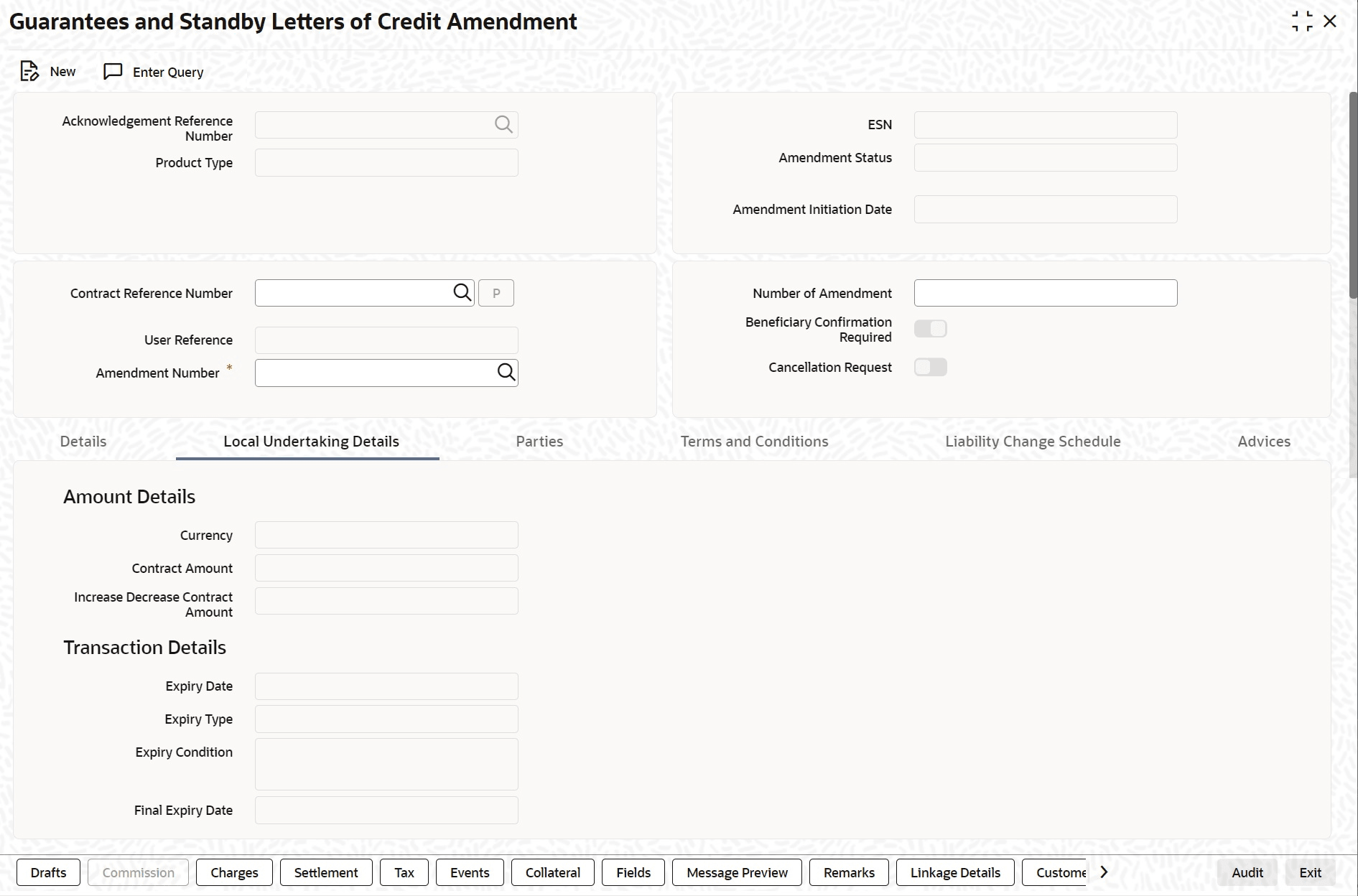

  5. On the Guarantees and Standby Letters of Credit Amendment screen, click the Local Undertaking Details tab.
    The Local Undertaking Details is displayed.
    Figure 9-16 Local Undertaking Details
    For more information on the fields, refer the Field Description table given below:
    Table 9-19 Local Undertaking Details - Field Description
    Field Description
    Amount Details Specify the Amount Details.
    Currency
    The system displays the currency details by default.
    The field is optional.
    Contract Amount Enter the contract amount.
    BIC code appears next to the Customer No only if the BIC code is mapped with the customer number. If the BIC Code is not mapped with that customer number, then the BIC Code will not appear next to the Customer No in the option list. The field is optional.
    The system defaults the customer name.
    Transaction Details Specify the Transaction Details:
    Expiry Date
    Select the expiry date from the calendar icon.
    Expiry Type Select the expiry type from the option list. The available options are:
    • Fixed
    • Open
    Expiry Condition
    Specify the expiry condition and click Ok.
    Final Expiry Date
    Select final expiry date from the calendar.

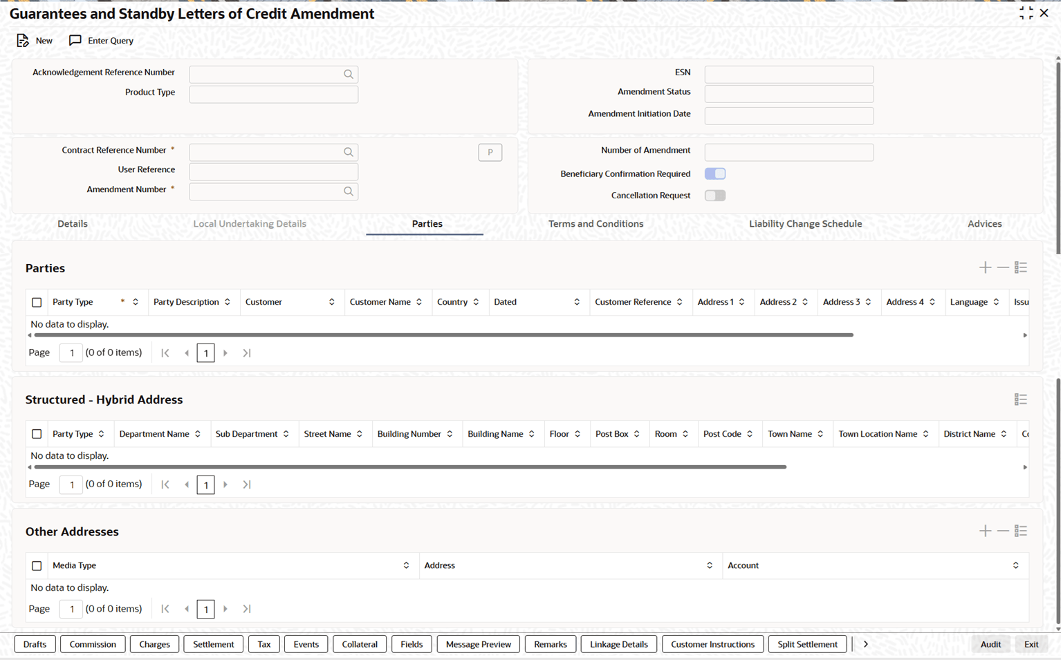

  6. On the Guarantees and Standby Letters of Credit Amendment screen, click Parties tab.
    The Parties details is displayed. For more information on the fields, refer the Field Description table given below:
    Table 9-20 Parties - Field Description
    Field Description
    Party Type The system defaults the party type.
    The field is mandatory.
    CIB and LIB will be parties for Counter Guarantee. These parties can be provided if Purpose of Guarantee is Request. CIB will be receiver in the outgoing MT760 header and LIB details will not be available in MT760.In MT760, Tag 22A will be ICCO if CIB is available.
    ABK and ATB parties can be provided and is optional. ABK and ATB will be Advising Bank and Advice Through Bank of the Local Guarantee respectively.
    LIB will be a party in Counter Guarantee. Purpose of Guarantee to be Request.
    Counter Counter Guarantee Issuing Bank will be captured as APB.
    In MT760, Tag 22A will be ISCO if only LIB is available.
    LIB will be receiver in MT760 header. Counter Guarantee Issuing Bank will be captured as APB. These parties can be provided if purpose of Guarantee is Issue.
    Party Description
    The system defaults the party description.
    Customer
    The system defaults the customer number. You can modify the customer number of the beneficiary.
    Specify the Customer for which you need to
    maintain. Select the Customer No from the option
    list.
    Customer Name
    Address 1 to 4
    The system defaults the address of the party.
    Country
    The system defaults the country of the customer.
    Customer Reference
    The system defaults the customer reference number. However, you can modify it.
    Dated
    The system defaults the date on which the party
    joined. However, you can modify it.
    Language
    The system defaults the language in which advices are sent to the customer.
    Issuer Bank
    The system defaults the name of the issuer bank.
    Structured Payment Address Specify the following payments releated details.
    Party Type Specify the Party Type of a customer.
    Department Name Specify the Department Name of a customer.
    Sub Department Specify the Sub Department of a customer.
    Street Name Specify the Street Name of a customer.
    Building Number Specify the Building Number of a customer.
    Building Name Specify the Building Name of a customer.
    Floor Specify the Floor of a customer.
    Post Box Specify the Post Box of a customer.
    Room Specify the Room number of a customer.
    Post Code Specify the Post Code of a customer.
    Town Name Specify the Town Name of a customer.
    This field is mandatory.
    Town Location Name Specify the Town Location Name of a customer.
    District Name Specify the District Name of a customer.
    Country Sub Division Specify the Country Sub Division of a customer.
    Country Specify the Country Code of a customer.
    Address Line1 Specify the Address of a customer.
    Address Line2 Specify the Address of a customer.
    Other Addresses Provide the other addresses details:
    Media Type
    The system defaults the media type. Select a
    different medium from the option list.
    Address
    The system defaults the other address of the party.
    However, you can edit this field.
    Account
    The system defaults the account number.

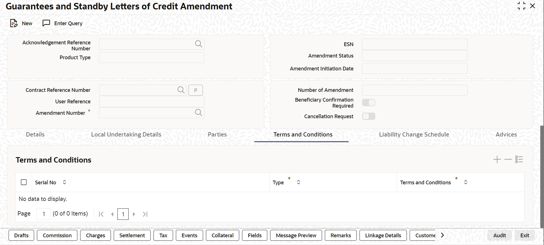

  7. On the Guarantees and Standby Letters of Credit Amendment screen, click the Terms and Conditions tab.
    The Terms and Conditions is displayed.
    Figure 9-18 Terms and Conditions - Field Description
    For more information on fields, refer the following Field Description table:
    Table 9-21 Terms and Conditions - Field Description
    Field Description
    Serial No.
    Specify the serial number for terms and conditions.
    Type Select the guarantee type from the drop-down list. Available options are:
    • Guarantee
    • Local Guarantee
    Specify the terms and conditions.

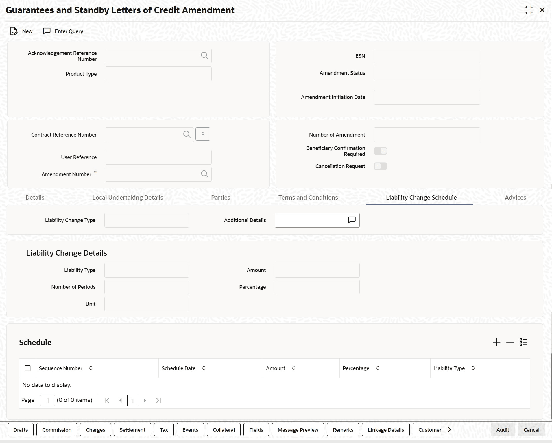

  8. On the Guarantee and Standby Letters of Credit Amendment screen, click the Liability Change Schedule tab.
    The Liability Change Schedule screen is displayed.
    Figure 9-19 Liability Change Schedule
    For more information on fields, refer the Field Description table given below:
    Table 9-22 Liability Changes Schedule - Field Description
    Field Description
    Liability Change Type Indicates whether Liability Change is Time Based or Event Based:
    1. Processing will be scheduled in case of Time Based
    2. Additional details can be provided in case of Event Based. There is no functional impact.
    Additional Details Additional details can be provided in case of Event Based
    Liability Type Indicates Increase or Decrease or Both increase and decrease of liability
    Increase to be provided to increase the Guarantee amount
    • Decrease to be provided to decrease the Guarantee amount
    • Both to be provided in case of increase and decrease of Guarantee amount
    Drop-down will be provided for the same.
    Number of Periods Indicates Number of Schedules. Should be greater than zero.
    Unit Indicates Unit of Payment or Retention namely: Yearly / Half-Yearly / Quarterly / Monthly Drop-down will be provided for the same.
    Amount Indicates schedule amount. Amount should be greater than zero.
    If Liability Type is decrease, Amount should not be less than Contract Amount.
    Percentage Indicates percentage of Contract amount to be considered for Liability change. Value should be 1 to 100.
    Default Schedule Button to default Liability Change Schedules based on above input parameters
    Schedule The system displays the schedules.
    Sequence Number Indicates Schedule sequence number. System derives the same and will be display field.
    Schedule Date
    Indicates date on which system will initiate Liability
    Change Schedule.
    User can modify the defaulted schedule date. Schedule date will be defaulted based on Unit.
    If Units is Yearly, schedule date will be one Year
    from Guarantee Issue Date.
    • 366 Days will be considered in case of leap year
    • 365 Days will be considered if not a leap year
    If Units is Half-Yearly / Quarterly / Monthly , schedule date will be 6 months, 3 months, 1 month from the issue date respectively.
    • Calendar Days will be considered
    Schedule date should not be greater than Expiry Date for Guarantees without Automatic Extension. Schedule date should not be greater than Final Expiry Date for Guarantees with Automatic Extension.
    Amount Indicates amount applicable for each schedule:
    • If Liability change is increase, schedule amount can be greater or lesser than the Contract Amount.
    • If Liability change is decrease, schedule amount should not be lesser than the Contract Amount.
    Percentage will be derived based on Amount, if percentage is not available
    Percentage Indicates percentage of Contract amount. Should be 1 to 100.
    1. Amount will be computed based on percentage, if amount is not available
    2. If both Percentage and Amount is available, percentage will be considered to derive the amount.
    Liability Type Indicates Increase or Decrease based on liability processing. User can modify the same.
    1. System will default Increase when Liability processing is Increase
    2. System will default decrease when Liability processing is Decrease
    User should provide manually, when Liability processing is Both

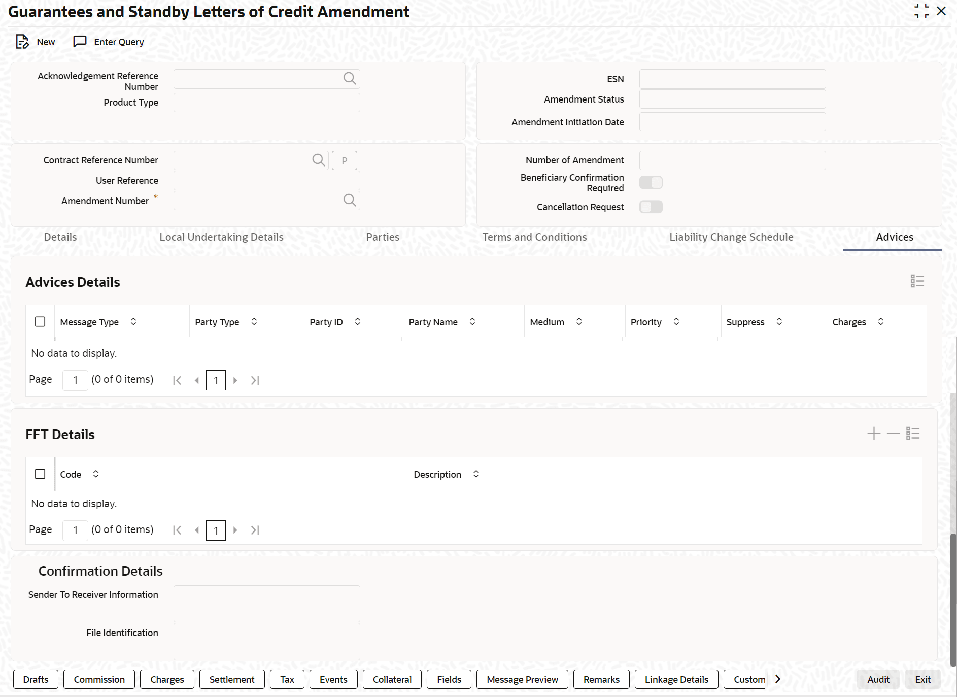

  9. On the Guarantees and Standby Letters of Credit Amendment screen, click the Advices tab.
    The Advices Details is displayed.
    Figure 9-20 Advices - Field Description
    Table 9-23 Advices - Field Description
    Field Description
    Advices Details Specify the Advice Details.
    Message Type
    Check the box to view the advice details.
    Party Type
    The system displays the party type for which the advice is generated.
    Party Id The system displays the party id for which the advice is generated.
    Party Name The system displays the name of the party for which the advice is generated.
    Medium The system displays the medium through which the advice is sent. The user can select a different medium from the list. If the medium is modified, the user must provide the new address in the Other Addresses section, in the Parties tab.
    Priority The system displays the priority of sending the advice. However, you can change the priority.
    Suppress The system displays if the advice is suppressed or not. However, you can edit this field.
    Charges The system displays the charges involved. However, you can edit the charges.
    FFT Details The user can select a message from the Advices Details section and associate a code and a description to it.
    Table 9-24
    Code The user can select the appropriate code from the option list.
    Description The system displays the description of the selected code. However, you can modify this description. For more details on the buttons in Guarantees and SBLC Amendment screen, refer the chapter titled Amending Details of LC in this user manual. The following table provides the list of SWIFT messages and the fields of SWIFT messages that utilizes the information provided in this screen
    Confirmation Details Specify the confirmation details for FFT modification. It is applicable only for confirm action.
    Sender To Receiver Information Specify the sender to receiver information in the text box and click Ok.
    The typed text is displayed against the Sender to receiver Information field.
    File Identification Specify the file identification in the text box and click Ok.
    User can modify the defaulted FFT details. The modified FFT details will be stored in LCTB_AMND_VALS_FFT on confirmation and the same will be populated in outgoing MT787.
    The typed text is displayed against the file identification field.
    Table 9-24 FFT Details
    FFT Code Message
    23RREJTRESP MT787
    23XFILEIDENT MT787
    The following table details are applicable only if SWIFT 2019 is enabled.
    Table 9-25 SWIFT messages
    Field in Oracle Banking Trade Finance SWIFT Message Field of the SWIFT message
    Operation Code MT767 22A
    Purpose of Guarantee MT767 22A
    Cancellation Request MT767 23S
    Contract Reference Number MT767,MT775 20
    Number of Amendment MT767,MT775,MT787 26E
    Amendment Date MT767 30
    Party Id – ISB MT767,MT775 52a
    Increase Decrease Contract Amount MT767 32B,33B
    Validity Type MT767 23B
    Expiry Date MT767 31E
    Expiry Condition MT767 35L
    Party Id – BEN MT767 59
    Documents – Description MT767 45C
    Local Guarantee Details- Expiry Date MT767 31E - Sequence C
    Amendment Status MT787 23R
