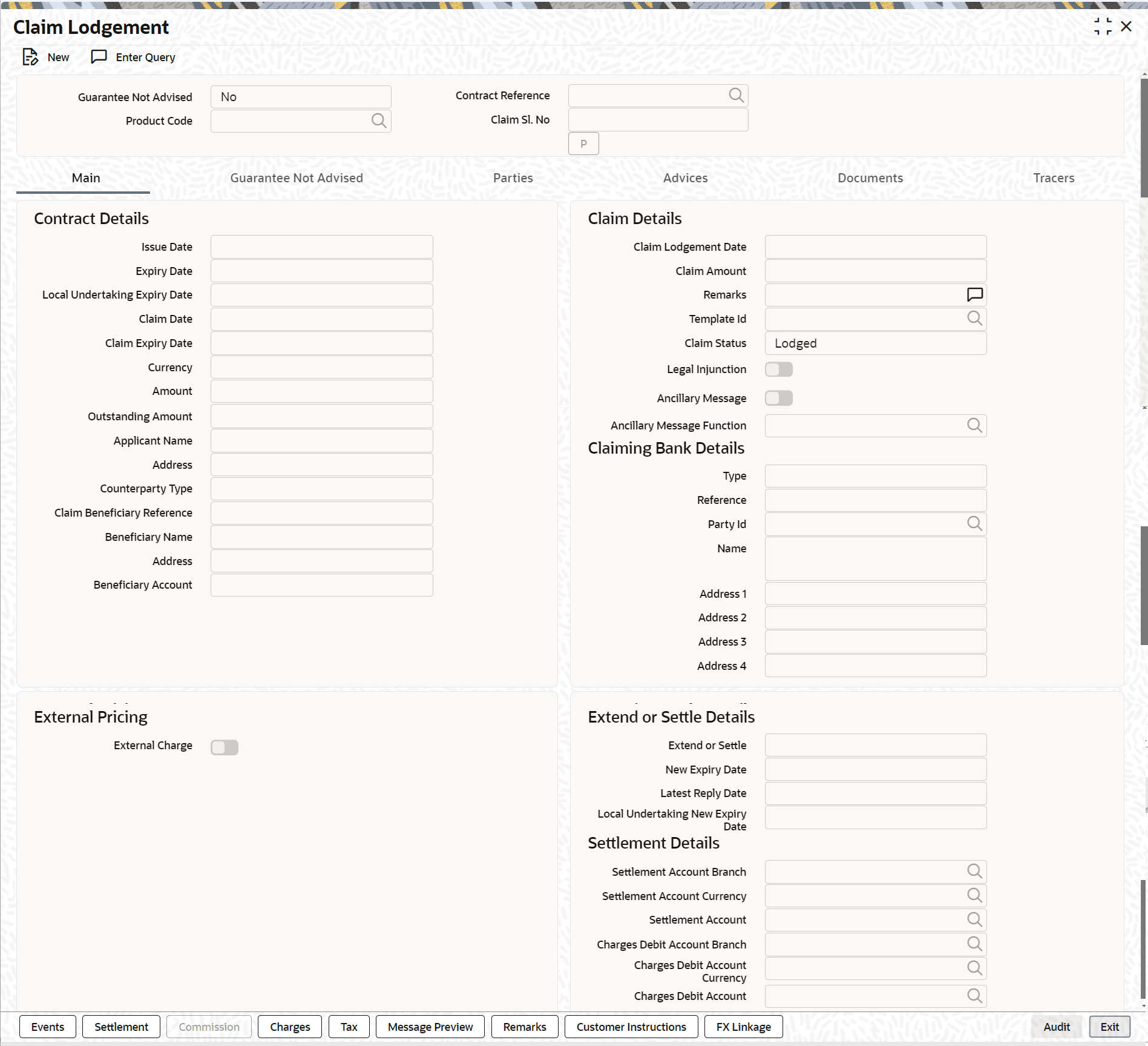

  1. On the Homepage, type LCDGCLM in the text box, and click next arrow.
    The Claim Lodgement screen is displayed.
  2. On the Claim Lodgement screen, click New.
    The Claim Lodgment screen is displayed without any details.

  3. On the Main details in the Claim Lodgement screen, user can view the contract details.
    The system displays the contract details.
    For more information on Main details, refer the Field Description table given below:

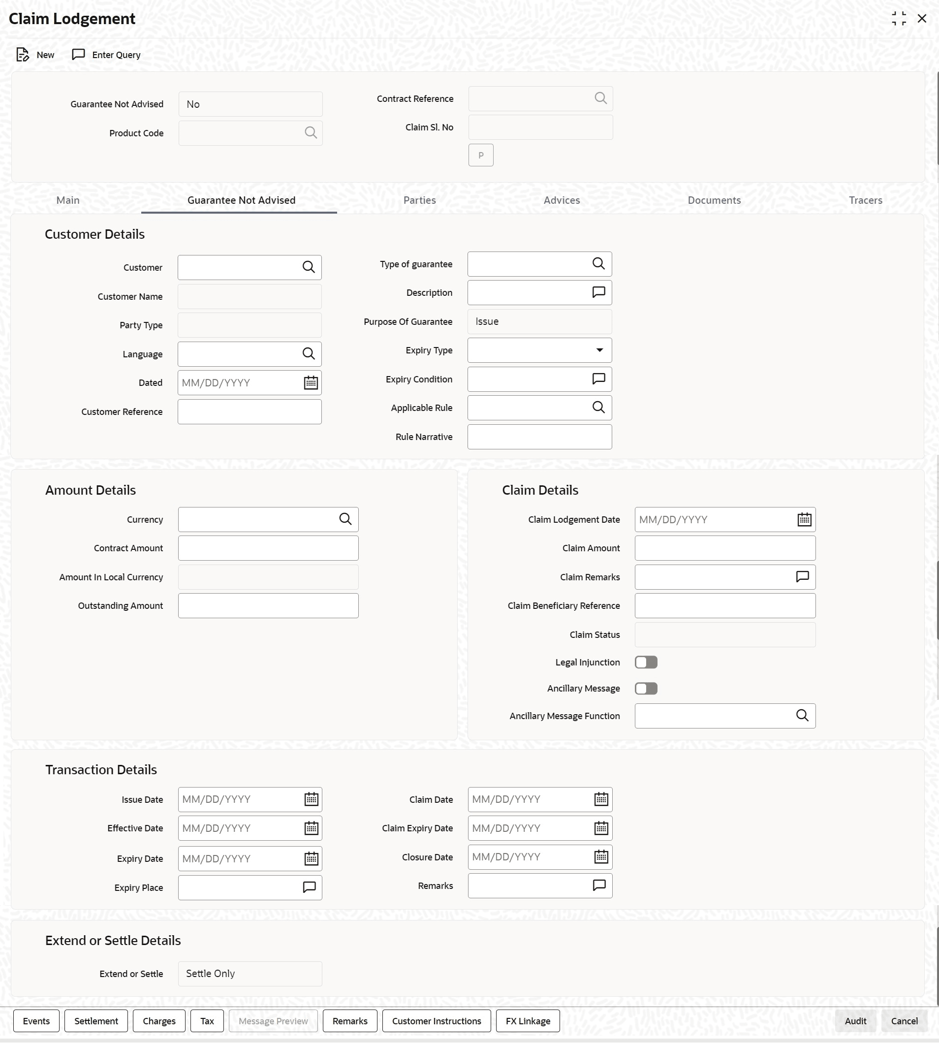

  4. On the Claim Lodgement screen, click the Guarantee Not Advised tab.
    The Guarantee Not Advised tab is displayed.
    Figure 9-24 Guarantee Not Advised
    Description of Figure 9-24 follows
    Description of "Figure 9-24 Guarantee Not Advised"
  5. Specify the Guarantee Not Advised Details.
    For more information on fields, refer the Field Description table given below:
    Table 9-30 Guarantee Not Advised - Field Description
    Field Description
    Customer List of values with list of all valid customers.
    Customer Name System will default Customer Name based on Customer.
    Party Type System will default BEN and will be read only.
    Language System will default user language and the same can be modified.
    List of values with list of languages will be provided.
    Dated Specify the Customer reference date.
    Customer Reference Specify the Customer reference number.
    Type of Guarantee Select the list of guarantee types:
    1. APAY- Advance Payment Guaranteeb.
    2. BILL- Bill of Lading Guaranteec.
    3. CUST- Customs Guaranteed.
    4. DPAY- Direct pay Guaranteee.
    5. INSU- Insurance Guaranteef.
    6. JUDI- Judicial Guaranteeg.
    7. LEAS- Lease Guaranteeh.
    8. OTHR- Other Guaranteei.
    9. PAYM- Payment Guaranteej.
    10. PERF- Performance Guaranteek.
    11. RETN- Retention Guaranteel.
    12. SHIP- Shipping Guaranteem.
    13. TEND- Tender Guaranteen.
    14. WARR- Warranty/Maintenance
    Description System will default Guarantee type description and the same can be modified.
    Purpose of Guarantee System will default Issue and will be read only.
    Expiry Type Expiry type will have options as Fixed, Open and Conditional -With Expiry and Conditional - Without Expiry.
    Expiry Condition Specify the expiry condition, if Expiry type is Conditional.
    Applicable Rule System will default from product maintenance and the same can be modified. LOV with list of Applicable Rules namely ISPR, NONE, OTHR, UCPR, URDG will be provided.
    Rule Narrative This field is applicable if Applicable Rule is OTHR.
    Amount Details
    Currency System will default local currency and the same can be modified.
    List of values provided with list of valid currencies.
    Contract Amount Specify the contract amount.
    This field is mandatory.
    Amount in Local Currency System will default local currency equivalent and will be read only.
    Outstanding Amount User to provide manually and will be mandatory.
    Should not be greater than contract amount.
    Outstanding amount will be reduced on claim settlement.
    Claim Lodgement Date Specify the claim lodgement date using the calendar icon.
    Claim Amount Specify the amount of the claim.
    The claim amount should be less than or equal to outstanding amount and will be mandatory.
    Claim Remarks Specify remarks, if any.
    Claim Beneficiary Reference Specify the Claim Beneficiary Reference details.
    Claim Status System defaults the claim status as per existing functionality. The status are as follows:
    • Lodged on claim lodgement if extend or settle is “settle only”
    • Injunction Received on receipt of Legal Injunction
    • Rejected on Reject
    • Settled on settlement
    • Extend or Settle if ‘extend or settle’ field is “extend or settle”
    • Extended if ‘extend or settle’ field is “Extension”
    Legal Injunction Select this check box during claim amendment.
    Ancillary Message Check Box to support ancillary message generation during claim amendment
    Ancillary Message Function List of values with list of ancillary message function and description.
    To be provided when ancillary message is enabled.
    1. CLSVCLOS- Closing of a service call by Trade Operations
    2. CLSVOPEN- Opening of a service call by Trade Operations
    3. FRAUDMSG- Advice of a fraud attempt
    4. GENINFAD- General information advice
    5. OTHERFNC- Other request
    6. REIMBURS- Request related to a reimbursement
    7. REQFINAN- Financing request
    8. REXTMATU- Request to extend the maturity date
    9. TRANSFER- Transfer of a undertaking
    Transaction Details
    Issue Date Specify the issue date.
    The issue date should be back dated.
    Effective Date Specify the effective date.
    The effective date should be back dated.
    Expiry Date Specify the expiry date.
    The expiry date should be should be greater than issue date.
    Claim Date Specify the claim date.
    Closure Date Specify the closure date.
    Extend or Settle System will default Settle only and will be read only.
    Extension is not supported.

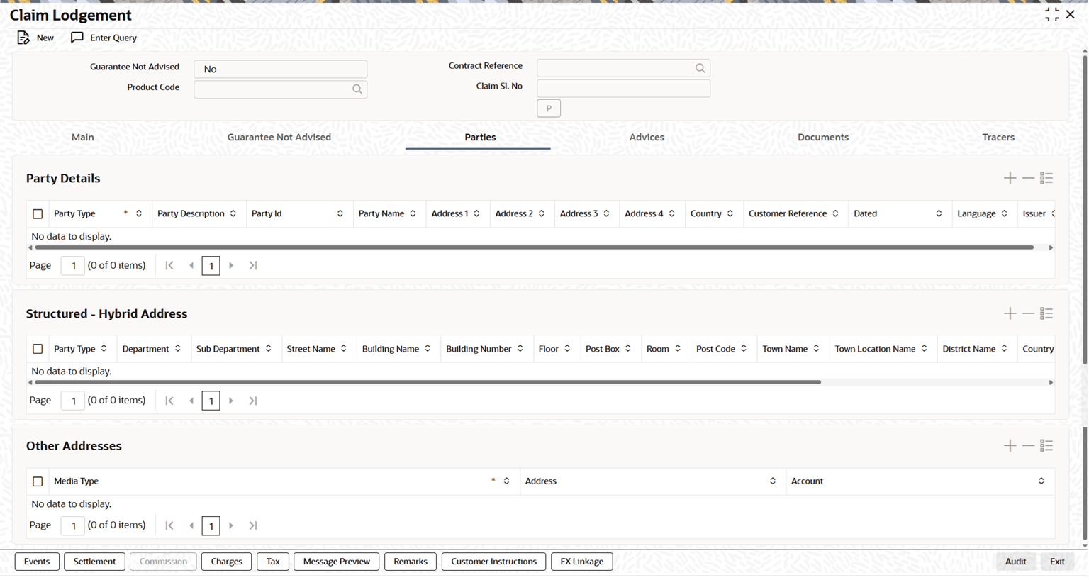

  6. On the Claim Lodgement screen, click the Parties tab.
    The Parties tab is displayed.
  7. Specify the Parties details.
    Table 9-31 Parties - Field Description
    Field Description
    Party Type Specify the party type (beneficiary, applicant, advising bank, issuing bank). The option list displays all party types available for the LC. Select the appropriate party type from the list.
    Party Description
    Specify the party description for the party type here.
    This is optional.
    Party ID
    Specify a Party ID for which you need to maintain. Alternatively, you can select the Customer No from the List of Values Party Id.
    This is optional.
    Party Name
    Specify the name of the Customer. The party name can be 150 characters in length.
    This is optional.
    Address 1 to 4
    Specify the address of the customer who has initiated the transaction.
    This is optional.
    Country
    Specify the country of the customer.
    This is optional.
    Customer Reference
    Specify the sender’s reference number. Input to this field will be mandatory for the party type ISB.
    This is optional.
    Dated
    Specify the date of transaction initiation.
    This is optional.
    Language
    Specify the language in which advices should be sent to the customer.
    This is optional.
    Issuer Bank
    Select this option to indicate that the issuer is a bank.This is optional.
    Structured Payment Address Specify the following payments releated details.
    Party Type Specify the Party Type of a customer.
    Department Name Specify the Department Name of a customer.
    This field is optional.
    Sub Department Specify the Sub Department of a customer.
    Street Name Specify the Street Name of a customer.
    Building Number Specify the Building Number of a customer.
    Building Name Specify the Building Name of a customer.
    Floor Specify the Floor of a customer.
    Post Box Specify the Post Box of a customer.
    Room Specify the Room number of a customer.
    Post Code Specify the Post Code of a customer.
    Town Name Specify the Town Name of a customer.
    Town Location Name Specify the Town Location Name of a customer.
    District Name Specify the District Name of a customer.
    Country Sub Division Specify the Country Sub Division of a customer.
    Country Specify the Country Code of a customer.
    Address Line1 Specify the Address of a customer.
    Address Line2 Specify the Address of a customer.
    Other Addresses Provide the other addresses details:
    Media Type
    Select the Media Type from the option list.
    The field is mandatory.
    Address
    This field indicates the party’s mail address.
    This is optional.
    Account
    Specify the account number.

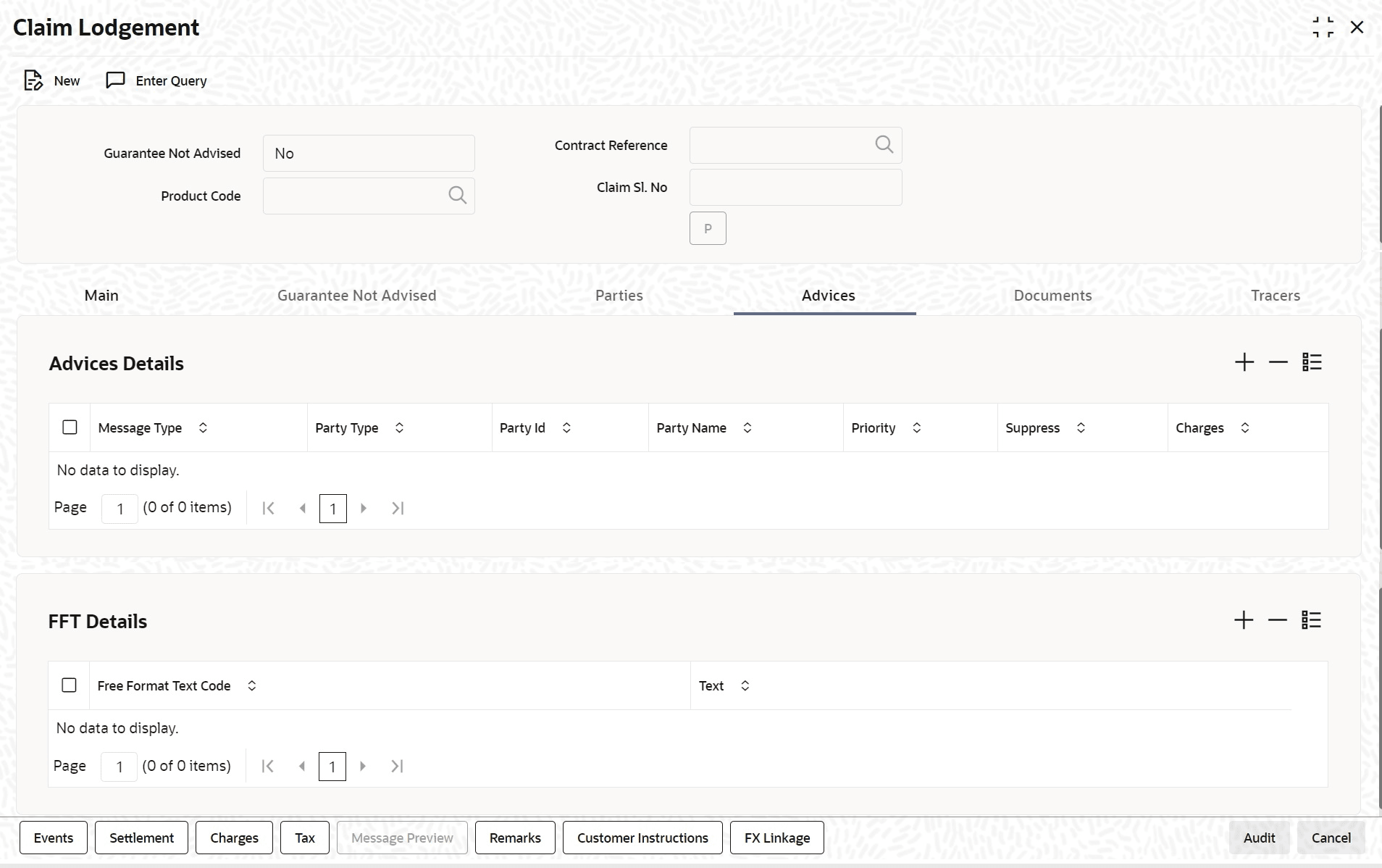

  8. On the Claim Lodgement screen, click the Advices tab.
    The Advices Details is displayed.
  9. Specify the Advices details.
    Once you select the Advise Details check box and click on add icon to capture the Advices details.
    Click on add icon to include to include parties details.
    Table 9-32 Advices - Field Description
    Field Description
    Advise Details Specify the Advise Details.
    Message Type The system displays the message type of the advice generated. This field is optional.
    Party Type The system displays the party type for which the message is generated. Claims can be lodged for SBLCs with Reimbursing Bank if Bills are not booked under the SBLC. If a Bill is booked under SBLC, system will provide appropriate error message during Claim lodgement. This field is optional.
    Party Id The system displays the party ID for which the message is generated. This field is optional.
    Party Name The system displays the name of the party for which the advice is generated. This field is optional.
    Medium Select the medium through which the message has to be sent from the option list. This field is optional.
    Priority Select the priority of sending message from the drop-down list. This field is optional.
    Suppress Check this box to suppress the message. This field is optional.
    Charges The system displays the charges configured. This field is optional.
    Guarantee claim Settlement advice GUA_CLAIM_ADV/MT765 is generated during claim Settlement if SWIFT 2019 is enabled.
    Guarantee claim Settlement advice GUACLAIM_ADV/MT799 is generated during claim rejection if SWIFT 2018 is enabled.
    If Ancillary Message is checked during claim Settlement then advice GUACLAIM_ADV/MT759 is generated during claim Settlement if SWIFT 2018 is enabled.
    Guarantee claim rejection advice GUA_CLAIM_REJ/MT786 is generated during claim rejection if SWIFT 2019 is enabled.
    Guarantee claim rejection advice GUA_CLAIM_REJ/MT799 is generated during claim rejection if SWIFT 2018 is enabled.
    If Ancillary Message is checked during claim rejection then advice GUA_CLAIM_REJ/MT759 is generated during claim rejection if SWIFT 2018 is enabled.
    FFT Details Specify the FFT Details. This field is optional.
    Free Format Text Code Select the free format text code from the option list.
    You can select the required code as given in the Table 9-33. This field is optional.
    Text The system displays a brief description on free format text. This field is optional.

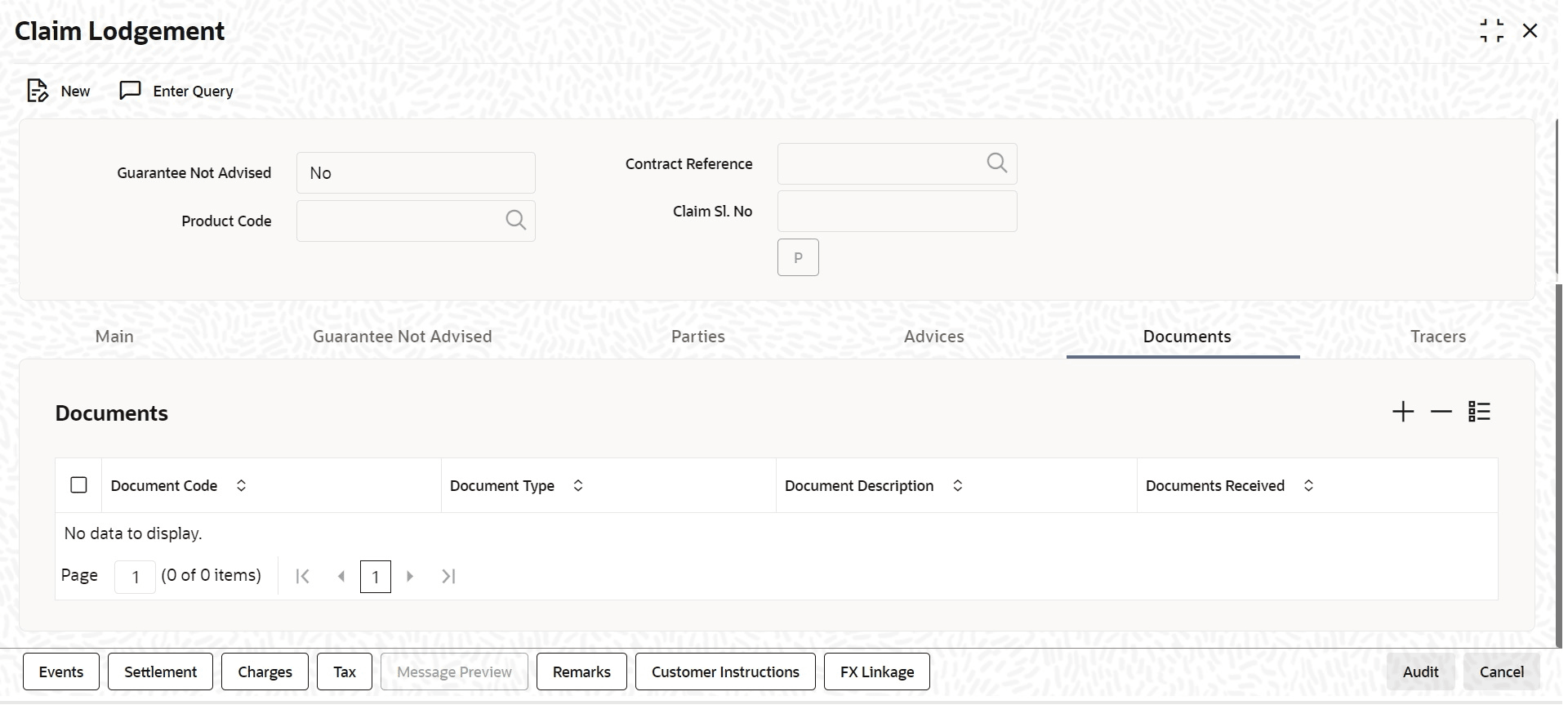

  10. On the Claim Lodgement screen, click Documents.
    The Documents details is displayed.
  11. Specify the document details.
    The documents captured during Guarantee Issuance are defaulted when claim is lodged.
    For more information on fields, refer the following field description table.
    Table 9-34 Documents - Field Description
    Field Description
    Document Code The code of the document captured during guarantee issuance is defaulted here. This field is optional.
    Document Type The type of document captured during guarantee issuance is defaulted here. This field is optional.
    Document Description The description of the document is defaulted here. This field is optional.
    Document Received Check this box to indicate that documents are received. The following table provides the list of SWIFT messages and the fields of SWIFT messages that utilizes the information provided in this screen. This field is optional.
    The following table provides the list of SWIFT messages and the fields of SWIFT messages that utilizes the information provided in this screen: The above details are applicable only if SWIFT 2019 is enabled.

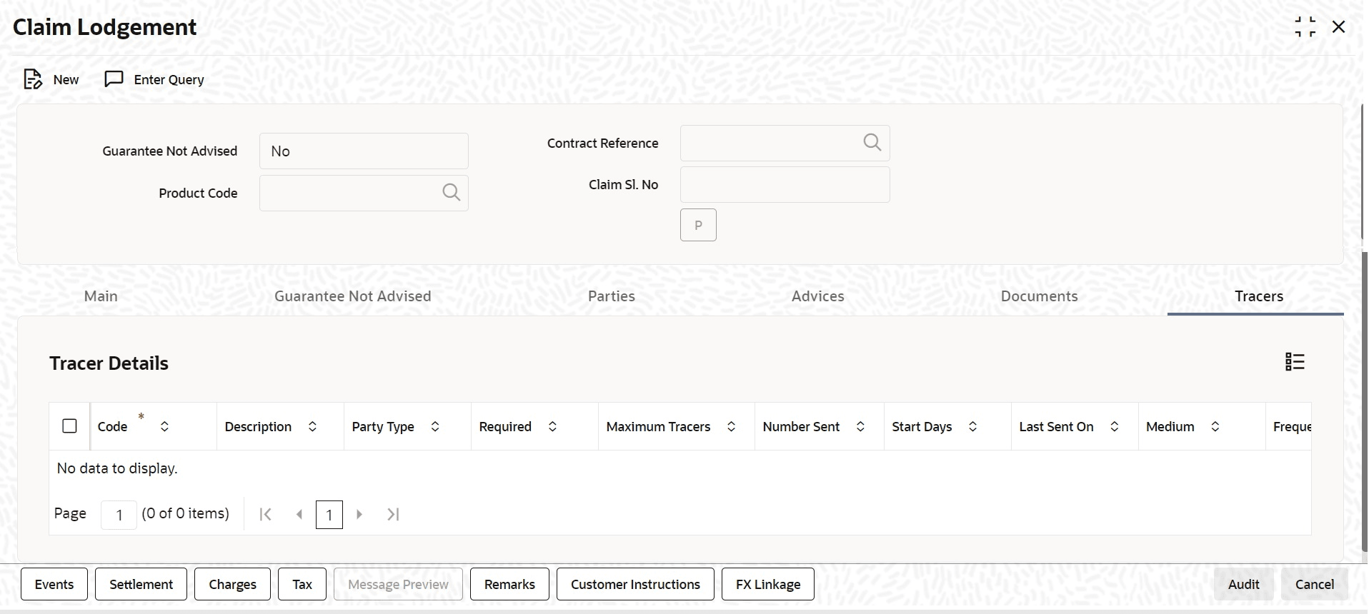

  12. On the Claim Lodgement screen, click Tracers.
    The Tracers details is displayed.
    Tracers are reminders that can be sent to various parties involved in a claim.
    New tracer code Guarantee claim tracer (GUA_CLM_TRACER) introduced to support tracer generation for claims lodged.
  13. On the Tracer tab, specify the fields, and click Ok.
    By default, you can view the tracers specified for an LC.
    For more description on fields, refer to Table 9-36:
    Table 9-36 Tracers - Field Description
    Field Description
    Code For the tracer code that is highlighted, the details are defaulted from the product and can be changed to suit the LC you are processing. This field is mandatory.
    Description Enter the document description of the document that is defaulted to suit the LC you are processing. This field is optional.
    Party Type
    Enter the party type. This field is optional.
    Required You can stop the generation of a tracer at any point during the life cycle of an LC contract. For instance, you had specified that an acknowledgement tracer is to be generated for a contract. When you receive the acknowledgement from the concerned party, you can disable its generation. At a later stage when you wish to generate the tracer again, you only need to enable it for the LC by using this facility. If this box is checked, it means that the tracer should be applied for all new LCs involving the product. If not, it means that it should not be applied for new LCs involving the product. Amen If for some reason you want to stop generating the tracer for a product, uncheck this box through the product modification operation. The tracer will not be generated for new LCs involving the product. This field is optional.
    Maximum Tracers You can specify the maximum number of tracers that should be sent for the LC. The value is defaulted from the product under which you are processing the LC. This field is optional.
    Number Sent Number of tracers sent to the party. This field is optional.
    Start Date The tracers that you specify for an LC can be generated only after it has been authorized. Specify the default number of days that should elapse after an LC has been authorized, on which the first tracer should be sent. By default, the first tracer for an authorized LC contract will be sent, after the number of days prescribed for the product under which it is processed. This field is optional.
    Last Sent On Date on which the tracer was last sent to the party. This field is optional.
    Medium If you have specified that tracers should be generated for an LC, you should also specify the medium through which it is to be generated. A tracer for an LC can be sent through Mail, Telex or other compatible media. This field is optional.
    Frequency You can specify the frequency (in days) with which the tracer should be re-sent, for the LC you are processing. This field is optional.
    Template ID Specify the template ID for the SWIFT message type. If the medium is SWIFT, then the system will generate the tracers in the SWIFT MT799 format based on the template ID mentioned at the LC Contract level for populating the tag 79. This field is optional.

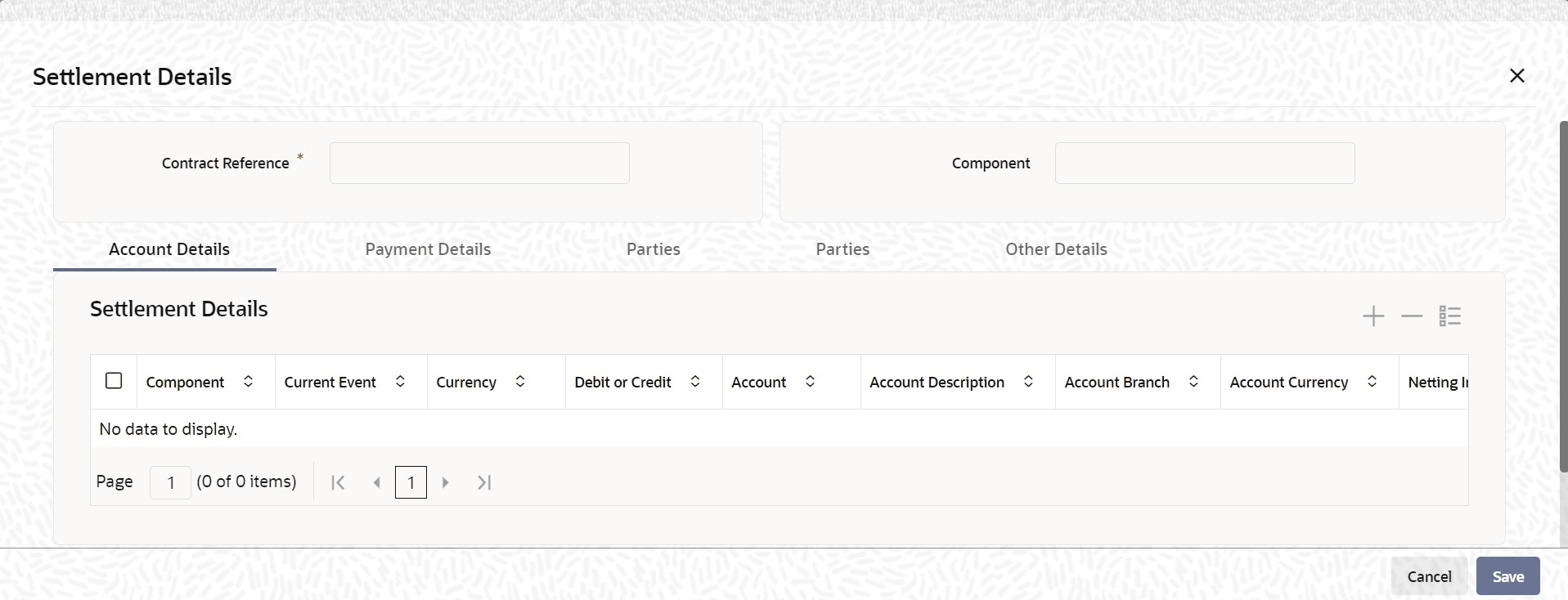

  15. On the Claim Lodgement screen, click the Settlement button.
    The system displays the settlement information for charges here. Current Event:
    Current event of settlements will be checked for the amount tags pertaining to the current event and will be unchecked for the amount tags not pertaining to the current event.

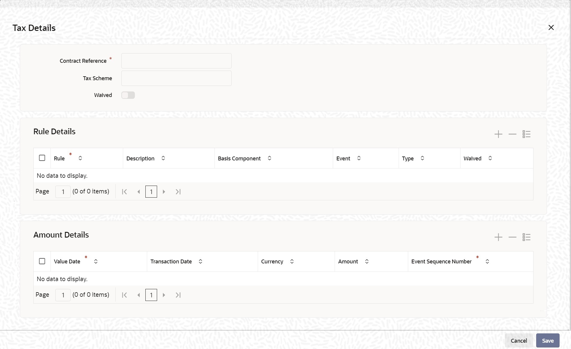

  17. On the Claim Lodgement screen, click the Tax button.
    The system displays the details of the tax configured in the screen.

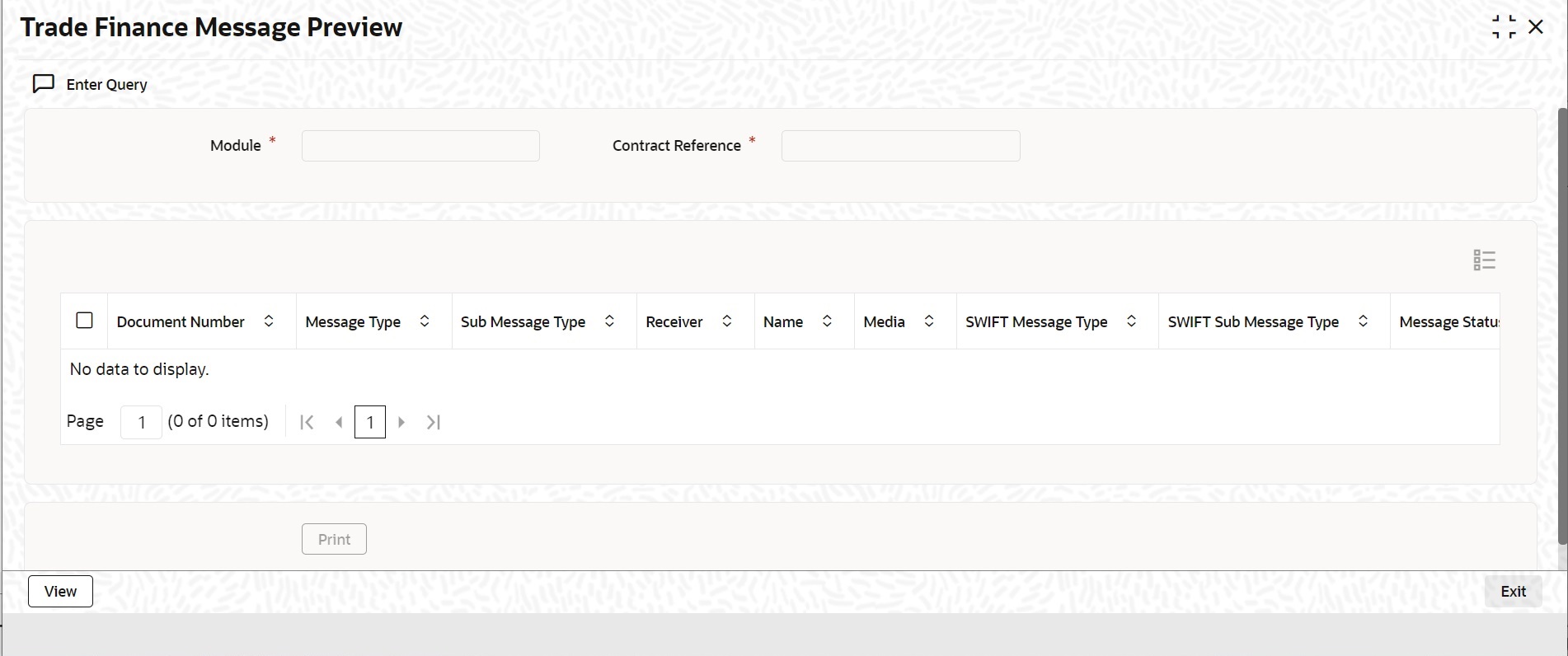

  18. On the Claim Lodgement screen, click the Message Preview button.
    You can view the message or advice generated in the screen.

    • Guarantee Not Advised Contract - Details:
    ISB Party's Customer Reference, Issuing bank, claim amount, currency will be validated for duplications. It will be configurable override.
    Issue date has to be lesser than branch date.
    Effective date has to be lesser than branch date.
    Claim amount has to be greater than Outstanding Amount.
    Outstanding Amount has to be Greater than Contract Amount.
    On Save, BDAV and GCLM Event will be triggered simultaneously.
    Processing of these contracts are restricted from LCDGUONL/LCDGUAMD /LCDGUTRF, but can be viewed from LCDGCLM/LCDGCLP.
    On Successful settlement, Outstanding amount will be shown as reduced by claim amount.
    Hold Operation is not supported. Main tab will be disabled for these contracts.
    Guarantee Not Advised and Parties tab only applicable for Guarantee Not Advised contracts.
