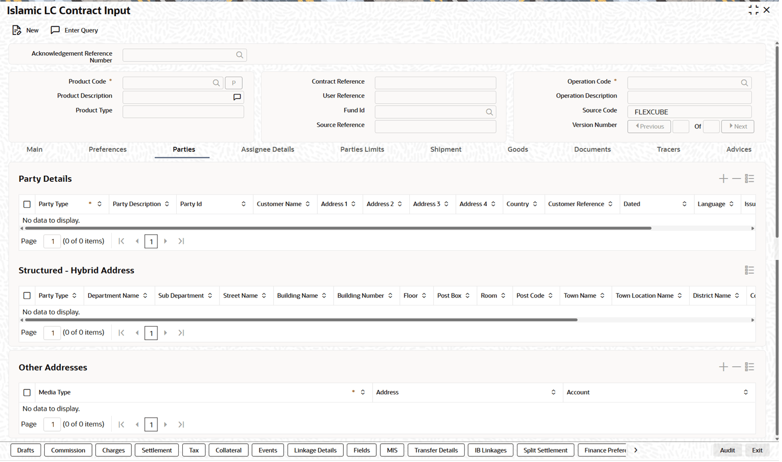

  1. On the Homepage, type LIDTRONL in the text box, and click the next arrow.
    Islamic LC Contract Input - Main screen is displayed.
    Figure 4-3 Islamic LC Contract Input
    Description of Figure 4-3 follows
    Description of "Figure 4-3 Islamic LC Contract Input"
  2. On the Main tab, specify the details as required.

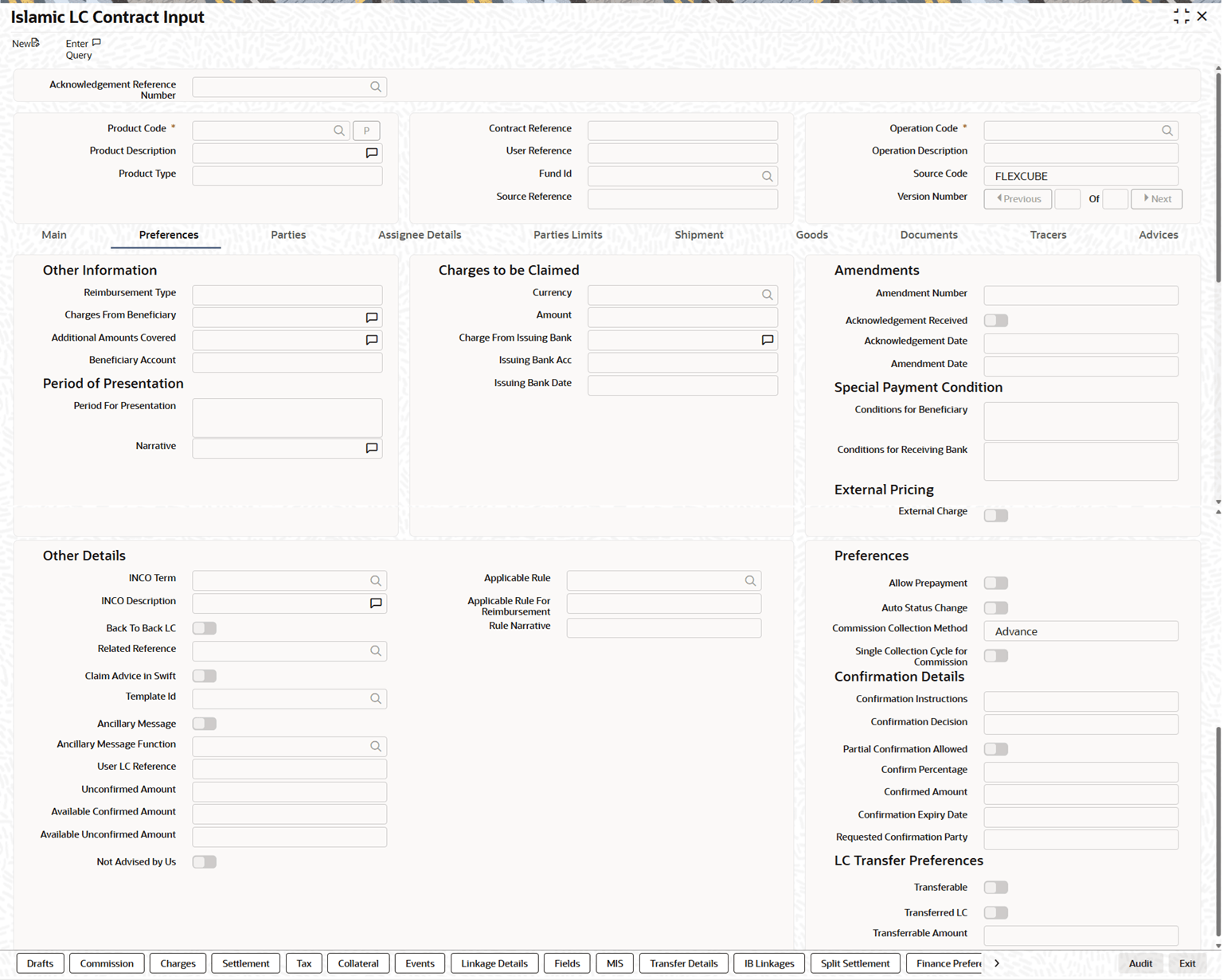

  3. On the Preferences tab, specify the details as required.
    The details that you specify in the fields of this screen are picked up for SWIFT messages.
    The SWIFT message that utilizes the information that you specify in this screen and the corresponding field of the SWIFT message which carries the input, has been listed in:
    The Islamic LC Contract Input - Preferences screen is displayed.
    Figure 4-4 Islamic LC Contract Input - Preferences
    Description of Figure 4-4 follows
    Description of "Figure 4-4 Islamic LC Contract Input - Preferences"
    Table 4-5 SWIFT Messages
    Field in Oracle Banking Trade Finance SWIFT Message Field of the SWIFT message
    Charges From Beneficiary MT700 Field 71B
    Additional Amounts Covered MT 700 & MT 740 Field 39C
    Period For Presentation MT 700 Field 48
    Charges From Issuing Bank MT 730 Field 71B
    Account For Issuing Bank MT 730 Field 57A
    Date MT 730 Field 32D
    For information on fields, refer the field description table below:
    Table 4-6 Preferences - Field Description
    Field Description
    Other Information Capture the following details:
    Reimbursement Type Specify the type of reimbursement. Choose the appropriate one from the drop-down list.
    Fee From Beneficiary The system displays the issuance fee from beneficiary.
    Additional Amounts Covered Specify the additional amount covered.
    Beneficiary Account Specify the account details of beneficiary.
    This field is read only.
    Fee to be Claimed Specify the following details:
    Currency Specify the currency of the charge.
    Amount Specify the charge amount.
    Fee From Issuing Bank Give a brief description of the fee.
    Issuing Bank Acc Specify the account from which charge should be collected.
    Issuing Bank Date Specify the date of charge collection.
    Amendments Specify the following details:
    Amendment Number The system displays the amendment number.
    Acknowledgement Received Check this box to indicate that the acknowledgment has received.
    Acknowledgement Date Specify the date on which the acknowledgment is received.
    Amendment Date The date of amendment is displayed here.
    Period for Presentation The period of presentation defined for the product - or calculated for the Islamic LC, as the case can/- is displayed in the ‘Period For Presentation’ field. You can change the default to suit the Islamic LC you are processing. The system uses the Expiry Date and the Last Shipment Date specified for the Islamic LC you are processing, and arrives at the period of presentation.
    For details, refer the heading ‘Specifying the Period of Presentation’ in chapter three, ‘Creating Products’, in the Islamic LC user Manual.
    Narrative Specify the details of date of document submission.
    Conditions For Beneficiary Specify the payment conditions for beneficiary.
    Conditions for Receiving Bank Specify the payment conditions for receiving bank.
    Other Details Specify the following details:
    INCO Term Specify the INCO term related to goods that are a part of the LC instrument. You can select one of the following values from the adjoining option list:
    • EXW - EX Works (…named place)
    • FCA - Free Carrier (…named place)
    • FAS - Free Alongside Ship (…named port of shipment)
    • FOB - Free On-Board (…named port of shipment)
    • CFR - Cost and Freight (…named port of destination)
    • CIF - Cost Insurance Freight (…named port of destination)
    • CPT - Carriage Paid to (…named place of destination)
    • CIP - Cost Insurance Paid (…named place of destination)
    • DAF - Delivered at Frontier (…named place)
    • DES - Deliver Ex Ship (…named port of destination)
    • DEQ - Delivered Ex Quay (…named port of destination)
    • DDU - Delivered Duty Unpaid (…named place of destination)
    • DDP - Delivered Duty Paid (…named place)
    DPU- Delivered at Place Unloaded
    INCO Description Once you choose the INCO Term, the documents and clause details will be displayed based on the maintenance for the chosen INCO term in the ‘INCO Terms Maintenance’ screen.
    However, if you change the INCO term, the document and clause details will be not be updated automatically. You will have to manually change them if required. However, the system will check whether the document and clauses details are the same as those defined in the ‘INCO Term Maintenance’ screen.
    The INCO term is picked up and displayed in field 45A of MT700.
    Back to Back LC Check this option if you want to link an export LC to an import LC. This field is applicable only for import LCs.
    If you check this option, you will have to specify the export LC which you want to link to the import LC in the ‘Reference Number’ field. All active and authorized export LCs of the same counterparty will be available for selection in the option list adjoining ‘Reference Number’. An export LC can be linked to only one import LC.
    Related Reference Number Specify the related reference number. Choose the appropriate one from the option list.
    While issuing a guarantee, the option list displays all valid bill of lading reference numbers and import LCs. Similarly, while issuing a back to back LC, the option list displays all valid export LCs maintained in the system. You can choose the appropriate one.
    Claim Advice in Swift Check this box to generate the charge claim advice in MT799 SWIFT format.
    This field is initially defaulted from product level. However, you can then check or uncheck it at the contract level.
    Template ID Specify the template ID related to MT799 message types from the option list.
    You can enter the values only if the ‘Claim Advice in Swift’ field is checked.
    Ancillary Message Check this box to generate MT 759 on contract authorization.
    Ancillary Message Function Specify the ancillary message function. Alternatively, you can select the ancillary message from the option list. The list displays all valid options maintained in the system. Ancillary Message Function is mandatory if ‘Ancillary Message’ is checked.
    External Pricing Specify the external pricing details:
    External Charge While booking a contract under a product for which ‘External Charges’ is enabled at product level, it defaults the same value for contract also which fetches external charges from external pricing and billing engine.
    User LC Reference System displays the Contract User Reference as the User LC Reference Number. The reimbursement Islamic LC, under which the bill is availed, and the Export Islamic LC linked to the bill, should contain the same ‘User LC Reference Number’.
    Unconfirmed Amount The system displays the current maximum unconfirmed Islamic LC amount. This amount is derived by deducting the confirmed amount from the maximum Islamic LC amount.
    Available Confirmed Amount The system displays the available confirmed portion of the maximum Islamic LC amount.
    Available Unconfirmed Amount The system displays the available unconfirmed portion of the maximum Islamic LC amount.
    Beneficiary Confirmation Required The system checks this box by default for Letters of Credit. This box is unchecked for ‘Guarantees’. You can operationally control the beneficiary confirmation process for an Islamic LC, but you cannot modify it after the first authorization.
    Preferences Set the preferences for the following fields.
    Allow Prepayment Select the Allow Prepayment check box to indicate that the customer can make a prepayment on the contract.
    This field is optional.
    Auto Status Change Select the Auto Status Change check box to indicate that the status can be changed automatically.
    Commission Collection Method This field indicates when the commission components of an Letter of Credit is collected. Commission on an LC can be collected in the following ways:
    • Advance - Select Advance to indicate that the commission components of the Letter of Credit should be collected at the time the Letter of Credit is initiated.
    • Arrears - Select Arrears to indicate that the commission components of the Letter of Credit should be collected on the maturity date of the Letter of Credit.
    This field is defaulted from product maintenance. User can change it at contract level.
    Single Collection Cycle for Commission
    When the flag is selected, on contract amount increase amendment, commission is collected till issuance commission good until date. For the last period, commission is collected till expiry date on pro rate basis.
    If the amendment commission good until date falls after expiry date, expired period commission is collected on expiry date EOD and accrual entries are triggered, if maintained.
    During closure/cancel, if any remaining commission exists from the expiry date to actual good until date, gets collected for amendment commission.
    Confirmation Details Specify the following Confirmation Details:
    Confirmation Instructions You can also specify the type of the confirmation instruction that should be sent to the advising/confirming bank if you are issuing the Islamic LC (whether Field 49 of MT 700 should be ‘Without’, ‘Confirm’, or ‘May add’).
    Confirmation Decision Confirmation decision will be display only field, which will be defaulted with the value as,
    • Confirm - When the ‘Operation’ of LC is ‘CNF’ and ‘ANC'
    • Silent Confirmation – When the operation of LC is SCF
    • Blank – When the operation of LC is other than CNF, ANC and SCF.
    Auto Status Change The system defaults the status of the check-box based on the product maintenance. However, you can modify this. If you check this box, the system picks up the contract during EOD operations for status processing. If you do not check this, the system will not consider the Islamic LC contract for automatic status processing.
    Partial Confirmation Allowed Check this box to confirm the partial amount. The remaining amount is confirmed after you receive the approval from the external agent. This field is initially defaulted from product level. However, you can then check or uncheck it at the contract level.
    Confirm Percentage Specify the percentage of Islamic LC Amount to be confirmed or silent confirmed. If percentage is not specified, the system will calculate the percentage based on the confirm Amount specified.
    Confirmation percentage will be defaulted to 100% during silent confirmation change of operation.
    Confirmed Amount Specify the amount to be confirmed or silent confirmed. If Confirm Amount is not specified, the system will calculate the confirmed amount based on the Confirm Percentage specified.
    During silent confirmation change of operation, confirm percentage and confirmed amount will be defaulted to 100% and LC oustanding amount respectively.
    Requested Confirmation Party Select the confirmation party type. You can select one of the following messages:
    • Advising Bank
    • Advise Through Bank
    • Confirming Bank
    LC Transfer Preferences You can set the following Preferences
    Transferable Check this option to indicate that the LC is transferable.
    Transferred LC Check this option for indicating the given LC is transferred LC.
    Transferable Amount This field displays the transferrable amount calculated using the LC amount.

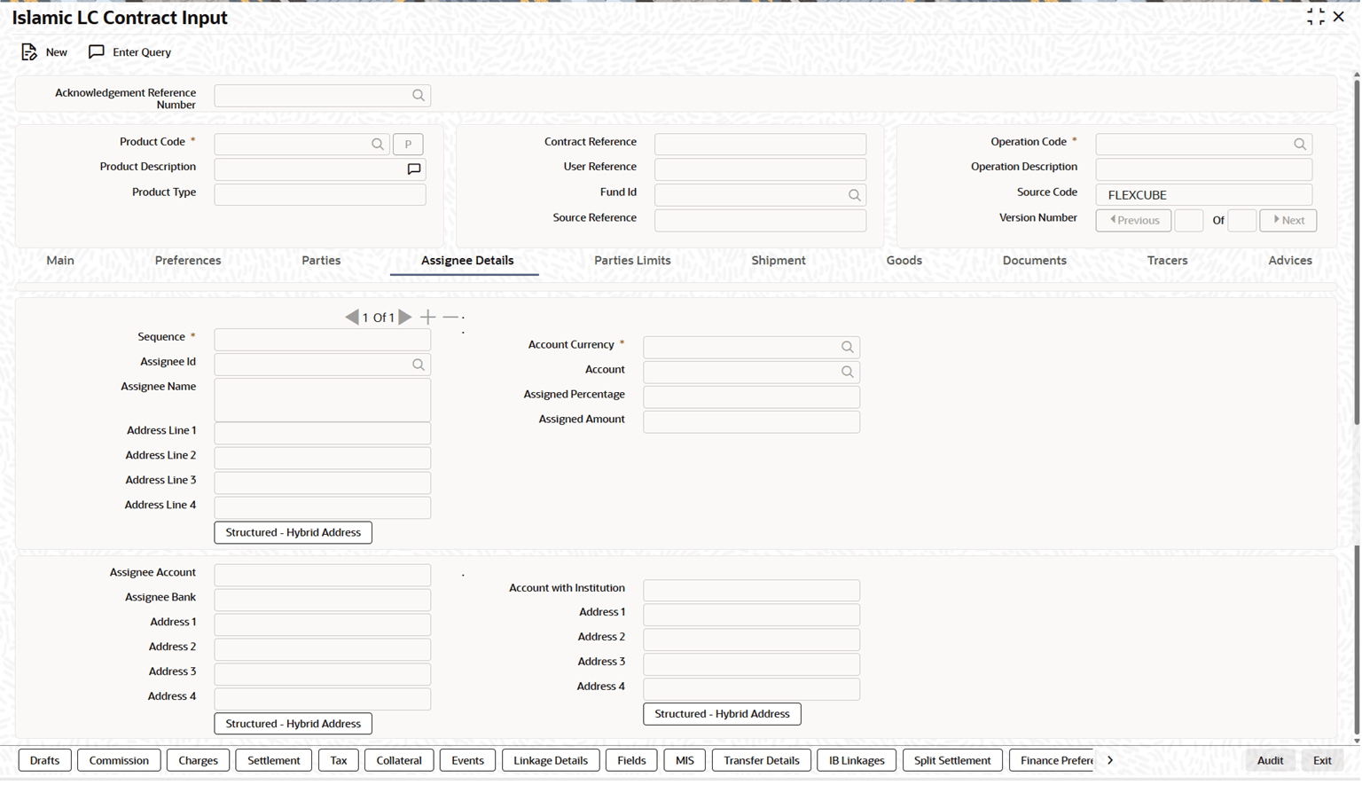

    Assignee Details Assignee can be walk-in customers, Bank customersand Third Party customers and Other Party Customers.. For Third Party Customers, user must maintain those parties in Third Party screen (TFDTPMNT) first. It will be possible to maintain assignee details in export type of letter of credit contract. Assignee can be added/modified/deleted in LC during internal amendment if Bill is not booked under LC with assignee details else system will provide appropriate error message. You can set the following assignee details:
    Sequence Sequence in which the assignee details are maintained. Value for this should be greater than or equal to zero. Sequence will not accept any decimal points. This should be unique.
    This field is mandatory.
    Assignee Id To maintain the party ID. This will fetch all the parties maintained in Other Party screen. It will not be possible to maintain the same assignee multiple times.
    Assignee Name Assignee name will be displayed based on the Assignee Id.
    Assignee name can be modified only Walk-in Customer.
    Assignee Address Line 1 Address Line 1 will be displayed based on the Assignee ID.Address Line 1 can be modified only for Walk in customer.
    Assignee Address Line 2 Address Line 2 will be displayed based on the Assignee ID.Address Line 2 can be modified only for Walk in customer.
    Assignee Address Line 3 Address Line 3 will be displayed based on the Assignee ID.Address Line 3 can be modified only for Walk in customer.
    Assignee Address Line 4 Address Line 4 will be displayed based on the Assignee ID.Address Line 4 can be modified only for Walk in customer.
    Account Currency Specify the currency of the account of the assignee.
    Account Specify the account to which the amount should be credited. This can be the account of the assignee with the bank if he is a customer of the bank. If he is not the customer of the bank then this can be the Nostro account of his bank maintained in the current bank. If Assignee is a bank customer ( Individual/Corporate/Bank customer) then Account LOV will provide customer accounts maintained in External Customer Account for the selected bank customer. If Assignee is a Third party or Walk in customer then Account LOV will display NOSTRO accounts for the currency.
    Assigned Percentage Specify the percentage of assignment to the assignee. Sum of assignee percentage should not exceed 100 percent.Either Assigned Percentage or Assigned Amount should be entered. If assigned percentage is provided and assigned amount is not provided, system will compute assigned amount based on assigned percent of contract amount.If assigned amount is provided and assigned percentage is not provided, system will compute assigned percentage based on assigned amount.
    If both assigned percentage and assigned amount is provided, system will compute assigned amount based on assigned percentage
    If both assigned percentage and assignment amount is not provided, system will provide error message.
    Assigned Amount Specify the amount of assignment to the assignee in LC currency. This should be greater than zero. Decimal points will be based on the LC currency.
    If assignment details are maintained for any product type other than export type, system will throw an error message. It will be possible to amend these values. If the amendment amount is reduced, there will be a validation to check whether it goes below from that used already in BC contract. If yes, system will throw an error.
    Also if the assignment details are already used in any BC contract, system will not allow to add or delete new assignees or amend party details such as Assignee Id, Account etc.
    Assignment details can be added through excel upload.
  4. On Islamic LC Contract Input screen, click Parties.
    The Parties screen is used to record the details related to all the parties involved in the Islamic LC. The documents, tracers and messages that are generated is sent to the parties concerned, based on the details you specify in this screen.
    The Party Details is displayed.
    Figure 4-5 Islamic LC Contract Input - Parties
    Description of Figure 4-5 follows
    Description of "Figure 4-5 Islamic LC Contract Input - Parties"
  5. On the Parties tab, specify the details as required.
    Table 4-7 Parties - Field Description
    Field Description
    Party Type The party type (beneficiary, accountee, applicant, advising bank, issuing bank, reimbursing bank, advice through bank, confirming bank).
    Party Description You can provide the description for the party type here.
    Party ID Specify a ‘Party ID’ for which you need to maintain. Alternatively, you can select the ‘Customer No’ from the List of Values Party Id.
    Third Party Customer details is also listed under List of Values Party Id.
    BIC Code appears next to the 'Customer No' only if the BIC code is mapped with that customer number.If the BIC Code is not mapped with that Customer Number, then the BIC Code will not appear next to the ‘Customer No’ in the adjoining option list.
    Customer Identification File Identification The CIF ID assigned to the party, if the party is defined as a customer in Oracle Banking Trade Finance. If the applicant (APP) or beneficiary (BEN) is not a customer of your bank, you can use a walk in customer ID.
    Name Enter the name of the Customer. The party name is 150 characters in length. However, please note that in the SWIFT messages that you generate only 35 characters is included.

    The parties involved in an Islamic LC depend upon the type of Islamic LC you are processing.
    The following table indicates the minimum number of parties required for the types of Islamic LC that you can process, refer to Islamic LC Processes
    Opting to amend Party Details during System Setup Oracle Banking Trade Finance offers you the facility to edit the party details that you capture in the Islamic LC Contract Online screen. You may exercise this option when setting-up the system at your bank
    If you opt for the edit facility, you can change the following party and credit details, captured for an Islamic LC, in the Islamic LC Contract Details screen:
    • The Name
    • The Mailing Address
    • The Credit Details
    Click on the adjoining, adjacent to the name, address and credit details fields, to view a popup window. In this screen, you can edit the party and credit details originally captured for the Islamic LC.
    Media Type The system defaults the media type. You can select a different medium from the adjoining option list.
    Address The system defaults the other address of the party. However, you can modify this.
    Account The system defaults the account number. However, you can modify this.

  6. On the Islamic LC Contract Details screen, click Assignee Details.
    Islamic LC Contract Details - Assignee Details screen is displayed.
    Figure 4-6 Islamic LC Contract Details - Assignee Details

  7. On Islamic LC Contract Details - Assignee Details screen, specify the details as required.
    Table 4-9 Assignee Details - Field Description
    Field Description
    Assignee Details Assignee can be walk-in customers, Bank customers and Third Party customers and Other Party Customers.. For Third Party Customers, user must maintain those parties in Third Party screen (TFDTPMNT) first. It will be possible to maintain assignee details in export type of letter of credit contract. Assignee can be added/modified/deleted in LC during internal amendment if Bill is not booked under LC with assignee details else system will provide appropriate error message. You can set the following assignee details:
    Assignee Id To maintain the party ID. This will fetch all the parties maintained in Third party maintenance screen and walkin customer along with Bank customer. It will not be possible to maintain the same assignee multiple times other than walkin customer.
    Structured - Hybrid Adress For more details on this button, refer Table 4-12 step.
    Account Specify the account to which the amount should be credited. This can be the account of the assignee with the bank if he is a customer of the bank. If he is not the customer of the bank then this can be the Nostro account of his bank maintained in the current bank. If Assignee is a bank customer ( Individual/Corporate/Bank customer) then Account LOV will provide customer accounts maintained in External Customer Account for the selected bank customer. If Assignee is a Third party or Walk in customer then Account LOV will display the NOSTRO accounts for the currency. If Assignee id is not provided then Account LOV will provide customer Accounts and Nostro Accounts. Either Account or Assignee account is mandatory.
    Assignee Account Indicates Account of Assignee which is Ultimate Beneficiary Account.
    If user provides Invalid Accounts then system will assign walkin customer to Assignee id and Nostro Account to Account field.
    Assignee Bank Indicates Bank of Assignee
    Address Line 1 Indicates Assignee Bank address details.
    Address Line 2 Indicates Assignee Bank address details.
    Address Line 3 Indicates Assignee Bank address details.
    Address Line 4 Indicates Assignee Bank address details.
    Structured - Hybrid Adress For more details on this button, refer Table 4-13 step.
    Account with Institution Indicates Account with Institution.
    Structured - Hybrid Adress For more details on this button, refer Table 4-14 step.
    Account details provided from External system to be mapped to Assignee Account field which is newly introduced.
    Assignee ID, Account and Assignee Account derivation will be as below:
    Table 4-10 Table Assignee Details
    Assignee Id Account Assignee Account Processing on Save
    Customer selected from LOV Customer Account selected from LOV Not provided Assignee account to be defaulted with Account on Save
    Not provided Customer Account selected from LOV Not provided Customer id to be derived and Assignee Account to be defaulted with Account
    Not provided Not provided Valid Customer account provided Customer id to be derived and Account to be defaulted with Assignee Account
    Not provided Not provided Invalid Customer account provided Walk in customer and Nostro account of the walk in customer to be defaulted

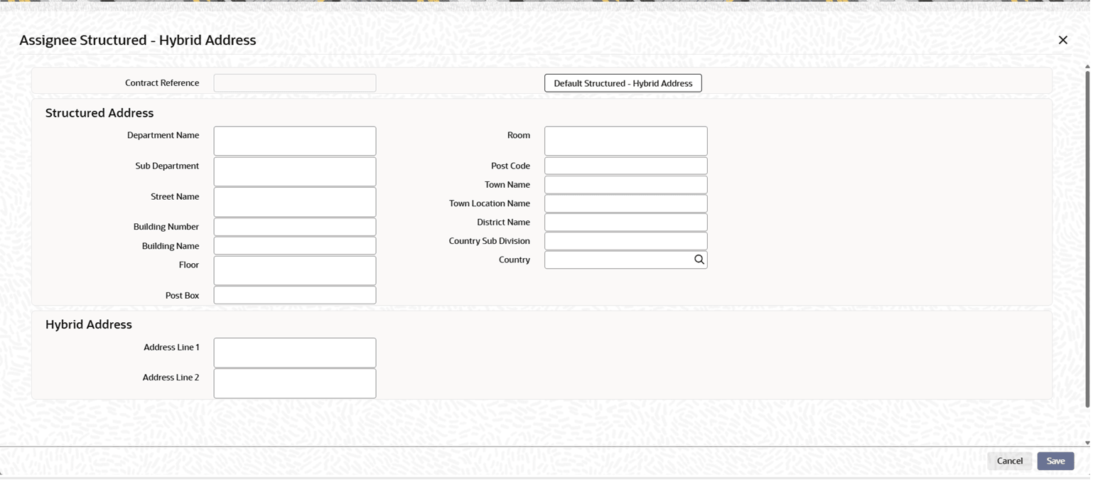

    1. On the Assignee Details tab, and under Assignee Id field, click the Structured - Hybrid Address button.
      The Assignee Structured - Hybrid Address is displayed.
      Figure 4-7 Assignee Structured - Hybrid Address
      On the Assignee Structured - Hybrid Address tab, specify the fields.
      Table 4-12 Assignee Structured - Hybrid Address - Field Description
      Field Description
      Contract Reference System displays Contract Reference.
      Structured Payment Address Specify the following payments releated details.
      Department Name Specify the Department Name of a customer.
      Sub Department Specify the Sub Department of a customer.
      Street Name Specify the Street Name of a customer.
      Building Number Specify the Building Number of a customer.
      Building Name Specify the Building Name of a customer.
      Floor Specify the Floor of a customer.
      Post Box Specify the Post Box of a customer.
      Room Specify the Room number of a customer.
      Post Code Specify the Post Code of a customer.
      Town Name Specify the Town Name of a customer.
      Town Location Name Specify the Town Location Name of a customer.
      District Name Specify the District Name of a customer.
      Country Sub Division Specify the Country Sub Division of a customer.
      Country Specify the Country Code of a customer.
      Hybrid Address Specify the following hybrid adress.
      Address Line1 Specify the Address of a customer.
      Address Line2 Specify the Address of a customer.
      Default Structured - Hybrid Address Click this button to make this address as default.

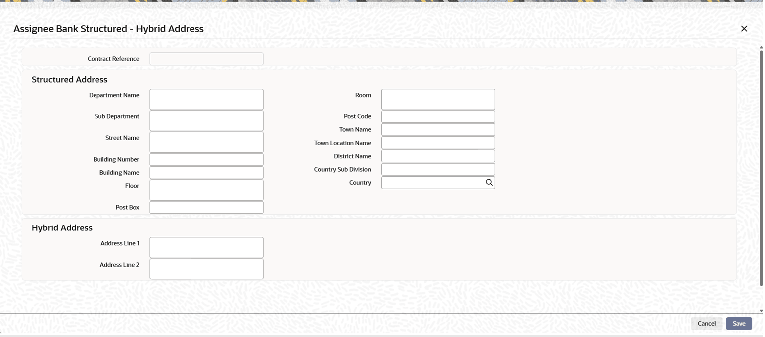

    2. On the Assignee Details tab, and under Assignee Account field, click the Structured - Hybrid Address button.
      The Assignee Bank Structured - Hybrid Address is displayed.
      Figure 4-8 Assignee Bank Structured - Hybrid Address
      On the Assignee Bank Structured - Hybrid Address tab, specify the fields.
      Table 4-13 Assignee Bank Structured - Hybrid Address - Field Description
      Field Description

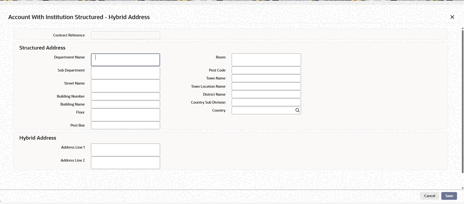

    3. On the Assignee Details tab, and under Account with Institution field, click the Structured - Hybrid Address button.
      The Account with Institution Structured - Hybrid Address is displayed.
      Figure 4-9 Account with Institution Structured - Hybrid Address
      On the Account with Institution Structured - Hybrid Address tab, specify the fields.
      Table 4-14 Account with Institution Structured - Hybrid Address - Field Description
      Field Description

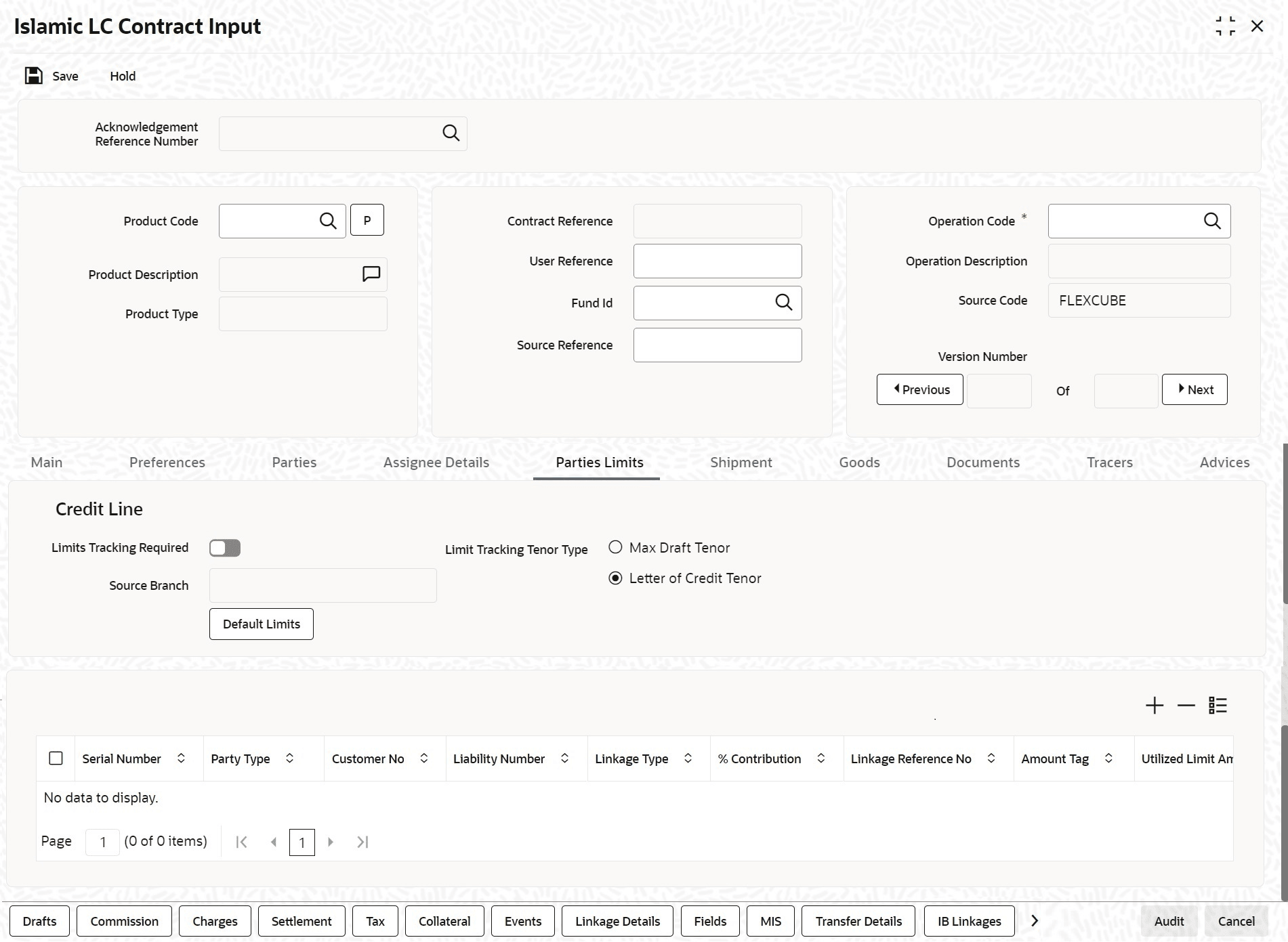

  8. On the Islamic LC Contract Details screen, click Parties Limits.
    Oracle Banking Trade Finance allows you to track the credit limits for customers who are parties to an Islamic LC contract. Using ‘Parties Limits’ tab, you can track the limits of multiple credit lines in an Islamic LC contract.
    Islamic LC Contract Input - Parties Limits screen is displayed.
    Figure 4-10 Islamic LC Contract Input - Parties Limits
    Description of Figure 4-10 follows
    Description of "Figure 4-10 Islamic LC Contract Input - Parties Limits"
  9. On Islamic LC Contract Details - Parties Limits screen, specify the details as required.
    You can add new records or delete defaulted record for limit before saving the details.
    Table 4-15 Parties limits - Field Description
    Field Description
    Limits Tracking Required Check this box to indicate that limit tracking is required for the parties to the Islamic LC contract. If you check this box, the system will let you set the limits for multiple credit lines in the contract. If you do not check this box, the system will not track the parties’ limits.
    On checking this box, the system enables ‘Default’. You can use this option to get the default values for the parties in the credit lines.
    • Letter of Credit tenor
    • Max Draft Tenor
    Default Limits Click the Default Limits button. The system displays the default values for the parties limits
    Limit Tracking Tenor Type Choose the limit tracking tenor type from the following options:
    Serial Number On click of Save button, the system displays the serial number.
    Party Type Specify the party type of the counter party of the contract whose credit limits need to be tracked.
    However, you need to make sure that the mandatory party details have been maintained under ‘Parties’ tab of the screen.
    When you add another row to the list, you can manually select the party type as required. If you leave it blank, the system will automatically update the party type when you save the contract.
    Customer No Specify the customer number of the party whose credit limits need to be tracked. The option list displays the customer numbers of all the parties selected under ‘Parties’ tab.Specify the ‘Customer No’ for which you need to maintain. Alternatively, you can select ‘Customer No’ from the adjoining option list also.
    BIC Code appears next to the 'Customer No’ only if the BIC code is mapped with that customer number. If the BIC Code is not mapped with that Customer Number, then the BIC Code will not appear next to the ‘Customer No’ in the adjoining option list.
    You need to make sure that the customer number corresponds to the party type selected above. If the customer number and party type do not match, the system displays an error.
    Liability Number The system displays multiple liabilities that are attached to the Customer.
    Linkage Type Specify the linkage type. The drop-down list displays the following options:
    • Facility (Credit Line)
    • Collateral Pool
    • Collateral
    • Local Collateral
    Choose the appropriate one.
    Linkage Reference No Specify the reference number that identifies the facility, collateral pool or collateral. The option list displays all valid facilities and collateral pools specific to the liability. Choose the appropriate one.
    In case you choose the same linkage reference for more than one record in the list, the system displays an override message. You may choose to cancel or proceed with the selection.
    You can select Linkage Reference Number and JV Parent manually.
    % Contribution Specify the proportion of limits to be tracked for the credit line or collateral pool for the customer. When you click ‘Default’ the system defaults the percentage of contribution maintained under ‘Customer Maintenance’ screen.
    It is mandatory to indicate the percentage of contribution if the party is a customer.
    Amount Tag Specify the amount tag. The system tracks the limits for non joint venture customers based on the amount tag. The amount tags applicable to export and import Islamic LC contracts are listed below:
    Amount tags applicable to Export Islamic LC:
    • Liability Amount
    • Confirmed Amount
    • Unconfirmed Amount
    • Silent Confirmation Amount
    Amount tags applicable to Import Islamic LC:
    • Liability Amount
    • Undertaking Amount
    • Non Undertaking Amount
    • Liability Minus Margin
    Choose the appropriate one based on the type of Islamic LC contract. If you do not specify the amount tag, the system will track the limits based on the liability amount and facility.
    In ‘Parties Limit’ tab choose ‘Liability Minus Margin’ from the ‘Amount Tag’ the ‘Limit Amount’ is computed as ‘Current Liability Amount’ minus the ‘Margin Amount’ In ‘Parties Limit’ tab choose ‘Silent Confirmation Amount’ from the ‘Amount Tag’ the amount computed is ‘Silent Confirmation Amount’ which is the Liability Outstanding Amount.
    The system verifies the amount tag against the product type. If you choose an amount tag, which is not supported by the product type, the system displays an error message.
    Limit Amount When you click ‘Default’, the system defaults the amount tracked for each credit line. In case of other customers, the amount is derived based on the amount tag specified above.
    You can add more rows to the list of credit lines using add. Similarly, you can remove a selected row from the list using delete.
    Once you have specified the details, save the contract. In case the limit for a credit line has been completely exhausted, the system displays a configurable override message. If you have not used ‘Default’ while specifying the parties’ limit details, the system will automatically default the details and track the limits based on that.
