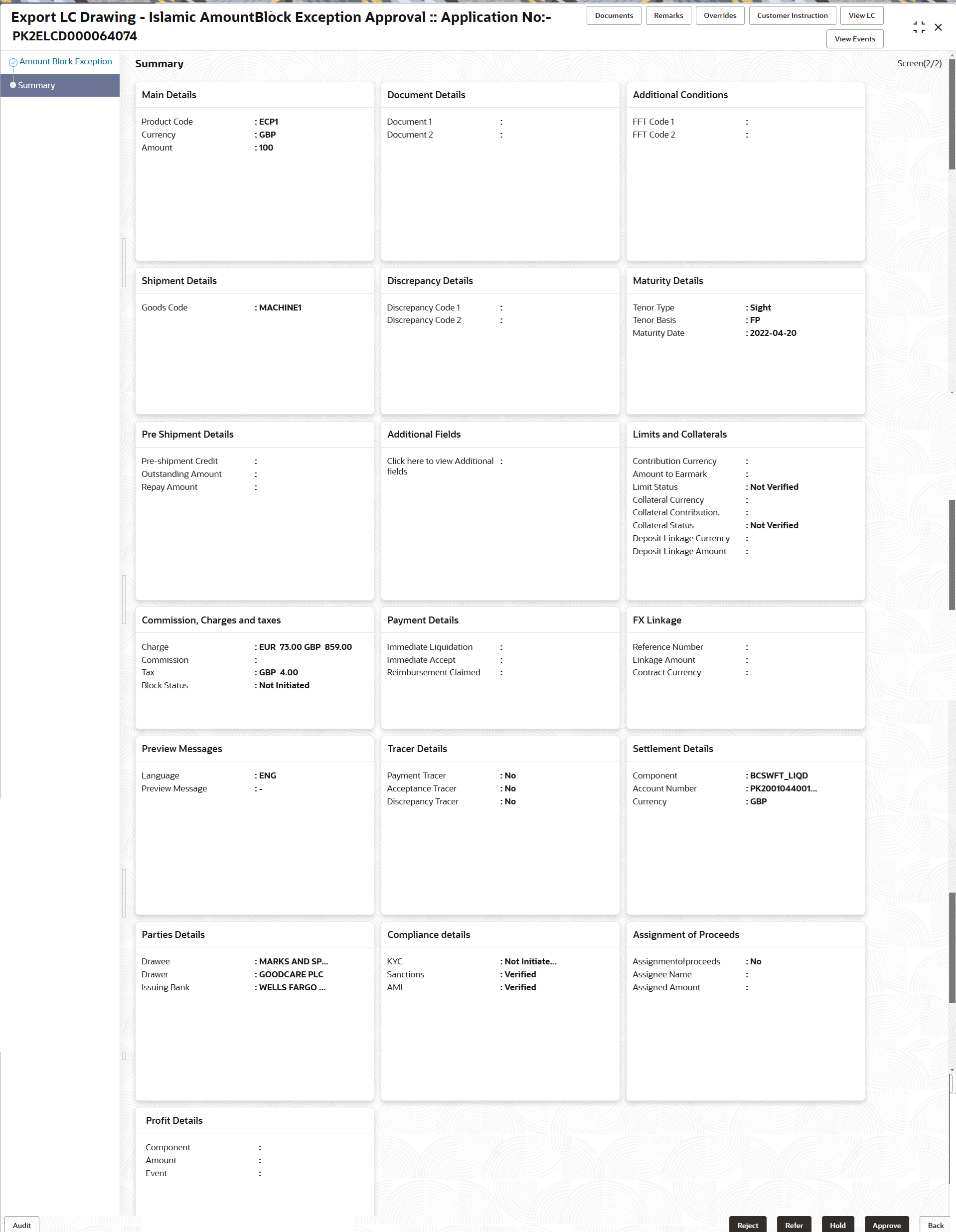

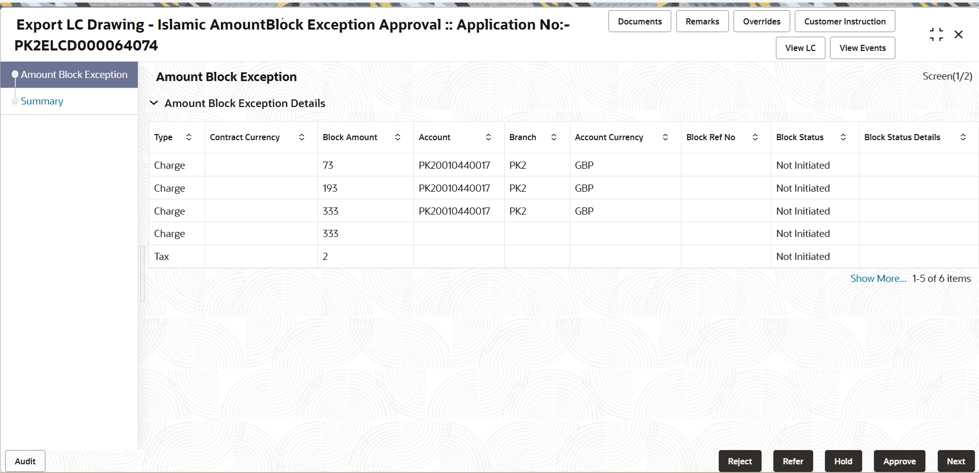

Amount Bock Exception
This section will display the amount block exception details.
Summary
- Main Details - User can view the application and LC details.
- Documents Details- User can view the Document details.
- Additional Conditions - User can view the additional conditions.
- Shipment Details - User can view shipment details.
- Discrepancy Details - User can view the discrepancy noted for the current LC drawing.
- Maturity Details - User can view the maturity details.
- Pre Shipment Details - User can view pre shipment details.
- Additional Fields - User can view pre shipment details.
- Limits and Collaterals - User can view the Additional Fields details.
- Commission, Charges and Taxes - User can view the charge details.
- Payment Details - User can view the payment details.
- FX Linkage - User can view the FX linkage details.
- Preview Messages - User can view the preview of the message.
- Tracer Details - User can view the tracer details.
- Settlement Details - User can view the settlement details.
- Parties Details - User can view the party details like beneficiary, advising bank etc.
- Compliance Details - User can view compliance details. The status must be verified for KYC and to be initiated for AML and Sanction Checks.
- Assignment of Proceeds - User can view the details of assignment of proceeds.
- Profit Details - User can view the interest details.
- Click Approve. to approve thw export booking amount bolck exception check.
For more information on Action Buttons, refer to the field description table below.
