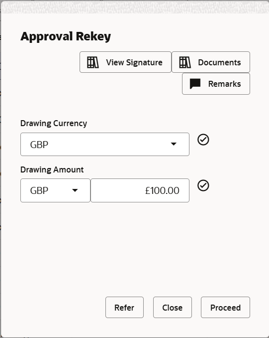

Click Edit to approve the task.The Approval Re-Key pop-up screen appears.
Figure 2-39 Approval Re-Key
Description of the illustration approvalrekey.pngFor non online channel, application will request approver for few critical field values as an authorization step. If the values captured match with the values available in the screen, system will allow user to open the transaction screens for further verification. If the re-key values are different from the values captured, then application will display an error message.
- Open the task and re-key some of the critical field values from the request in
the Approval Re-Key screen.Some of the fields below will dynamically be available for re-key.:
- Drawing Currency
- Drawing Amount

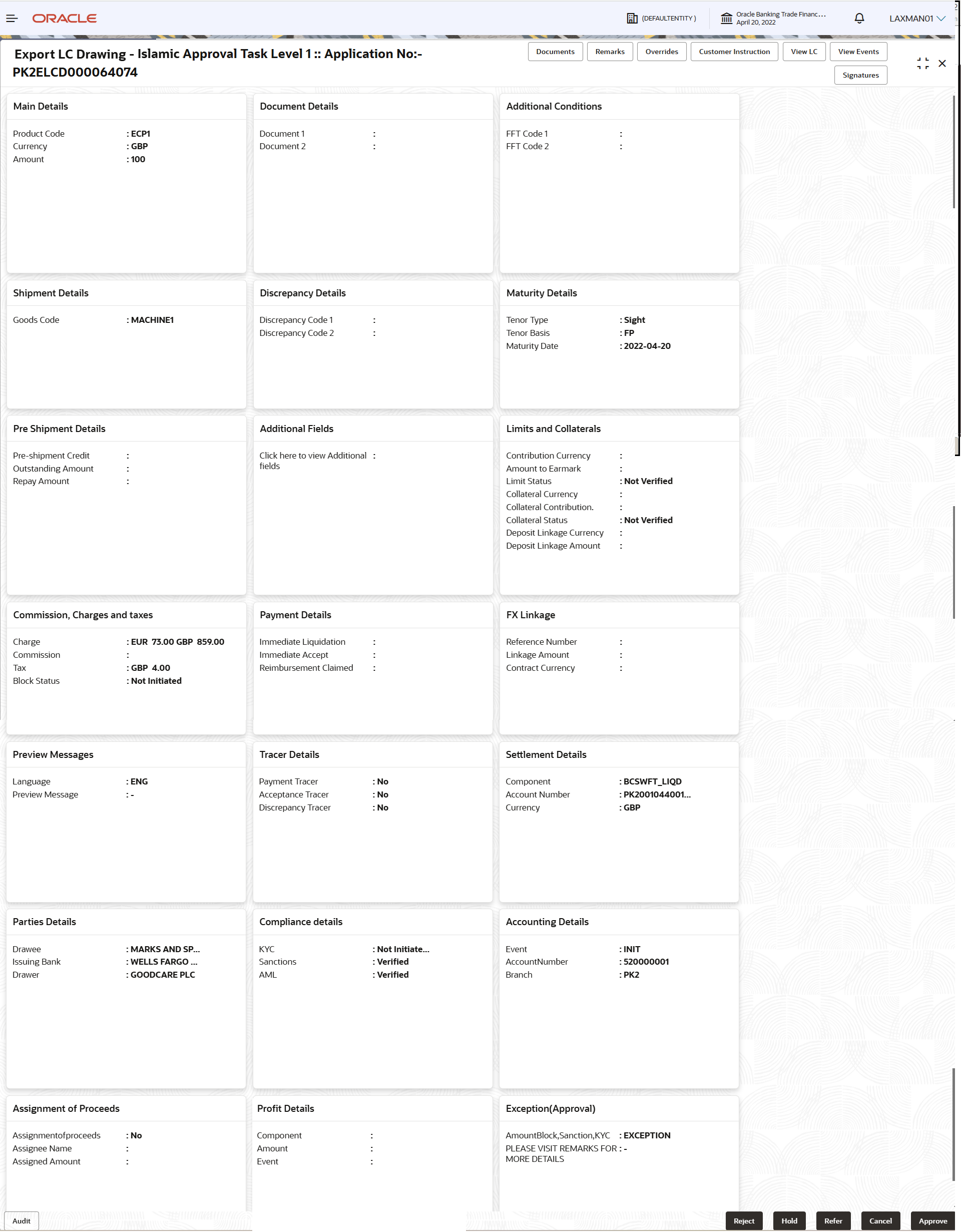

- Click Proceed to proceed for the approval.The Approval Summary screen appears. The user can view the Summary tiles which displays list of important fields with values.
- Click each tile to drill down from summary tiles into respective data segments
to verify the details of all fields under the data segment.
The user can simulate/recalculate charge details and during calling the handoff, if handoff is failed with error the OBTFM displays the Handoff failure error during the Approval of the task.Tiles Displayed in Summary:- Main Details - User can view the application and LC details.
- Documents Details- User can view the Document details.
- Additional Conditions - User can view the additional conditions.
- Shipment Details - User can view shipment details.
- Discrepancy Details - User can view the discrepancy noted for the current LC drawing.
- Maturity Details - User can view the maturity details.
- Pre Shipment Details - User can view pre shipment details.
- Limits and Collaterals - User can view limits and collateral details.
- Commission, Charges and Taxes - User can view the charge details.
- Payment Details - User can view the payment details.
- Preview Messages - User can view the preview of the message.
- FX Linkage - User can view the FX linkage details
