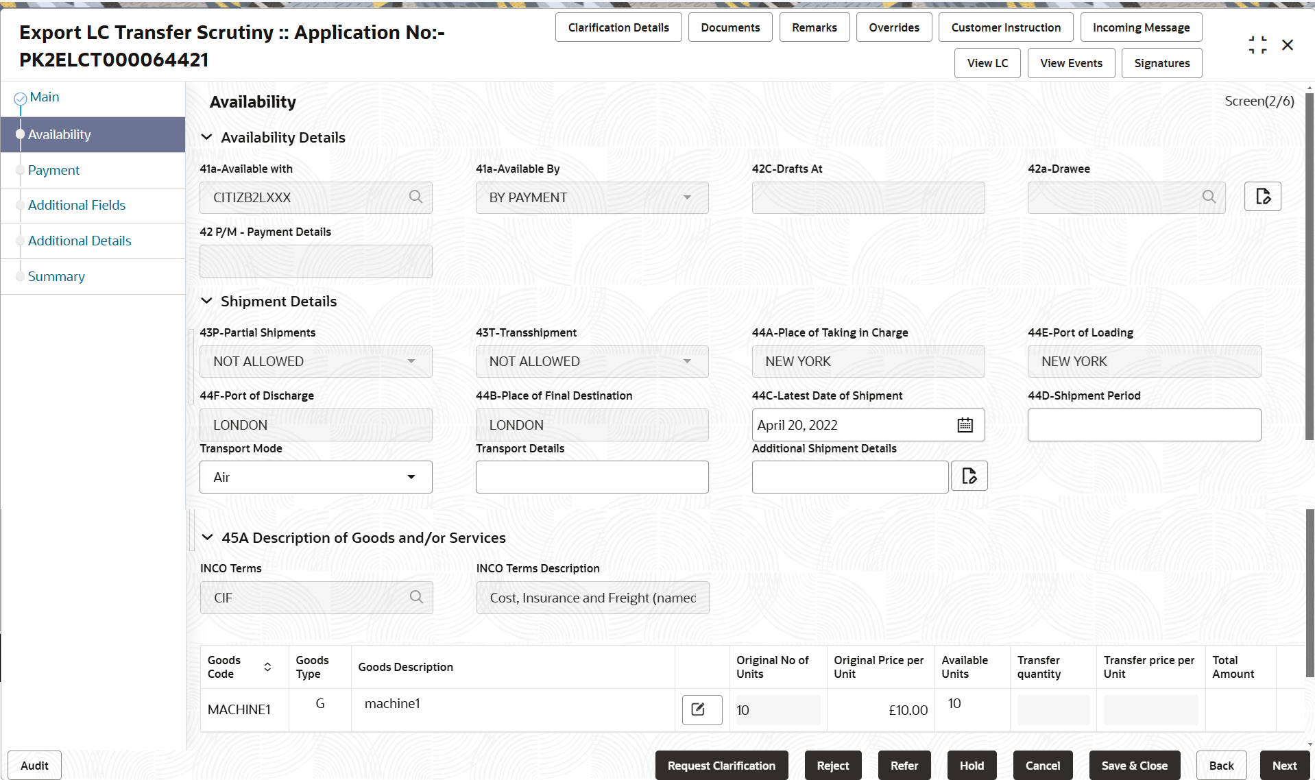

- On Availability screen, specify the fields.
Figure 2-9 Availability
Description of the illustration scrutinyavailability.pngFor more information on fields, refer to the field description table below.

Field Description Availability Details Specify the availability details based on the description of following table. Available with This field identifies the bank with which the credit is available. Online Channel - Read only
Non Online Channel - It is an input field and user can enter the details.
- If the LC is restricted to any particular bank, search the bank with SWIFT code (BIC) or Bank Name.
On selection of the record if SWIFT code is available, then SWIFT code will be defaulted. If SWIFT code is not available then the bank's name and address gets defaulted.- If the LC is not restricted to any bank, provide free text - (YOURSELVES, WITH ANY BANK etc.).
In case of Online channel, this field is read only. System auto-populates the detail. User cannot change the populated value.
Available By This field identifies how the credit is available. Online Channel – Read-only. In case of online request, system should auto-populate the details. User cannot change the populated value.
This field displays the value of ‘Available By’ as per the issued LC. Online Channel - Read only
Select one of the following values from drop down, if required.
The options are:
- BY ACCEPTANCE
- BY DEF PAYMENT
- BY MIXED PAYMENT
- BY NEGOTIATION
If BY DEF PAYMENT and BY MIXED PAYMENT option is selected, 42 P/M - Payment Details field gets enabled.Drafts At This field specifies the tenor of drafts to be drawn under the documentary credit.
Drawee This field is enabled if Drafts At field has a value. Click Search to search and select the Drawee bank (Advising bank or Confirming bank).
- Search the bank with SWIFT code (BIC) or Bank Name.
On selection of the record if SWIFT code is available, then SWIFT code will be defaulted, if SWIFT code is not available then the bank's name and address to be defaulted.
In case of online request, this field is read only. System auto-populates the detail. User cannot change the populated value.
Payment Details This field is applicable if, Available By field has value as BY MIXED PAYMENT or BY DEF PAYMENT and Drafts At field does not have value. In case of online request, system should auto-populate the details. User cannot change the populated value.
Shipment Details User can change the values available in the fields based on the description of following table. Partial Shipments Read only field. This field specifies whether or not partial shipments are allowed under the documentary credit.
Partial shipment details is auto-populated from the underlying Transfer LC.The options are:
- Allowed
- Conditional
- Not Allowed
Transshipment Read only field. Transshipment details is defaulted from the underlying Transfer LC.
This field specifies whether or not transshipment are allowed under the documentary credit.
The options are:
- Allowed
- Conditional
- Not Allowed
Place Of Taking In Charge Read only field. Place of taking in charge value is defaulted from the underlying Transfer LC.
The field specifies the details of place of taking in charge (in case of a multi-modal transport document), the place of receipt (in case of a road, rail or inland waterway transport document or a courier or expedited delivery service document), the place of dispatch or the place of shipment to be indicated on the transport document for non-online channel.
Port Of Loading Read only field. Port of loading details is defaulted from the underlying Transfer LC.
This field specifies the port of discharge or airport of destination to be indicated on the transport document.
Port Of Discharge Read only field. Port of discharge details is defaulted from the underlying Transfer LC.
This field specifies the port of discharge or airport of destination to be indicated on the transport document.User cannot change the populated value.
Place Of Final Destination Read only field. Place of final destination details is defaulted from the underlying Transfer LC.
This field specifies the final destination or place of delivery to be indicated on the transport document.Latest Date Of Shipment Indicates the latest date for loading on board/dispatch/taking in charge. Latest date of shipment is auto populated from underlying Export LC. The user can change the date.
This field is alternate to Shipment Period. Latest date of shipment or shipment period must have value and if both the fields has values, application will display an error message.Latest shipment date should be on or before expiry date and should not be before the branch date.
Shipment Period Indicates the details of Shipment. Shipment period is auto populated from the underlying Transfer LC. The user can change the shipment period.
This field is alternate to Latest Date Of Shipment.. Latest date of shipment or shipment period must have value and if both the fields has values, application will display an error message.Transport Mode Transportation mode is auto populated from underlying Export LC.. The options are:- Air
- Sea
- Road
- Rail
- Multimodal
- Other
The user can change the details.
Transport Details The transportation details of shipment is auto populated from underlying Export LC. The user can change the details.
Additional Shipment Details Specify the additional details of shipment, if any. Description of Goods and/or Services Specify description of goods and/or services based on the description in the following table: This field contains a description of the goods and/or services of the issued LC and can be changed if required.
INCO Terms The INCO terms from the document received details is auto populated from the underlying Export LC. INCO Terms Description The description of the INCO term based on the selected INCO Terms code is auto populated from the underlying Export LC. The user can click + to add multiple descrption of goods and services.
Goods Code Goods Details is defaulted from the underlying LC and user can change the values. Click Search to search and select the goods code. from the look-up.
Once you select goods code, value will default in Goods Type and Goods Description.
Goods Type The goods type is defaulted from the underlying LC and user can change the values. Goods Description The goods description is defaulted from the underlying Transfer LC and user can change the values. Original No of Units The system displays the original number of units from the underlying Transfer LC. Original Price per Unit The system displays the original price per unit from the underlying Transfer LC. Available Units The system displays the available units of the goods. User should not be allowed to update this. Transfer quantity Specify the number of units. The system displays an error message if the value for units transferred is more than the units available. Transfer Price per Unit Specify the price per unit is not more than the original price per unit. Total Amount System calculates the total price. In case of online request, the system should populate the total amount from incoming request. System validates that the total amount is equal to the value of the transaction (LC/Collection).
Action Click Edit icon to edit the goods code. Click Delete icon to delete the goods code.
