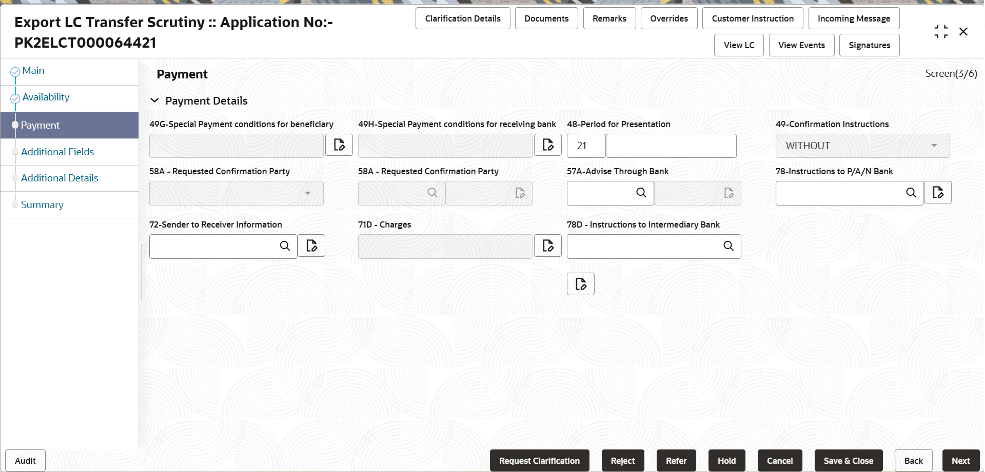

2.3.3 Payment
This topic provides the systematic instructions to initiate the Payment in Scrutiny stage of Export LC Transfer request.
- On Scrutiny - Payment screen, specify the fields.
Figure 2-10 Scrutiny - Payment
Description of the illustration scrutinypayment.pngFor more information on fields, refer to the field description table below.
Table 2-12 Payment - Field Description
Field Description Payment Details Special Payment conditions for beneficiary Special Payment conditions for beneficiary is defaulted from the underlying Transfer LC. The user can specify the details, if any special payment condition has to be provided to beneficiary, in case of Non - Online channel.
In case of Online channel, system auto-populates the details. User cannot change the populated value.
Special Payment conditions for receiving bank Special Payment conditions for receiving bank is defaulted from the underlying Transfer LC. The user can specify the details, if any special payment condition has to be provided to receiving bank, in case of Non - Online channel.
Period for Presentation Specify the event name in text along with the number of days in number, if the period of presentation is based on any event other than shipment, in case of non-online channel. In case of Online channel, this field is read only.
Confirmation Instructions Select the confirmation instruction for the LC from the available list, in case of non-online channels. The options are: - CONFIRM
- MAY ADD
- WITHOUT
Applicable only if field 49 - confirmation instruction is 'confirm' or 'may add'. You can search through LOV, Party type with banks should only be displayed in LOV. The system should display the- SWIFT code (if available)
- Name and address of the bank
In case of Online channel, this field is read only. System auto-populates the detail. User cannot change the populated value.
Requested Confirmation Party Click Search to search and select the appropriate requested confirmation party, in case of online and non-online channels. This field is enabled and mandatory, if the Confirmation Instructions is CONFIRM orMAY ADD.Note:
This field is applicable only for LC Type - Confirmed LC.In case of Online channel, this field is read only. System auto-populates the detail. User cannot change the populated value.
Advise Through Bank Click Search to search and select the advise through bank, in case of Non - Online channel. Party type with banks must be displayed in look-up. - SWIFT code (if available)
On selection of the record if SWIFT code is available, then SWIFT code will be defaulted. If SWIFT code is not available then the bank's name and address to be defaulted.
In case of online request, system should auto-populate the details. User cannot change the populated value.
Instructions to P/A/N Bank Click Search to search and select the instructions to P/A/N Bank, in case of Non - Online channel. In case of Online channel, update the details received.
Sender to Receiver Information Click Search to search and select the sender to receiver information (FFT), in case of Non - Online channel. In case of Online channel, update the details received.
Charges Specify the charges details(FFT), in case of non-online channel. In case of Online channel, this field is read only.
Instructions to Intermediary Bank Click Search to search and select the instructions to intermediary bank. - Click Next.The task will move to next data segment. For more information refer Additional Fields.
