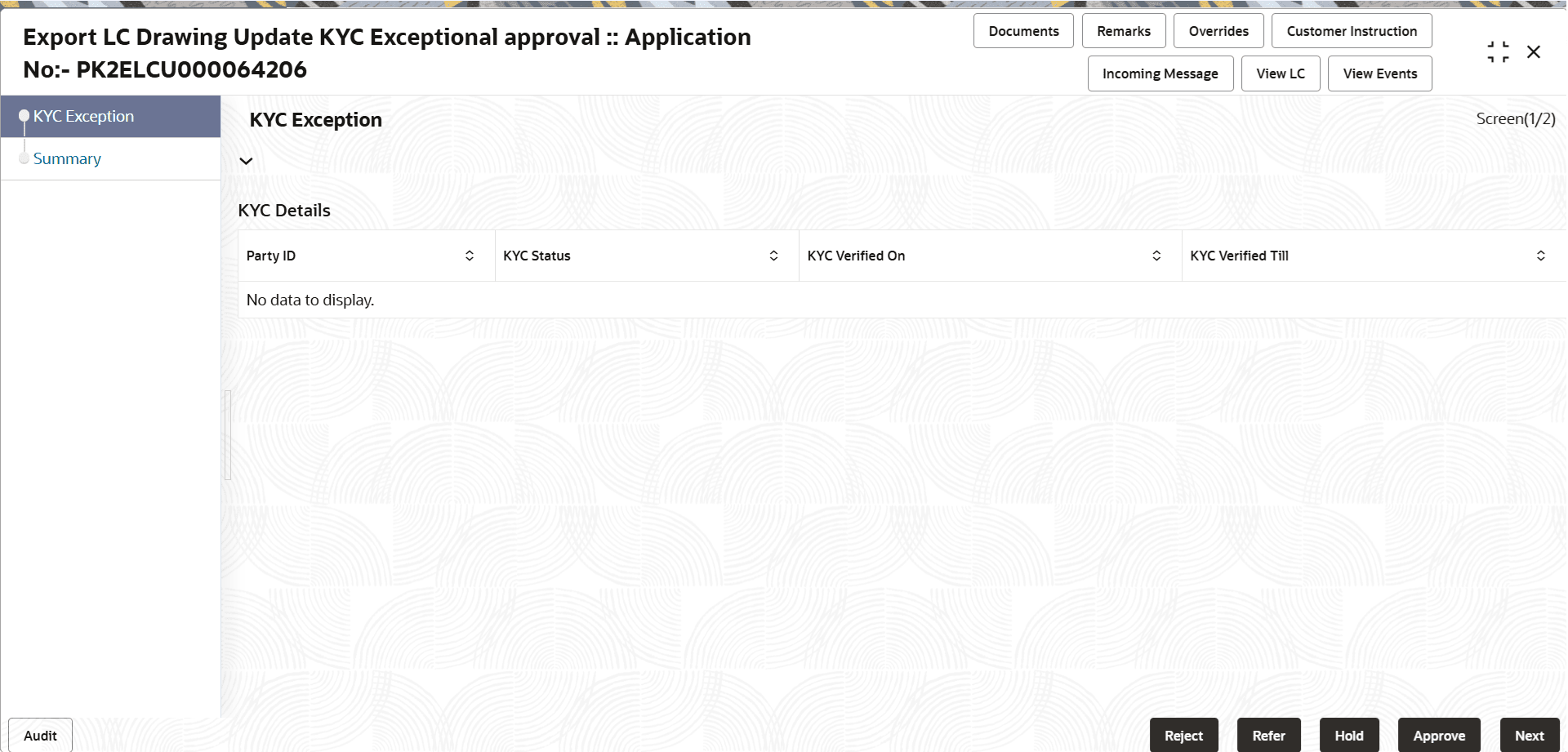

Exception - Know Your Customer (KYC)
As part of KYC validation, application will check if necessary KYC documents are available and valid for the applicant. The transactions that have failed KYC due to non-availability / expired KYC verification will reach KYC exception stage.
  1. Log in into OBTFPM application, KYC exception queue. KYC exception failed tasks for Trade Finance transactions will be listed in your queue.
  2. Open the task, to see summary tiles that display a summary of available updated fields with values.
    User can pick up a transaction and do the following actions:
    Approve
    • After changing the KYC status in the back end application (outside this process).
    • Without changing the KYC status in the back end application.
    • Reject (with appropriate reject reason).

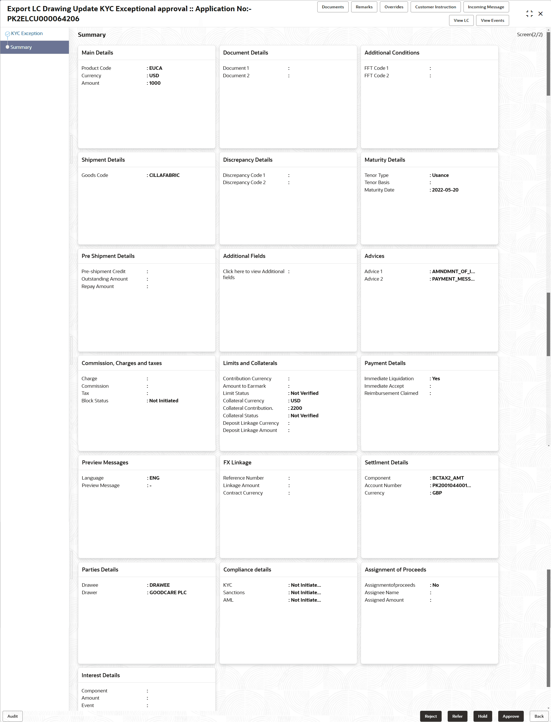

Summary
Figure 2-41 Know Your Customer (KYC) Exception
Description of kycexceptionsummary.png follows
Tiles Displayed in Summary:
  • Main Details - User can view the application and LC details.
  • Documents Details- User can view the Document details.
  • Additional Conditions - User can view the additional conditions.
  • Shipment Details - User can view shipment details.
  • Discrepancy Details - User can view the discrepancy noted for the current LC drawing.
  • Maturity Details - User can view the maturity details.
  • Pre Shipment Details - User can view the pre shipment details.
  • Advices - User can viewthe advices details.
  • Limits and Collaterals - User can view limits and collateral details.
  • Commission, Charges and Taxes - User can view the charge details.
  • Payment Details - User can view the payment details.
  • Preview Messages - User can view the preview of the message.
  • FX Linkage - User can view the FX linkage details.
  • Settlement Details - User can view the settlement details.

View LC Click to view the latest LC values displayed in the respective fields. All fields displayed in LC details section are read only fields..
Reject On click of Reject, user must select a Reject Reason from a list displayed by the system.
Reject Codes are:
  • R1- Documents missing
  • R2- Signature Missing
  • R3- Input Error
  • R4- Insufficient Balance/Limits
  • R5 - Others
Select a Reject code and give a Reject Description.
This reject reason will be available in the remarks window throughout the process.
Refer Select a Refer Reason from the values displayed by the system.
User can refer the task back to the Data Enrichment user. User must select a Refer Reason from the values displayed by the system. Refer Codes
Refer Codes are:
  • R3- Input Error
  • R5 - Others
Hold The details provided will be saved and status will be on hold.User must update the remarks on the reason for holding the task.
This option is used, if there are any pending information yet to be received from applicant.
Approve On approve, application must validate for all mandatory field values, and task must move to the next logical stage.
Back Task moves to previous logical step.
