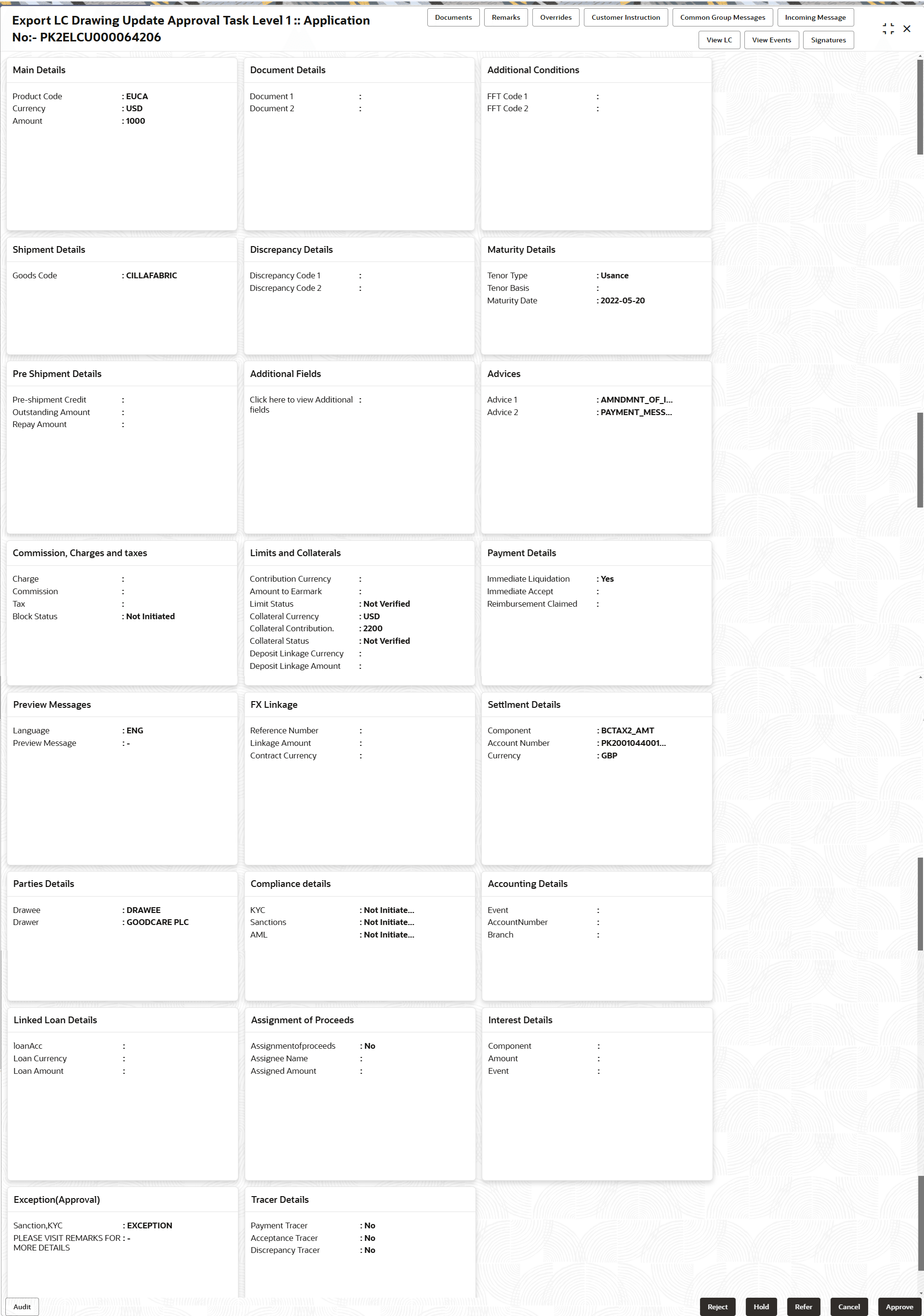

    The Approval Summary screen appears. The user can view the Summary tiles which displays list of important fields with values.
  5. Click each tile to drill down from summary tiles into respective data segments to verify the details of all fields under the data segment.

    Tiles Displayed in Summary:
    • Main Details - User can view the application and LC details.
    • Documents Details- User can view the Document details.
    • Additional Conditions - User can view the additional conditions.
    • Shipment Details - User can view shipment details.
    • Discrepancy Details - User can view the discrepancy noted for the current LC drawing.
    • Maturity Details - User can view the maturity details.
    • Additional Fields - User can view the additional fields, if any.
    • Advices - User can view the advices details.
    • Pre Shipment Details - User can view pre shipment details.
    • Limits and Collaterals - User can view limits and collateral details.
    • Commission, Charges and Taxes - User can view the charge details.
    • Payment Details - User can view the payment details.
    • Preview Messages - User can view the preview of the message.
    • FX Linkage - User can view the FX linkage details.
    • Settlement Details - User can view settlement details.
    • Parties Details - User can view party details like applicant, advising bank etc.
    • Compliance - User can view compliance validation response. The status must be verified for KYC and to be initiated for AML and Sanction Checks.
    • Accounting Details - User can view the accounting entries generated in back office.
      When the Value Date is different from the Transaction Date for one or more accounting entries, system displays an Alert Message “Value Date is different from Transaction Date for one or more Accounting entries.
    • Assignment of Proceeds - User can view the assignment of proceeds details.
    • Interest Details - User can view the interest details.
    • Exception(Approval) - User can view the exception(approval) details.
