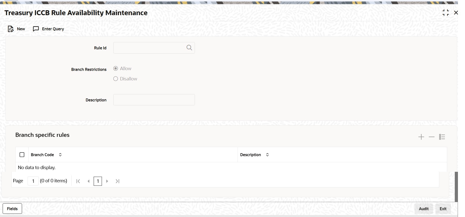

  1. On the Home page, enter CFDTRRLA in the text field and then click Next.
    The Treasury ICCB Rule Availability Maintenance screen displays.
    Figure 1-2 Treasury ICCB Rule Availability Maintenance
    Description of Figure 1-2 follows
    Description of "Figure 1-2 Treasury ICCB Rule Availability Maintenance"
    All fields with (*) symbol are mandatory.
  2. On the Treasury ICCB Rule Availability Maintenance screen, specify the fields.
    For field details and description, refer to the below table.
    Table 1-2 Treasury ICCB Rule Availability Maintenance- Field Description
    Field Description
    Rule Id
    Specify a unique identification for the ICCB rule you are creating. If you are creating a brokerage rule, specify a unique identification for the brokerage rule.
    This is the identification that is used as to identify for the rule, in all subsequent references to it. You must also specify a unique description for the rule.
    Every brokerage rule is identified by a unique ten-character code, called a Rule ID. You can link a valid Brokerage Rule ID to the appropriate broker and product. When a deal is processed, the brokerage attributes defined for the Rule ID that is associated with a broker and product can be applied on the deal.
    Note: After the rule has been created in the ICCB Rule Availability Maintenance screen, the attributes for the rule must be defined in the ICCB Rule Maintenance Screen.
    Branch Restrictions
    You can maintain a list of allowed branches (that is, the rule would be available for use in the allowed list of branches) or disallowed branches (the rule is not be available for use in the branches in the disallowed list).
    To recall, the attributes for the rule are defined, in the ICCB Rule Maintenance Screen. Maintaining the attributes in this screen, for a branch, is subject to whether maintenance of ICCB rules is allowed for the branch, and also whether the rule for which attributes are being defined, is allowed for the branch.
    For details about the Common Branch Restrictions, refer the Security Management System user manual.
    Description Displays the description of the Rule Id.
    Branch specific rules Specify the fields under the Branch specific rules section.
    Branch Code Select the branch code from the available list of values.
    Description Displays the description of the selected branch code.
