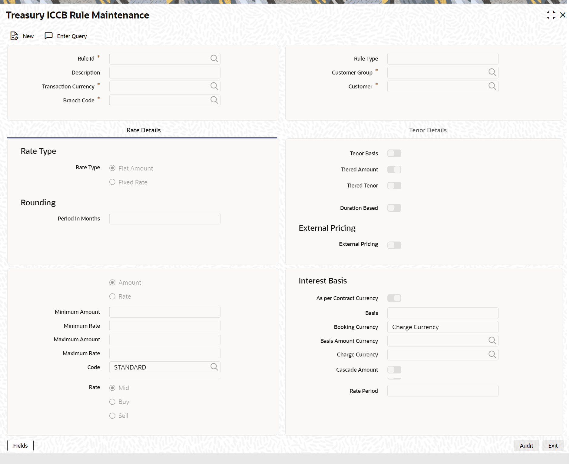

  1. On the Home page, enter CFDTRRLM in the text field and then click Next.
    The Treasury ICCB Rule Maintenance screen displays.
    Figure 1-3 Treasury ICCB Rule Maintenance
    Description of Figure 1-3 follows
    Description of "Figure 1-3 Treasury ICCB Rule Maintenance"

  2. On the Treasury ICCB Rule Maintenance screen, specify the fields.
    For field details and description, refer to the below table.
    Table 1-3 Treasury ICCB Rule Maintenance- Field Description
    Field Description
    Rule Id
    Select the Id of the rule for which you are defining attributes. Every brokerage rule is identified by a unique ten-character code, called a Rule ID. You can link a valid Brokerage Rule ID to the appropriate broker and product. When a deal is processed, the brokerage attributes defined for the Rule ID that is associated with a broker and product can be applied on the deal.
    To recall, the Rule ID for a brokerage rule is specified in the ICCB Rule Branch Availability maintenance. Accordingly, in the Rule ID field in this screen, you must select the ID of the brokerage rule that you wish to build by maintaining the attributes.
    The option list in the Rule ID field is populated based on the following conditions:
    • Only those Rule Ids that are available for users at the current branch according to the ICCB Rule Branch Availability maintenance are displayed
    • The maintenance of ICCB rules must be allowed for users at the current branch, according to the restrictions maintained in the Common Branch Restrictions maintenance for the restriction type ICCB RULE
    If no Common Branch Restrictions have been maintained, and the restriction type ICCB RULE has not been maintained in the SMS Branch Restriction Type maintenance, the option list in the Rule ID field only displays those rules that are available for users in the current branch, according to the ICCB Rule Branch Availability maintenance.
    Description
    Specify a description for the brokerage rule.
    This description is associated with the brokerage rule for information retrieval purposes.
    Transaction Currency
    Select the All option in the currency code, If you wish to define the attributes for all currencies. If you are maintaining the attributes for the selected ICCB rule in specific currency other than the All, select the Transaction Currency on which the rule mapping maintenance is to be made applicable.
    Customer Group
    Select the customer group on which the rule mapping maintenance is to be made applicable.
    You can create a generalized brokerage rule mapping record by selecting the All option in the Customer Group field. This specification is defaulted to the Customer and Customer Account fields. You are forbid to change the specification.
    Rule Type
    Specify whether the rule type for calculating brokerage is Aggregation Type or Individual Type.
    • Aggregation type indicates that brokerage is calculated on the total value of the deals
    • Individual type indicates that brokerage is calculated on a deal-by-deal basis
    Customer Specify the customer Id of the customer for whom you are maintaining the rule mapping.
    Branch Code
    Select the branch for which the attributes are being defined, if you are maintaining the attributes for the selected ICCB rule from the head office branch, you can
    If you wish to define the attributes for all branches, you can select the ALL option in the Branch Code field to indicate this.
    If you are maintaining the attributes for the selected ICCB rule from a branch other than the head office, you can only select those branches that are found in the allowed list of branches for:
    • the ICCB rule definition Restriction Type (ICCBRULE), in the Common Branch Restrictions maintenance for the current branch
    • the selected rule being built, according to the ICCB Rule Availability maintenance In other words, the option list in the Branch Code field would display only those branches that are allowed both for the rule and the current branch.
    Rate Type
    Select the rate type from the following:
    • Flat amount- You can specify a fixed amount as brokerage. This is the brokerage amount for all contracts involving the brokerage rule you are defining.
    • Fixed rate- You can specify a percentage as brokerage. The rate that you specify can be applied on the contract amount to calculate the brokerage amount.
    The specific rates and amounts applicable have to be specified subsequently through this screen.
    The rate type indicates whether the Brokerage to be applied for the Rule ID is a flat amount or a percentage of the basis amount.
    Tenor Basis
    Select the tenor basis option to indicate that defined Rule ID is to be applied based on the tenor of the contract.
    The tenor of the contract is calculated as the difference between the Maturity Date and the Value Date of the contract.
    After the tenor is calculated, brokerage is computed based on the tenor slabs. For more information, refer to the Calculating Brokerage using a Tenor- Based Tier/Slab Structure topic.
    Tiered Amount
    Select the tiered amount option if you wish to maintain the basis amount structure as Tiers. Leave it blank if you are maintaining a slab structure. The Basis Amount is the upper limit of the slab or tier to which a particular rate or amount should be applied as brokerage.
    You can define the brokerage to be applied on contracts in any one of the following ways:
    • In a tier structure (cumulative)
    • In a slab structure (non-cumulative) You should first indicate whether the Basis Amount that you specify subsequently should be considered as a Slab or a Tier.
    Tiered Tenor
    Select the tiered tenor option to indicate that brokerage is to be calculated on the basis of a tiered tenor structure, by choosing the Tiered Tenor option. Tiered tenor is applicable only for duration based brokerage.
    Rounding Specify the rounding fields.
    Note: If the rule type is brokerage, then no need to give value in this field.
    Minimum Amount
    Specify the minimum amount range within which the amount calculated using the brokerage rate should fall, If you indicated that brokerage should be calculated as a flat amount.
    Maximum Amount
    Specify the maximum amount range within which the amount calculated using the brokerage rate should fall, If you indicated that brokerage should be calculated as a flat amount.
    Minimum Rate Specify the minimum rates for brokerage calculations, if you have chosen not to maintain the minimum and maximum amounts.
    Maximum Rate
    Specify the maximum rates for brokerage calculations, if you have chosen not to maintain the minimum and maximum amounts.
    If the brokerage calculated using this Rule ID exceeds the amount calculated using the maximum rate specified here, the maximum rate amount can be applied as brokerage. Similarly, if the brokerage amount falls below the amount calculated using the minimum rate, the minimum rate amount is considered as brokerage.
    Note: If you have specified a flat amount as the Rule Type, then you need not specify the minimum and maximum amount/rate limits.
    Rate
    Specify whether the currency rate for deal or slab currency from the following:
    • Mid
    • Buy
    • Sell
    External Pricing
    Select this box to indicate that external charges can be fetched from external pricing and billing engine for contracts created under this product.
    Interest Basis Specify the below Interest Basis fields.
    As per Contract Currency
    Select this box if you wish to calculate the brokerage based on the contract currency. This specifies the calculation basis for the brokerage based on the Contract Currency or Rule Currency.
    This specifies whether the brokerage is paid in the charge currency or in the currency of the contract.
    If you wish to calculate the brokerage based on the rule currency, then you have to choose the brokerage calculation value from drop-down list next to this field.
    Rate Period Specify the rate period.
    Booking Currency
    Specify the currency in which the brokerage amount is to be calculated.
    • Charge Currency- If you specify the brokerage currency as charge currency, brokerage can be calculated in the currency selected in the Charge Currency field. For a contract in foreign currency, the contract amount is converted into the charge currency equivalent before brokerage is applied.
    • Contract Currency- If you specify the brokerage currency as the contract currency, brokerage can be calculated in the currency of the contract
    Basis Amount Currency
    Specify the upper limit of the slab or tier to which a particular rate or amount should be applied as brokerage. The brokerage rate or amount (depending on the rate type) is to be specified in the subsequent field.
    Fixed Rate
    If the brokerage is in the form of a percentage of the contract amount, you should specify the applicable rate. This rate can be applied for the Basis Amount To, depending on whether you have defined the application basis as a slab or a tier.
    Charge Currency
    Specify the charge currency.
    Tenor Based Rates Specify the tenor based rates.
    Once an ICCB Rule has been defined, you should associate it with a broker and product through the Brokerage Association screen. Depending on the broker and product involved in a contract, the appropriate rule is made applicable.
