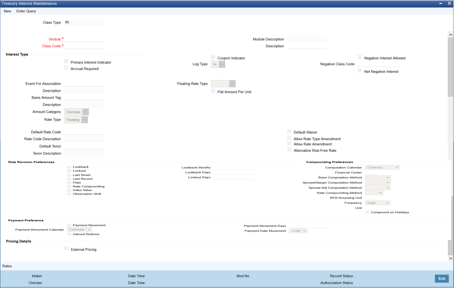

  1. On the Homepage, enter CFDTRINT in the text field and then click the next arrow.
    The Treasury Interest Maintenance screen is displayed.
    Figure 1-3 Treasury Interest Maintenance
    Description of Figure 1-3 follows
    Description of "Figure 1-3 Treasury Interest Maintenance"
  2. On the Treasury Interest Maintenance screen, specify the fields.
    For field details and description, refer to the below table.
    Table 1-2 Treasury Interest Maintenance- Field Description
    Field Description
