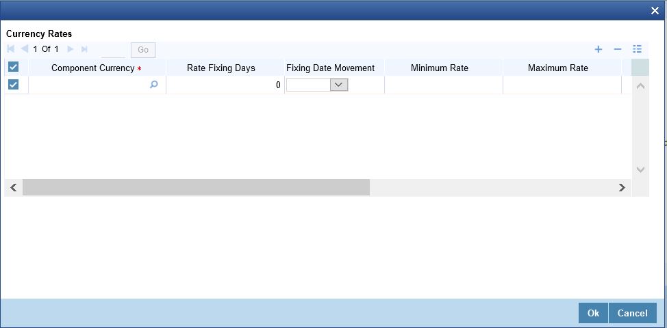

  1. Click Rates in the Treasury Interest Maintenance scree.
  2. Specify the fields in the displayed screen.Description of cfdtrint_rates_button.png follows
    Table 1-3 Rates - Field Description
    Field Description
    Component Currency
    Select the component currency from the displayed list of values.
    Rate Fixing Days
    Enter the rate fixing days as per the requirement. Rate fixing days can have the values from zero or greater. If no values are entered system defaults it to zero.
    By default, the system displays 0 value.
    Fixing Date Movement
    Select the Fixing Date Movement from the drop-down list as per the requirement from the effective revision date. The available options are:
    • Forward
    • Backward
    If rate fixing days is greater than zero, movement is selected either as forward or backward. If rate fixing days is zero then Reset date movement will remain blank. The Values of the Rate fixing days and Rate fixing movement are defaulted from Treasury Maintenance screen (Refer to section 2.4) for the currency and rate code combination. Based on the requirement, user can change these values.
    Minimum Rate
    Specify the minimum rate which must be applied to the contract under the products linked to this class. Minimum rate allows negative values if the negative interest is allowed for the class..
    Maximum Rate
    Specify the maximum rate which must be applied to the contract under the products linked to this class. Maximum rate allows negative values if the negative interest is allowed for the class.
    Default Rate
    Specify the default rate that should be applied for on contracts under the products linked to this class. Default rate allows negative values if the negative interest is allowed for the class.
    Minimum Spread
    Specify the minimum spread which must be applied to the contract.
    Maximum Spread
    Specify the maximum spread which must be applied to the contract.
