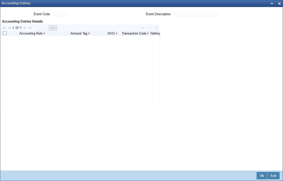

1.2.7.1 Define Events and Accounting Details Specifically for a Product
If you do not use an events class, you should define event details specifically for the product. In this case, select an event from the adjoining option list that displays a list of events pertaining to the module.
For every event you select, you should specify the accounting entries that should be passed and the advices that should be generated.
