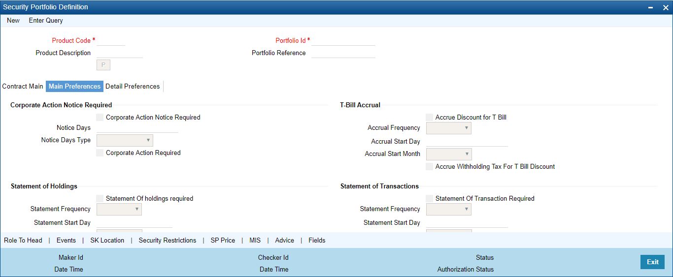

  • The Main Preference screen
  • The Detail Preferences screen
Figure 20-4 Portfolio Main Preferences
Description of Figure 20-4 follows
Description of "Figure 20-4 Portfolio Main Preferences"
Preferences (that involve accounting entries) defined for the product cannot be changed while creating a Securities Portfolio that involves it. These include:
  • The asset accounting basis
  • The portfolio costing method
  • Whether the intrinsic value of rights and warrants needs to be booked
  • Accrual preferences like
  • Whether withholding tax should be accrued
  • Whether the discount for T-Bills should be accrued
  • Whether withholding tax for discounted T-Bills should be accrued
  • Whether premium or discount should be accrued
  • Whether redemption premium should be accrued
  • Whether interest should be accrued
  • Whether forward profit or loss should be accrued
  • Revaluation preferences, such as the revaluation basis, LOCOM basis, method, frequency, and start date)
The LOCOM basis is defaulted from the Portfolio Product and can be changed. Subsequently, an amendment of the LOCOM basis specified in the Portfolio Definition screen is not possible. For details about the LOCOM basis, refer to the chapter Maintaining a Portfolio Preference Class’ of this User Manual. Further, you can specify the following preferences, for the components that can be accrued:
  • The accrual method
  • Accrual frequency
  • Start days
  • Start month

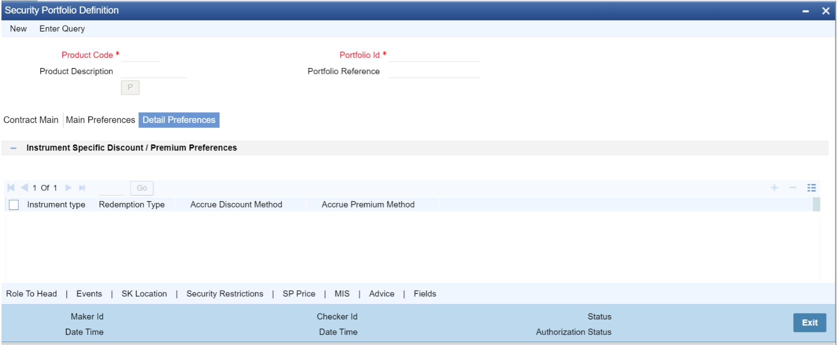

Figure 20-5 Portfolio Detail Preferences
Description of Figure 20-5 follows
Description of "Figure 20-5 Portfolio Detail Preferences"
Instrument Specific Discount / Premium Preferences
This topic describes about the overview of instrument specific discount/premium preference.
Instrument Type
Select the instrument type from the adjoining drop-down list. The list displays the following options:
  • Bonds
  • Treasury Bills
  • All
Redemption Type
Select the redemption type from the adjoining drop-down list. The list displays the following options:
  • Bullet
  • Quantity
  • Series
  • All
Accrue Discount Method
Specify the accrue discount method. If you select the redemption type as bullet, then the system will allow you to select the discount method as constant yield /exponential / straight line/ weighted moving average. However, for any other type of redemption, you can select only the type as constant yield,
Accrue Premium Method
Specify the accrue premium method. If you select the redemption type as bullet, then the system will allow you to select the discount method as constant yield /exponential / straight line/ weighted moving average. However, for any other type of redemption, you can select only the type as constant yield,
Accrual Method
The accrual method refers to the method to be used to calculate the amount of premium or discount to be accrued. You can select one of the following options from the drop-down list:
  • 30 (Euro) / 360
  • 30 (US) / 360
  • Actual / 360
  • 30 (Euro) / 365
  • 30 (US) / 365
  • Actual / 365
  • 30 (Euro) / Actual
  • 30 (US) / Actual
  • Actual / Actual
  • 30 (Euro) / 364
  • 30 (US) / 364
  • Actual / 364
If the ‘Accrue Premium Method’ or the ‘Accrue Discount Method’ selected is ‘Weighted Moving Average’, then the ‘Accrual Frequency’ cannot be ‘Daily’.
