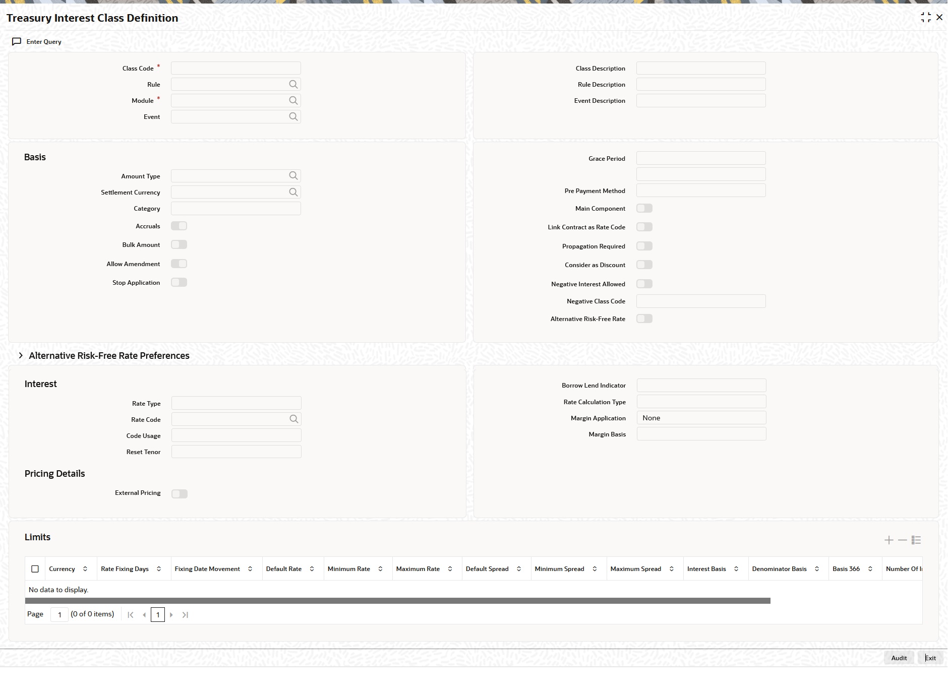

- On the Home page, type CFDTRINC  in the text box, and click the next arrow.
Treasury Interest Class Definition screen is displayed.
Figure 9-3 Treasury Interest Class Definition
Description of "Figure 9-3 Treasury Interest Class Definition " - On the Treasury Interest Class Definition screen,
                    specify the details as required.
For information on fields refer to the below table.
