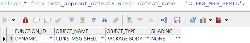

Kindly make sure all dynamic package exceptions should have an entry in “CSTM_APPROOT_OBJECTS” table.
Example: Only package body will be considered as exception and package will be converted to METADATA link.
Figure 4-1 CSTM_APPROOT_OBJECTS table

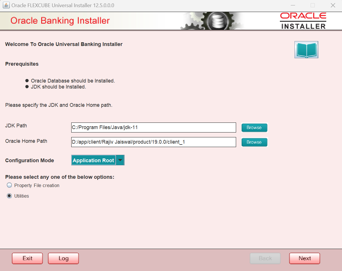

  1. Double-click ‘FCUBSInstaller.bat’ batch file to launch Oracle FLEXCUBE Universal Installer. The following screen is displayed. Select Utilities option, configuration mode as “Application Root” and click ‘Next’ button.

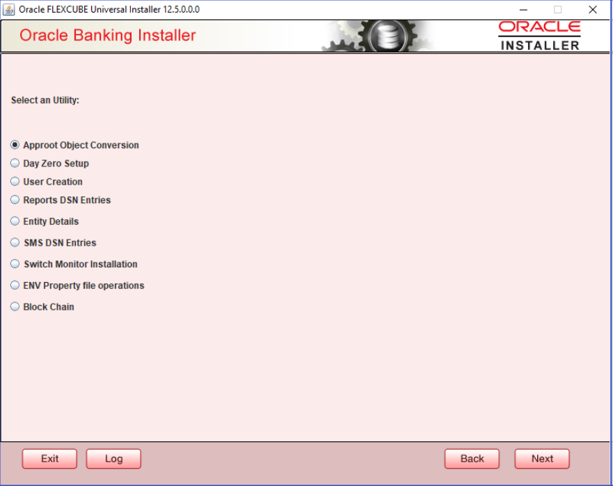

  2. Select ‘Approot Object Conversion” in Utility Screen and click Next as shown below:

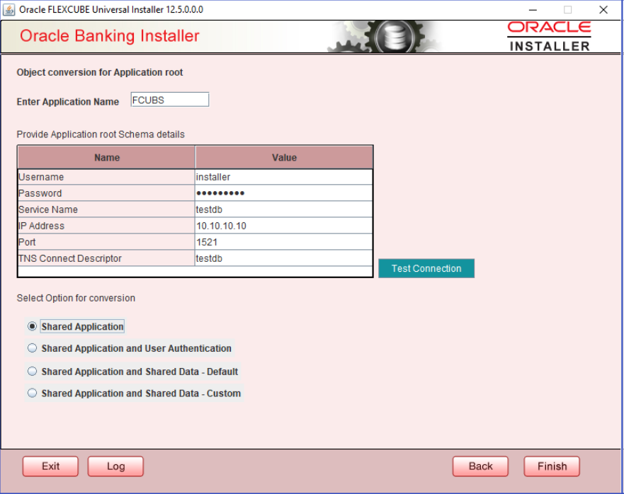

  3. In the Approot Object Conversion screen, Enter Application Name and the Application root schema details where the conversion has to be applied and click on ‘Test Connection’.
  4. Once the connection is successful, ‘Finish’ button will be enabled.

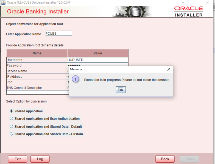

  5. User has to select the option ‘Shared Application’ and click on the ‘Finish’ button to complete object conversion.
  6. Execution will take few minutes and post completion, a dialog box displays ‘Compilation Success’ message in the front end.
