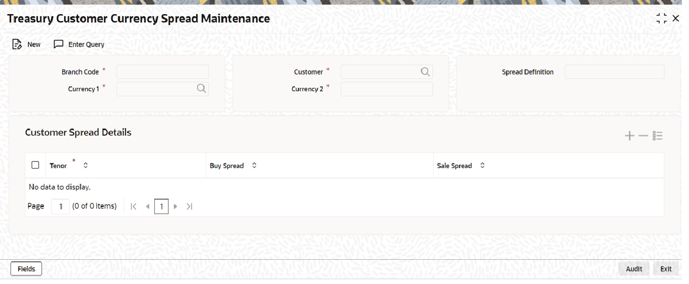

  1. On Home page, specify CYDTRCSP in the text box, and click next arrow.
    The Treasury Customer Currency Spread Maintenance screen is displayed.
    Figure 1-14 Treasury Customer Currency Spread Maintenance
    Description of Figure 1-14 follows
    Description of "Figure 1-14 Treasury Customer Currency Spread Maintenance"
  2. On the Treasury Customer Currency Spread Maintenance screen, specify the fields.
    For more information on fields, refer to the below table.
    In this screen, for a customer and currency pair, you can maintain buy and sell spreads for different tenors. You need to maintain customer spreads in each branch. Transactions initiated in a branch picks up the spread(s) maintained for that branch.

    Branch Code
    Specify the branch code.
    Currency 1
    Select the Currency 1 from the available list of values.
    Currency 2
    Select the Currency 2 from the available list of values.
    Spread Definition
    Specify the spread definition in percentage.
    Customer Spread Details
    Specify the customer spread details.
