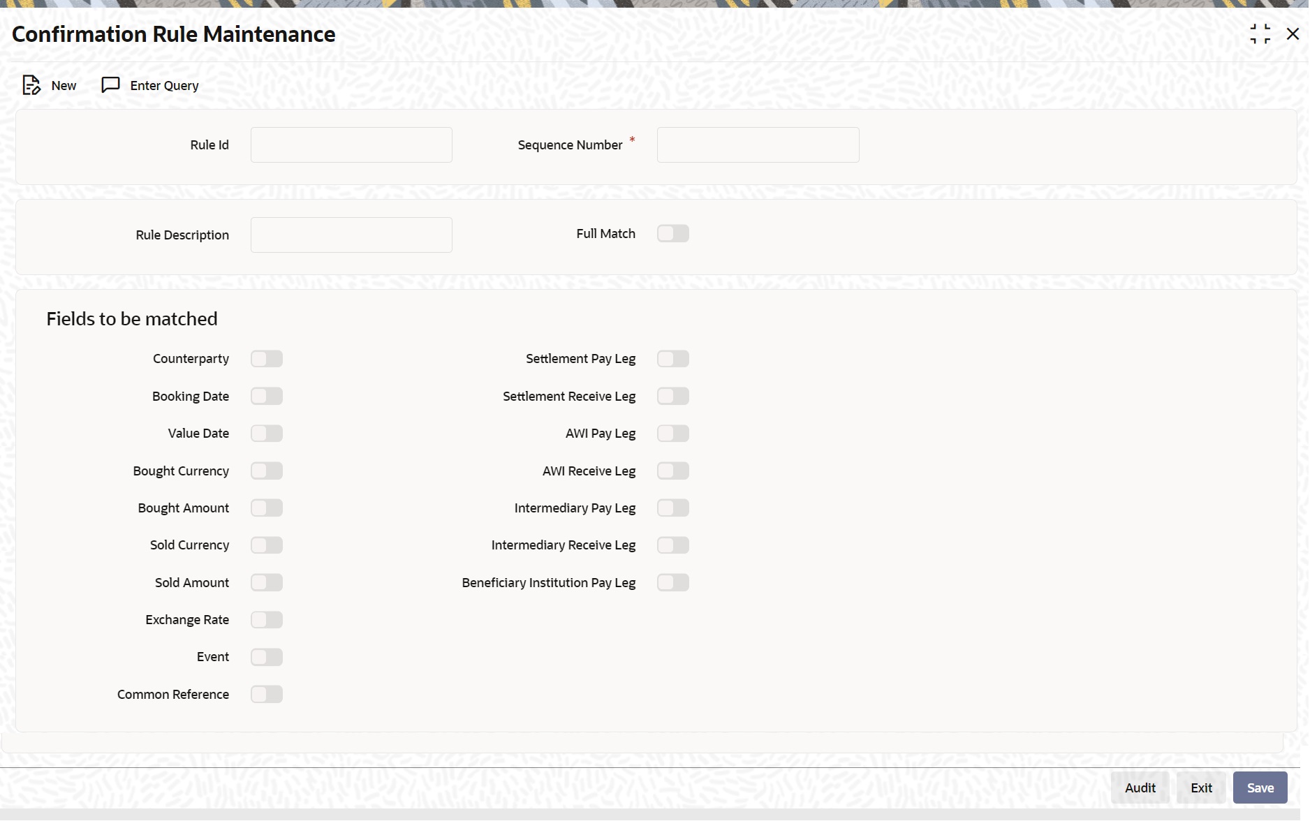

FX Confirmation Rule Maintenance
Rule maintenance screen is provided for maintaining confirmation rules. Auto matching of confirmation messages is done based on these rules.
The fields which are available in the confirmation rule maintenance screen for the Functional ID FXDCNFMT are:
Table 8-1 Confirmation Rule Maintenance - Field description
Field | Description |
Rule Id |
Specify the unique ID for a rule. |
Rule Description |
Specify the description for the specified rule ID. |
Sequence Number |
The system displays the sequence number. You can modify this. If there are multiple Rules, the processing for auto matching the messages will happen based on the sequence number in an ascending order. |
Full Match |
Check this box if the confirmation rule maintained is a Full Match Rule. It is mandatory to check all the above fields except the below-mentioned fields if the maintained rule is to as ‘Full Match’:
You can maintain more than one rule as full match. The system verifies the message details with the contract details based on the confirmation rules maintained. If single contract details match with message details for a ‘Full match’ rule, then the message is marked as completely matched, and the contract is marked as confirmed. |
Fields to be matched |
You can enable the following fields to match the details of an incoming SWIFT confirmation message MT300 with an existing deal in Oracle BankingTreasury Management:
Field to be Matched |
If ‘Full Match’ is checked, then the following fields are mandatory: Counterparty Booking Date Value Date Bought Currency Bought Amount Sold Currency Sold Amount Exchange Rate If the outcome of a Full Match rule is satisfied with a single deal, then the system marks the message as Completely Matched and the deal as Confirmed. If multiple contracts match with a Full match rule, then the system marks the message as Partially Matched. Even if message and deal details are matched based on the listed fields in rule which marks the Full Match, the system marks the messages as Partially Matched. Manually match the partially matched messages. |

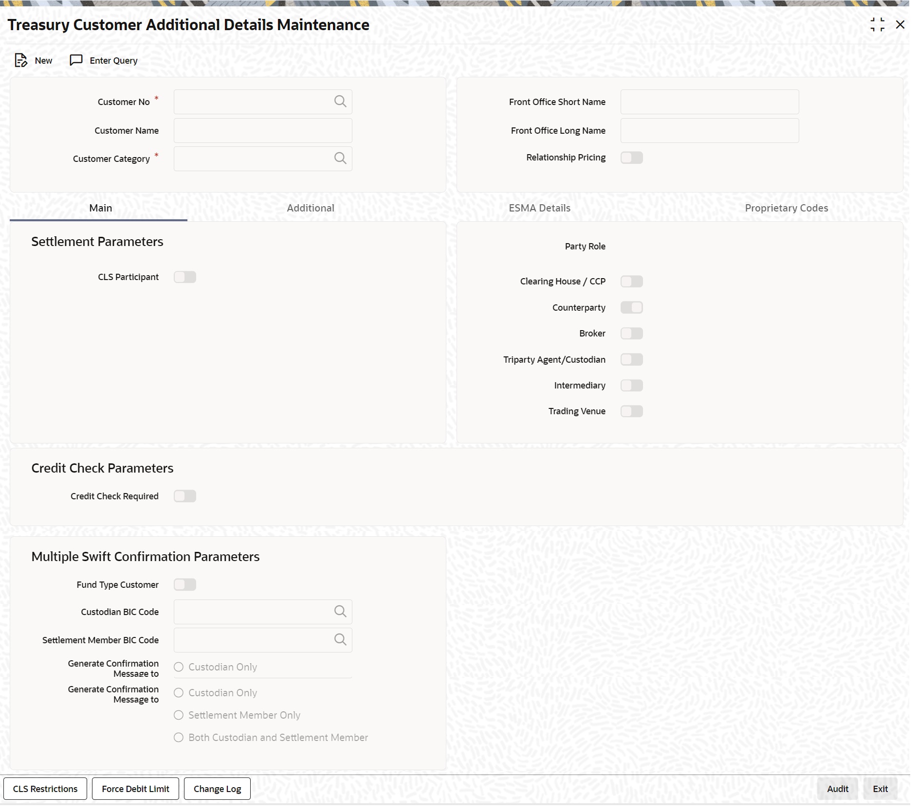

Treasury Customer Address Maintenance
This topic describes about Treasury Customer Address Maintenance. This screen is viewed using the functional ID MSDTRCAD.
Figure 8-5 Treasury Customer Address Maintenance
Description of "Figure 8-5 Treasury Customer Address Maintenance"
- Auto matching of Confirmation Messages will happen only when the confirmation matching flag is checked for the combination of customer, branch, message type, module, location and media.
For information on fields refer to the MS User Manual, chapter 4 section 4.1.1 Maintaining Address at Customer (CIF) Level.

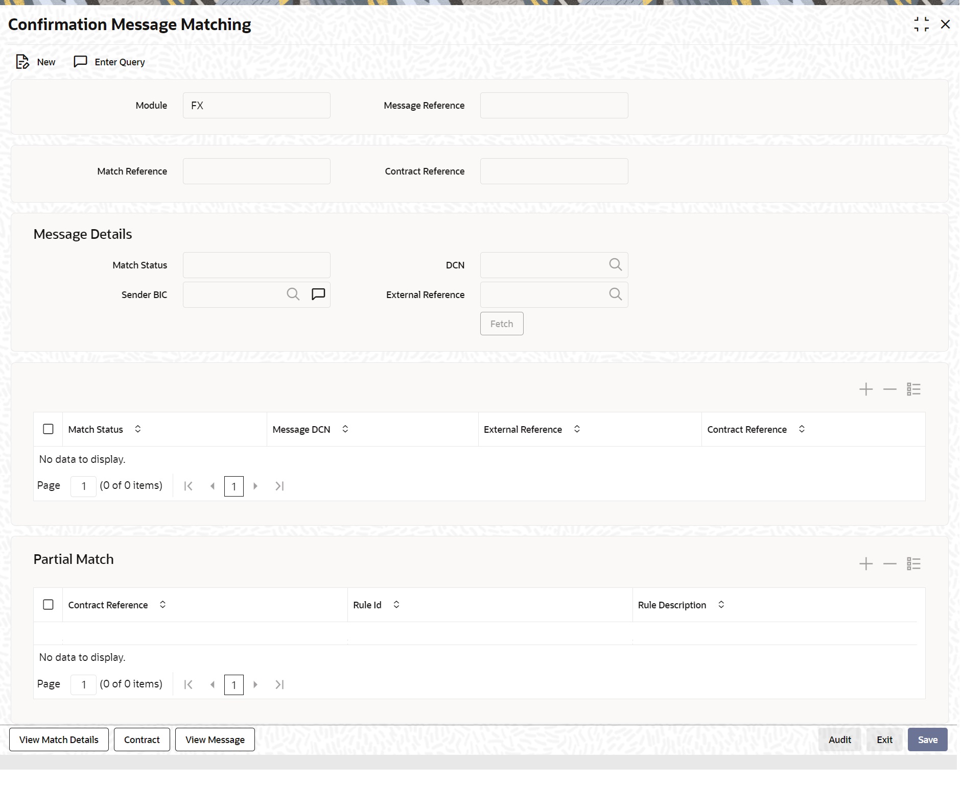

FX Confirmation Message Matching Screen
Confirmation Message matching with the Functional ID FXDMATCH provides querying matched/partial matched/unmatched message details. User can also do a manual match / un-match using this screen.
For information on Confirmation Message Matching, refer to the FX user manual Chapter 3, section 3.9.
FXSMATCH- FX Confirmation Message Matching Summary
User can select an auto/manual match record from the summary screen.
The query criteria available is Match reference number, Record Status, Authorization Status, Message Reference, Contract reference number & Mode of Matching.
Mode of Matching can be Auto or Manual.
For more information, refer to the FX user guide chapter 3, section 3.9.6.
