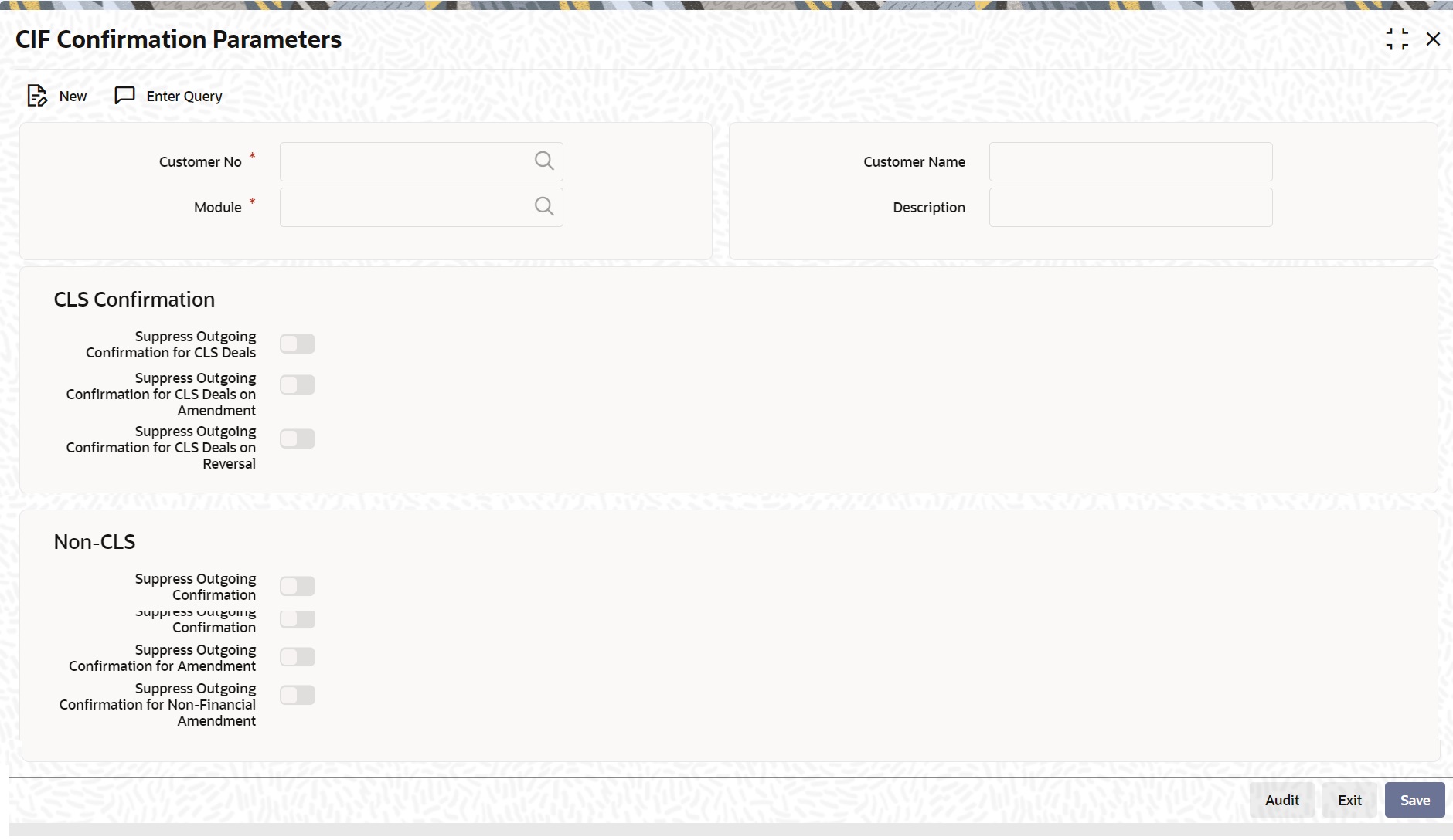

- System generates the SWIFT confirmation messages for Non CLS deals (MT 300 for FX and MT 320 for MM) based on the below Customer parameters maintained in TRDCIFPM screen.

- Alternatively for the Counterparty in the CIF parameters maintenance if the Suppress flag is set, then the Confirmation message should not be sent out of the system
- If at contract level the suppress confirmation flag is checked or suppress outgoing confirmation parameters is checked in the CIF confirmation parameter then confirmation will not be generated.

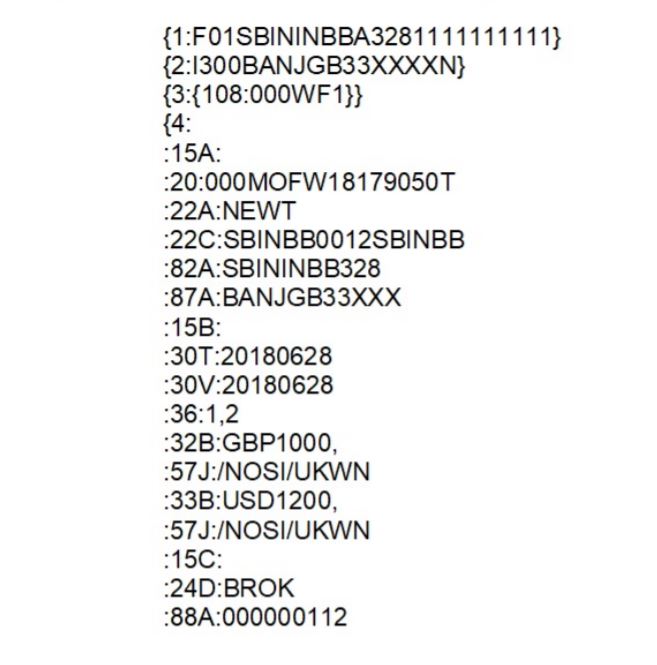

Figure 8-2 Sample MT 300 message – Foreign Exchange Confirmation

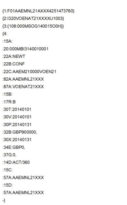

Figure 8-3 Sample MT 320 message – Money Market Confirmation

- During a Non-Financial Amendment of an FX Deal, via the FWDTRONL screen system should check if SI settlement related fields have been changed before generation of any FX Confirmation messages. If none of the SI fields has changed then system must suppress the generation of Confirmation messages for such Amendments.
