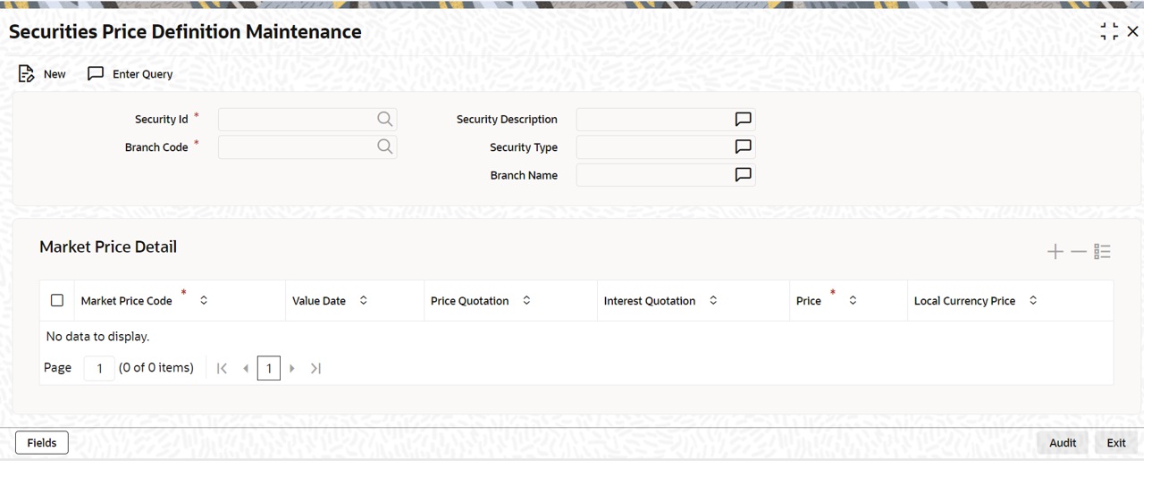

- On Home page, type SEDXMRAT in the text box, and click next arrow.
Securities Price Definition Maintenance screen is displayed.
Figure 4-1 Securities Price Definition Maintenance
Description of "Figure 4-1 Securities Price Definition Maintenance" - On the Securities Price Definition Maintenance screen, specify the fields.
If you are maintaining details of the market price for new security, click on new from the toolbar. The Market Definition detailed screen will be displayed without any details. To modify or update the existing prices as of different Value dates, click on the unlock button. Enter the value date and the new price in the respective fields and save the record. If you are calling a market price maintenance record that has already been defined, choose the Summary option under Market Price. From the Summary screen, double click on a record to open it.
