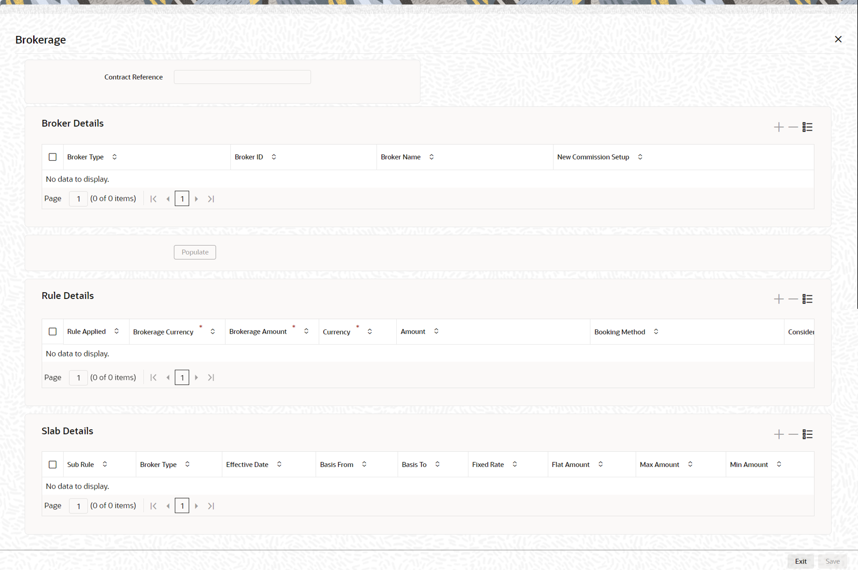

When capturing the details of a deal that involves brokerage, you will have to specify the brokerage details applicable to the deal. To recall, you have already specified the name of the broker through whom the deal was brokered in the Securities Deal screen. The details specified for the broker including the brokerage rule linked to the broker, is defaulted. However, you can change some details, like — whether brokerage should be booked in advance, in arrears or whether it should be waived altogether.
Click Brokerage to define the brokerage details that are applicable to the bank leg you are processing. You will be allowed to enter details of a broker only if brokerage was allowed for the product to which the deal is associated.
The Broker ID assigned to the broker through whom the deal was brokered is displayed along with the broker’s name. If the brokerage payable currency is the same as the brokerage currency, then the same amounts (brokerage paid and brokerage payable) are displayed against the currencies. You have the option to change these currencies. While you cannot input the brokerage payable amount, the brokerage amount can be changed.
