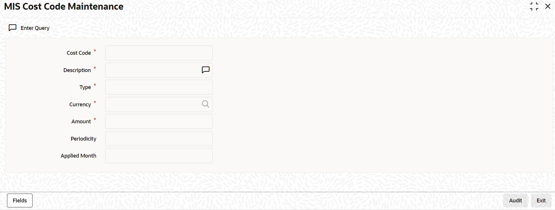

  1. On Homescreen, type MIDXCODE in the text box, and click Next.
    The MIS Cost Code Maintenance screen displays.
    Figure 1-34 MIS Cost Code Maintenance
  2. On the MIS Cost Code Maintenance screen, specify the fields.
