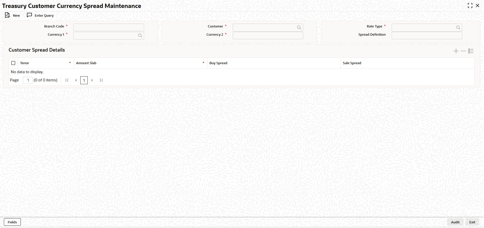

  1. On Home page, specify CYDTRCSP in the text box, and click next arrow.
    The Treasury Customer Currency Spread Maintenance screen is displayed.
    Figure 1-14 Treasury Customer Currency Spread Maintenance
    Description of Figure 1-14 follows
    Description of "Figure 1-14 Treasury Customer Currency Spread Maintenance"
  2. On the Treasury Customer Currency Spread Maintenance screen, specify the fields.
    For more information on fields, refer to the below table.
    In this screen, for a customer and currency pair, you can maintain buy and sell spreads for different tenors. You need to maintain customer spreads in each branch. Transactions initiated in a branch picks up the spread(s) maintained for that branch.

    Customer Spread Details
    Specify the customer spread details.
    When processing an FX deal involving a customer (for whom you have maintained spread details), the system picks up the customer spread corresponding to the tenor and amount of the deal and builds it into the exchange rate.
    If spread details are unavailable for a specific tenor, the system picks up the spread defined for the nearest lower tenor. For example, assume for a customer and currency pair you maintain spread details for the following tenors: ‘3’, ‘5’, and ‘10’ days. When processing a deal with a tenor of ‘4’ days (involving the customer and the currency pair), the system picks up the spread details defined for a tenor of three days. This is because spread details for a ‘4’ day tenor are unavailable for the customer and currency pair.
    Note: You can also maintain customer spreads for the wildcard entry – ALL. If spread details for a specific counterparty (for the currency pair) are unavailable, the System looks for the customer spread maintained for the wildcard ALL entry. If even that is not available, then the customer spread defaults to zero.
