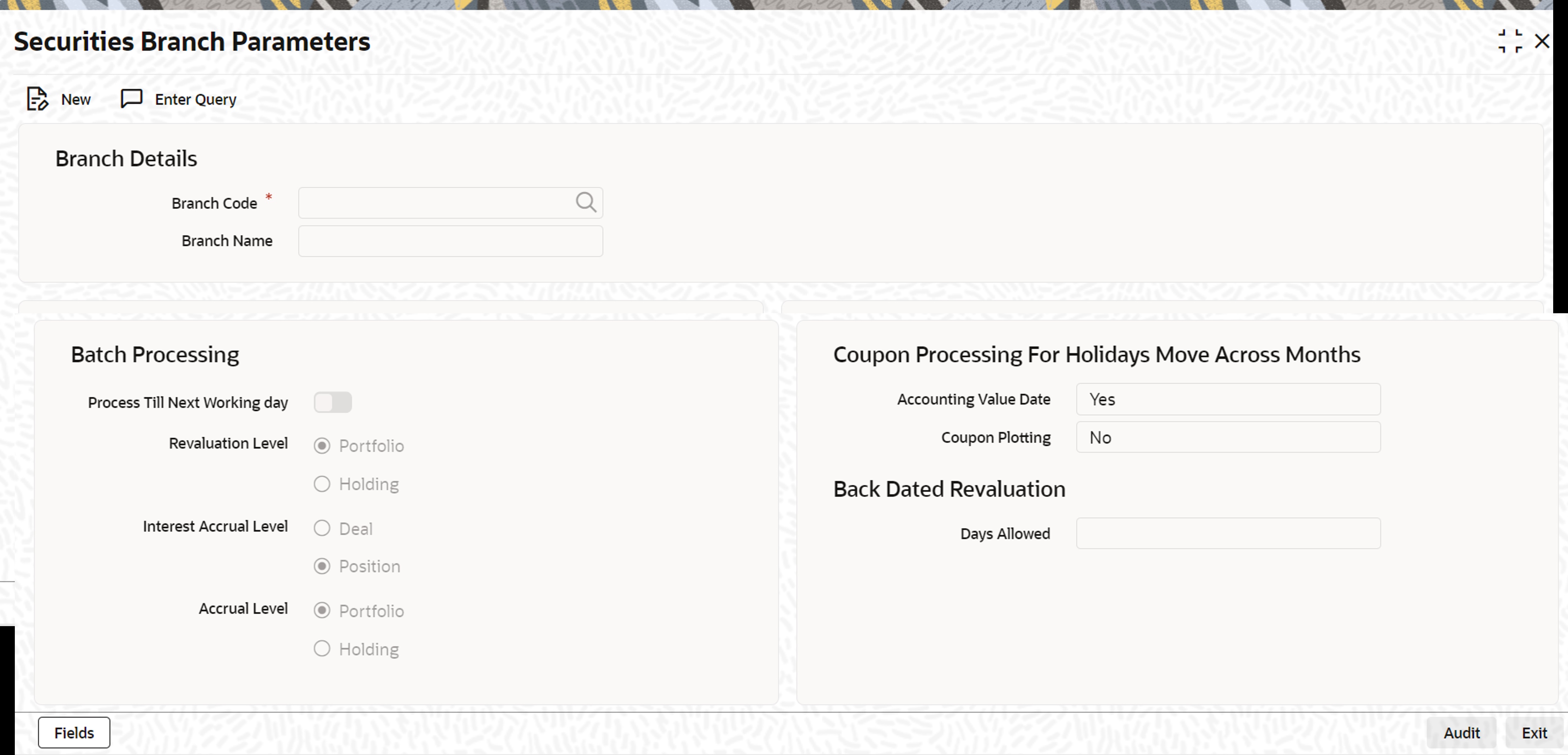

3.5.1 Define Branch Parameters
  1. On the Home page, specify SEDXBRPM in the text box, and click the arrow next t.
    The Securities Branch Parameters screen is displayed.
    Figure 3-4 Securities Branch Parameters
    Description of Figure 3-4 follows
    Description of "Figure 3-4 Securities Branch Parameters"
  2. On the Securities Branch Parameters screen and specify the fields.
    For more information on fields, refer to the below table.
    The events, for which you had indicated automatic processing, are triggered off during the Batch Process. You can specify preferences for the automatic events that fall on a holiday, in the Branch Parameters screen.
    Table 3-4 Securities Branch Parameters - Field Description
    Field Description
    Batch process Parameter
    You have the option to specify when the batch process, must process automatic events falling due on a holiday. It could be either:
    • As part of the EOD on the last working date before the holiday.
    • As part of the BOD process on the next working day after the holiday
    Revaluation Level
    Revaluation entries can be passed at the portfolio level or the holding level.
