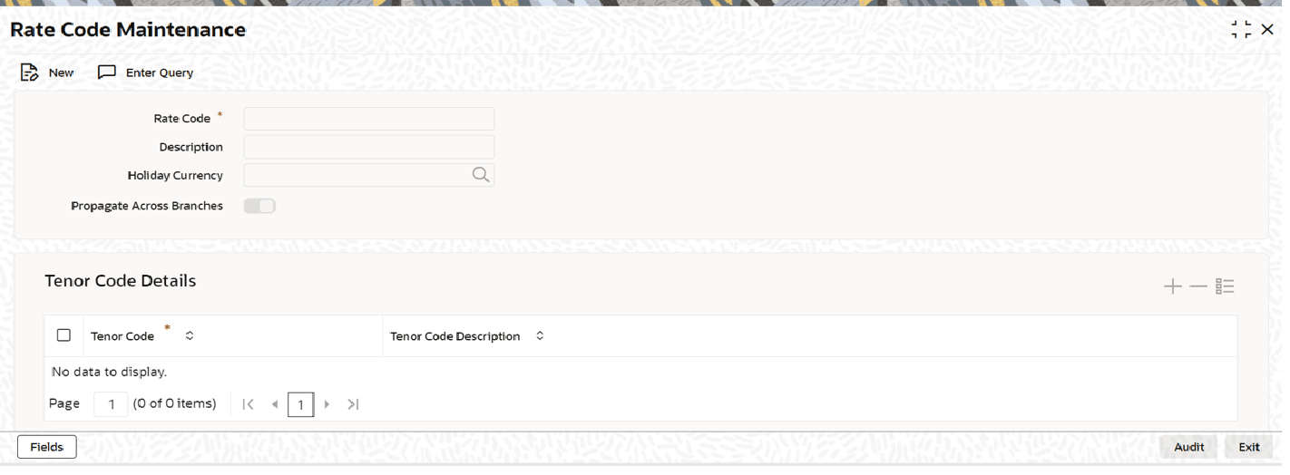

  1. On the Home page, specify CFDTRRCM in the text box, and click next arrow.
    The Rate Code Maintenance screen is displayed.
    Figure 3-5 Rate Code Maintenance
    Description of Figure 3-5 follows
    Description of "Figure 3-5 Rate Code Maintenance"
  2. On the Rate Code Maintenance screen, specify the fields.
    For more information on fields, refer to the below
    Table 3-13 Rate Code Maintenance- Field Description
    Field Description
    Rate Code
    Enter a code to identify the rate you are defining. You can associate several currencies to the rate code and specify rates for each currency.
    While processing a contract, you need to indicate this code to make the rate applicable to the contract. The code cannot exceed 10 characters.
    Description
    Specify a brief description to identify the rate code being defined.
    Holiday Currency
    Specify the holiday currency for this rate code. You can choose the appropriate one from the adjoining option list that displays all valid currency codes maintained in the system.
    Propagate Across Branches
    Check this option to indicate that the rate code should be available across all branches.
    Tenor Code
    Specify a unique code to identify the tenor for which this rate code should be applicable.
    Tenor Code Description
    Specify a brief description for the tenor code. You can add multiple tenor codes for the rate code
    Click the add row button. Select the desired row, and click the delete row button to delete the tenor code.
