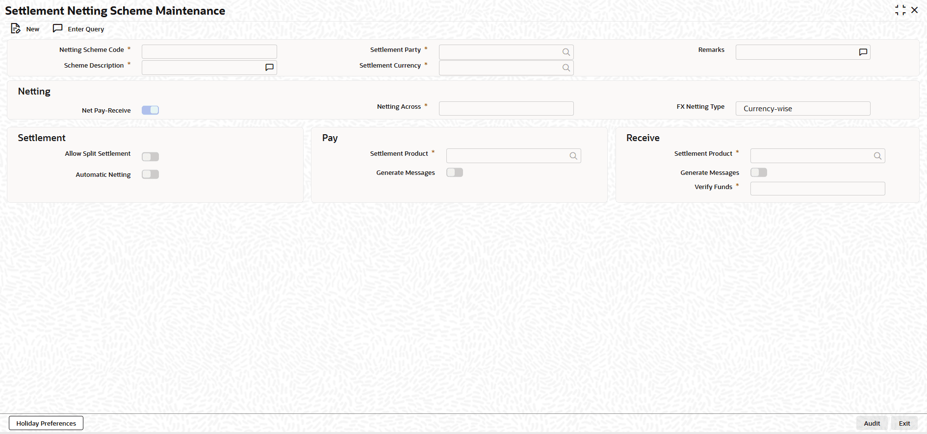

  1. On the Home screen, type NTDSNSHM in the text box, and click Next.
    The Settlement Netting Scheme screen displays.
    Figure 1-4 Settlement Netting Scheme
  2. On the Settlement Netting Scheme screen, Click New.
  3. On the Settlement Netting Scheme, Specify the details as required.
    Table 1-4 Settlement Netting Scheme - Field Description
    Field Description
    Netting Scheme Code Specify the unique code that identifies this Netting Scheme throughout Treasury application.
    Scheme Description Enter the suitable description for the scheme, preferably unique description to identify easily. This description is displayed along with the code.
    Settlement Party Select the counterparty to this netting scheme.
    Settlement Currency Select the settlement currency for which this Netting Scheme would be used.
    Remarks Enter the notes about the product intended for bank’s internal reference.
    Net Pay-Receive Switch this toggle On, to indicates whether netting of payments and receipts is allowed when this Netting Scheme is used for settlement.
    Netting Across The drop-down lists the level up to which netting of cashflows is allowed when this Netting Scheme is used for settlement. The available options are:
    • Module
    • Product
    • Deal Type
    • Deal
    FX Netting Type Specify whether netting of FX cashflows across currency pairs is allowed when this Netting Scheme is used for settlement.
    Allow Split Settlement Switch this toggle On, to indicates whether split settlement is allowed when this Netting scheme is used for settlement.
    Automatic Netting Switch this toggle On, to indicates whether cashflows can be automatically netted for deals using this Netting scheme.
    Netting Eligible Switch this toggle On, to indicates whether this product can be used for net settlement.
    Settlement Product Select the treasury settlement product that will be referred for triggering events and accounting for the payment using this netting scheme.
    Generate Messages Switch this toggle On, to indicate whether settlement advice would be allowed to be generated when this Netting scheme is used for payment.
    Settlement Product Select the treasury settlement product that will be referred for triggering events and accounting for the receipt using this netting scheme.
    Generate Messages Switch this toggle On, to indicate whether settlement advice would be allowed to be generated when this Netting scheme is used for receipt.
    Verify Funds Select the type for balance in the settlement account need to be verified before allowing authorization of the settlement using this product. The available options are:
    • Not Required
    • Verify but Proceed
    • Verify and Stop
