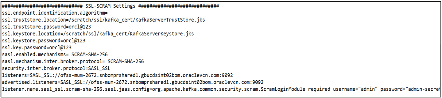

  1. Verify that /scratch/obma/kafka_zookeeper/kafka_2.13-3.4.0/config/server.properties, password, ssl truststore and keystorelocation is correct.
    Figure A-1 Verify Server Properties
