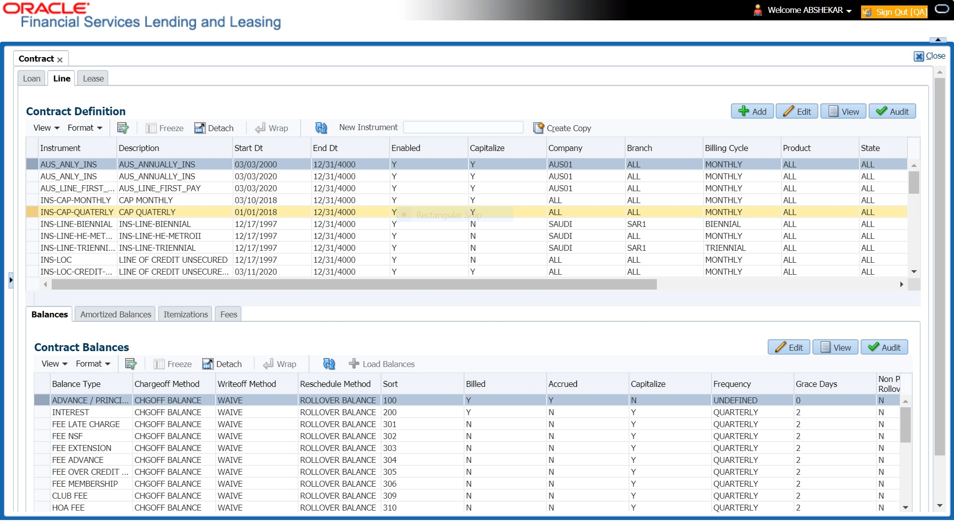

System supports Biennial (once every 2 years) and Triennial (once every 3 years) type of billing cycles. Based on the following lookups, the billing cycle frequency can be defined:
  • BILL_CYCLE_CD
  • LEASE_BILL_CYCLE_CD - For lease accounts, the Biennial and Triennial billing cycles are applicable only for Interest Rate type of Calculation Method and for both Advance and Arrears type of Rent Collection Methods. However, these billing cycles are allowed for Balloon Method - N+1 and not allowed for Flexible repayment > Skip Months and for Agreement type, Usage, Rental, Rental Usage types.
  • LOAN_BILL_CYCLE_CD - For Loan accounts, the Biennial and Triennial billing cycles are applicable only for Standard Product Category and for both Advance and Arrears type of Rent Collection Methods - Advance (if First Payment Date is equal to Contract Date) and Arrears (if First Payment Date is greater than Contract Date). However, these billing cycles are allowed for Balloon Methods N and N+1 and not allowed for Flexible repayment > Skip Months.
  • LOC_BILL_CYCLE_CD - for Line of Credit accounts

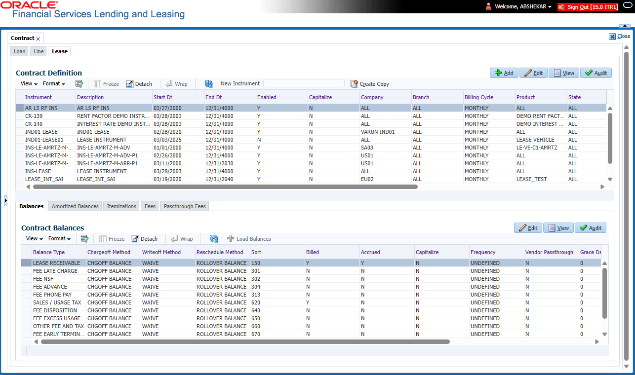

To set up the Contract
You can either define new Contract Definition details or specify a new name in the New Instrument field and click Create Copy to create a copy of selected contract with details.
  1. On the Oracle Financial Services Lending and Leasing home screen, click Setup > Setup > Administration > Products > Contract > LoanLineLease.
  2. On the Contract Definition section, perform any of the Basic Operations mentioned in Navigation chapter.
    A brief description of the fields is given below:
    Table 4-21 Contract Definition
    Field Do this
    Instruments section
    Instrument Specify the code identifying the instrument.
    Description Specify the description of the instrument being defined.
    Start Dt Specify the start date for the instrument. You can even select the date from the adjoining Calendar icon.
    End Dt Specify the end date for the instrument. You can even select the date from the adjoining Calendar icon.
    Enabled
    If you check this box, the system will consider this contract definition when selecting a instrument for an application.
    Note: Once the field is enabled load balances button in balances sub tab will be disabled.
    Selection Criteria section
    Company Select the company for the instrument from the drop-down list. This may be ALL or a specific company.
    Branch Select the branch within the company for the instrument from the drop-down list. This may be ALL or a specific branch. This must be ALL, if you have selected ALL in the Company field.
    Billing Cycle Select the billing cycle selected from the drop-down list.
    Product Select the product for the instrument from the drop-down list. This may be ALL or a specific product.
    State Select the state in which the instrument is used from the drop-down list. This may be ALL or a specific state.
    Currency
    Select the currency for the instrument from the drop-down list.
    IMPORTANT: By selecting which type to use, the system searches for a best match using the following attributes:
    1. Billing Cycle
    2. Start Date
    3. Company
    4. Branch
    5. Product
    6. State
    Hence, Oracle Financial Services Software recommends creating one version of each type, where ALL is the value in these fields.
    Pricing Select the pricing in which the instrument is used from the drop-down list. This may be ALL or a specific pricing.

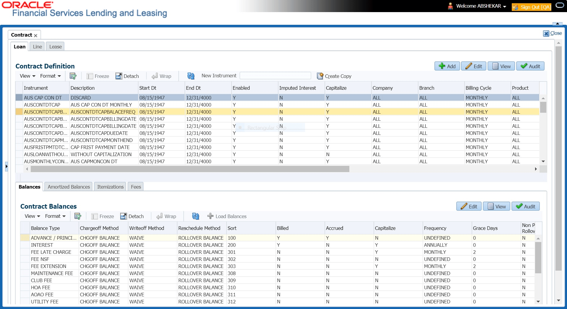

    Capitalization section
    This section allows you to define capitalization parameters which helps to capitalize the corresponding account balances to the principal balance of the account based on specific frequency. For example, you can capitalize the accumulated Interest or Late Fees to principal balance of the account.
    You can either capitalize all the balances based on same frequency or define different frequency for each type of balance. Balance capitalization is processed during the execution of batch job TXNCPT_BJ_100_01 (CAPITALIZATION PROCESSING) which is executed after running the billing batch job.
    Note: Capitalization parameters can also be updated by posting CAPITALIZATION MAINTENANCE monetary transaction.
    Capitalize
    Check this box to enable capitalization parameters for the contract. By default, this option is un-checked.
    The option is available only for Interest Bearing Loans and Mortgage Loans.
    Frequency
    Select the required capitalization frequency from the drop-down list. The list contains the following types of frequency to either capitalize all the balances based on same frequency or define different frequency for each type of balance.
    • Based on specific intervals such as Monthly, Quarterly, Annual and so on.
    • Based on contract Billing Frequency, Billing Date, or Due date.
    • Specifically on every Month End.
      -Or-
    • Based on Balance Frequency to define different capitalization frequency for each balance. This can further be defined in Balances sub tab.
    Capitalization Start Basis
    Select the capitalization start date from the drop-down list as either Contract Date or First Payment Date to calculate the capitalization frequency accordingly.
    However, this field is not enabled for Billing date or Due Date type of capitalization frequency.
    Grace Days
    Specify the grace days allowed in the frequency (minimum 0, maximum 31) before capitalizing the balances to account. This is also the deciding factor for executing the capitalization batch job which is based on Capitalization Frequency + Grace Days.
    However, note that Grace Days are not accounted for Month End type of capitalization frequency and is ignored even if specified.
    Cap Tolerance Amt
    Specify the capitalization tolerance amount which is the minimum amount to qualify for capitalization. Any amount less than this is not considered for capitalization of balances.
    This helps to avoid capitalization of nominal or decimal amounts.
    Note: There is no specific accounting maintained for non-capitalized decimals with reference to setup.

    Table 4-22 Contract Definition
    Field Do this
    Instruments section
    Enabled
    Currency
    1. Billing Cycle
    2. Start Date
    3. Company
    4. Branch
    5. Product
    6. State
    Pricing Select the pricing in which the instrument is used from the dropdown list. This may be ALL or a specific pricing.
    Capitalize
    The option is available only for Average daily balance Method Line of Credit.
    Frequency
      -Or-
    Grace Days
    Cap Tolerance Amt

    Delinquency section
    Late Charge Grace Days Specify the number of grace days allowed for the payment of a due date before a late charge is assessed on the account.
    Stop Accrual Days
    Specify the number of days a contract can be in delinquent state, after which the interest accrual must stop for an account.
    A Batch Job is run daily to select accounts in delinquent status for a pre-defined number of days and post No Accrual transaction for such accounts on current date. When the account recovers from Delinquency, the system will then post a Start Accrual Transaction on the date the account is recovered from delinquency.
    Delq Grace Days Specify the number of grace days allowed for the payment of a due date before an account is considered delinquent. This affects DELQ Queues, the system reporting, and the generation of collection letters.
    Time Bar Years Specify the total number of years allowed to contact the customer starting from the first payment date and beyond which the account is considered delinquent. You can specify any value between 0-999.
    Cure Letter Gen Days Specify the number of delinquency days to initiate cure letter generation.
    Cure Letter Valid Days Specify the number of days during which the issued cure letter is valid. Usually financial institutions will start the collection activities after the lapse of cure letter validity date.
    Delq Category Method
    Select the delinquency category method to determine how the system populates delinquency counters on the Customer Service form.
    Note: This value does not affect credit bureau reporting.
    Cycle Based Fees - This section allows to define the parameters for calculating cycle based fees at individual account level. Using the below parameters, system derives the Cycle Base Fees and updates the account balances on processing the following batch jobs - TXNCBC_BJ_100_01 (CYCLE BASED COLLECTION LATE FEE PROCESSING) and TXNCBL_BJ_100_01 (CYCLE BASED LATE FEE PROCESSING). For more information, refer to Fee Consolidation Maintenance section in Appendix chapter.
    System calculates the below type of fee in combination of associated and master account and is assessed only when total due crosses Threshold amount (that is defined in Setup > Products > Contract > Fees tab and Setup > Products > Fees screen):
    Fee Late Charge (FLC)
    • Percentage of sum of payment due
    • Percentage of sum of standard payment
    • Percentage of sum of billed amount
    Cycle Based Collection Late Fee
    • Flat amount
    • Percentage of payment due
    • Percentage of standard payment
    • Percentage of billed amount
    • Percentage of total due amount
    • Percentage of sum of total due amount

    Table 4-23 Contract Definition
    Field Do this
    Instruments section
    Enabled
    Calculation Method
    Select the type of lease calculation method for the contract as one of the following:
    • RENT FACTOR (selected by default)
    • INTEREST RATE
    • AMORTIZED
    Note: Based on the above selection, some of the fields in lease contract definition screen are either disabled or is displayed in view only mode with default supported option. The same is detailed in respective fields.
    Billing Cycle
    Select the billing cycle frequency for the contract as one of the following from the drop-down list.
    • MONTHLY (Default)
    • WEEKLY
    • BI WEEKLY
    • QUARTERLY
    • SEMI ANNUAL
    • ANNUAL
    Note: The billing cycle is selected as Monthly by default and is not editable if the lease calculation method is selected as Rent Factor.
    Agreement Type
    Select the lease agreement type as one of the following from the drop-down list for further calculation:
    • USAGE
    • RENTAL
    • USAGE RENTAL
    For more information on how OFSLL handles Usage based leasing, refer to unresolvable-reference.html#GUID-B9ACB9DB-C51D-4BD4-87A4-D22809B433CD chapter and for Rental based leasing, refer to Rental Agreement section in Lease Origination User Guide.
    Product Select the product for the instrument from the drop-down list. This may be ALL or a specific product. If the Agreement Type is selected as either USAGE or RENTAL, then the drop-down list displays only those products associated with USAGE or RENTAL type of lease.
    Currency
    1. Billing Cycle
    2. Start Date
    3. Company
    4. Branch
    5. Product
    6. State

    Lease Contract section
    Lease Type
    Select the lease type from the drop-down list. You can select the lease type as either Direct Finance or Operating Lease.
    If the lease Type is selected as Direct Finance, system enables the field Residual Value in Final Bill under Residual Details section for selection.
    Tax Book Type Select the lease tax book type for depreciation from the drop-down list.
