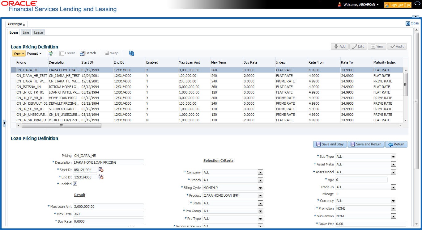

To set up the Pricing
  1. On the Oracle Financial Services Lending and Leasing home screen, click Setup > Setup > Administration > User > Products > Pricings > LoanLineLease.
  2. In the Pricing Definition section, perform any of the Basic Operations mentioned in Navigation chapter.
    A brief description of the fields is given below:
    Table 4-18 Pricing Definition
    Field Do this
    Pricing* Specify the code for the pricing.
    Description* Specify the description for the pricing.
    * Together these two fields define the name of the pricing.
    Start Dt Specify the start date for this pricing. You can even select the date from the adjoining Calendar icon.
    End Dt Specify the end date for this pricing. You can even select the date from the adjoining Calendar icon.
    Enabled Check this box to enable the pricing.
    Result section - You can create edits during implementation to note when amounts in applications are outside the range of tolerance.
    Max Loan Amt Specify the maximum amount financed for this rate pricing.
    Max Term Specify the maximum term financed for this rate pricing.
    Buy Rate Specify the buy rate.
    Index Select the index type associated with this rate pricing from the drop-down list.
    Rate From Specify the minimum rate allowed for loans using this rate pricing.
    Rate To Specify the maximum rate allowed for using this variable rate pricing.
    Maturity Index Select the maturity index type associated with this variable rate pricing from the drop-down list.
    Maturity From Specify the lowest maturity rate allowed for loans using this variable rate pricing. Maturity rate is the rate to be charged on the product if it remains unpaid after its last term has been billed.
    Maturity To Specify the maximum maturity rate allowed for products using this pricing.
    Profit Rate From
    Specify the minimum profit rate allowed for the product using this pricing.
    Note: This field will be displayed only if you select the category as Islamic in the Product screen.
    Profit Rate To
    Specify the maximum profit rate allowed for the loan using this pricing.
    Note: This field will be displayed only if you select the category as the Islamic in the Product screen.
    Selection Criteria - allows you to specify pricing at different levels and determine how the system matches specific pricing to the applicant’s request.
    Company Select the portfolio company for this pricing, from the dropdown list. This may be ALL or a specific company.
    Branch Select the portfolio branch for this pricing. This may be ALL or a specific branch. (This must be ALL if in the Company field you selected ALL), from the drop-down list.
    Billing Cycle Select the billing cycle for this pricing, from the drop-down list.
    Product Select the product for this pricing, from the drop-down list. This may be ALL or a specific product. The available values come from a validated field based on the selected billing cycle and the product setup.
    State Select the state for this pricing, from the drop-down list. This may be ALL or a specific state.
    Pro Group Select the producer group for this pricing, from the drop-down list. This may be ALL or a specific producer group.
    Pro Type Select the producer type for this pricing, , from the drop-down list. This may be ALL or a specific producer type.
    Producer Region Select the region of the producer.
    Producer Territory Select the territory of the producer.
    Producer Select the producer from the drop-down list. This may be ALL or a specific producer. The available values come from a validated field based on the product group and product type.
    Grade Select the credit grade for this pricing, from the drop-down list. This may be ALL or a specific grade.
    Amt Specify the minimum amount financed for this pricing.
    Loan Term Specify the minimum term for this pricing.
    Asset Class Select the asset class from the drop-down list. This may be ALL or a specific asset class. The available values come from a validated field based on the collateral type. You may create additional user-defined lookup codes for these lookup types as needed.
    Asset Type Select the asset type from the drop-down list. This may be ALL or a specific asset type. The available values come from a validated field based your assets setup.
    SubType Select the asset sub type from the drop-down list. This may be ALL or a specific asset sub type. The available values come from a validated field based your assets setup, and is linked to the selected asset type.
    Asset Make Select the asset make from the drop-down list. The available values come from a validated field based your assets setup and is restricted based on the selected Asset Type and Asset Sub Type. For example, If ALL was selected for either Asset Type or Asset Sub Type, then ALL will be the only available selection for the asset make.
    Asset Model Select the asset model from the drop-down list. The available values come from a validated field based your assets setup, and is restricted based on the selected Asset Type and Asset Sub Type. If ALL was selected for either Asset Type or Asset Sub Type, then ALL will be the only available selection for the asset model.
    Age
    Specify the asset age (the minimum age for the selected pricing).
    Note: If your entry in this field is based on the number of years of age of the asset and not the actual year of make, you must update this entry annually to ensure that the proper pricing is available.
    Trade-In Specify if there is a trade in of an asset by selecting Yes/No.
    Mileage If there is a Trade-In of an existing asset, then specify its mileage in km.
    Currency Select the currency for this pricing, from the drop-down list.
    Promotion Select the promotion applicable to this pricing from the dropdown list. The available values come from a validated field based on the promotions setup.
    Subvention Select the subvention plan from the drop-down list, if pricing is specific for any subvention plan.
    Down Pmt Specify the down payment for the pricing.
    Asset Value Specify the asset value.
    LTV Specify the loan to value ratio.
    Existing Customer
    Select one of the following options from the drop-down list to define the applicability of the current pricing definition:
    ALL - Applicable to both existing and new customers
    YES - Applicable to existing customer only
    NO - Applicable to new customer only.
    Note: This field refers to the Primary applicant Existing Customer flag.
    Existing Customer Since (In Years) Specify the duration from when customer was created in the system up to the current date in years.
    Selection Criteria : Business - allows you to specify number of years in business and determines how the system matches specific pricing to the business applicant's request.
    Years In Business Specify the total number of years in business.

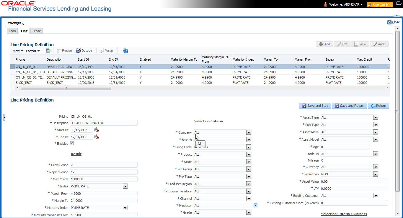

    Table 4-19 Pricing Definition
    Field Do this
    Result section
    Draw Period Specify the draw term for which this pricing is valid.
    Repmt Period Specify the repayment term for which this pricing is valid.
    Max Credit Specify the maximum credit Limit for this pricing.
    Index Select the index type associated as FLAT/PRIME RATE from the drop-down list.
    Margin From Specify the minimum margin rate for the selected index type.
    Margin To Specify the maximum margin rate for the selected index type.
    Maturity Index Select the maturity index type associated as FLAT/PRIME RATE from the drop-down list.
    Maturity Margin Rt From Specify the minimum margin rate for the selected maturity index type.
    Maturity Margin To Specify the maximum margin rate for the selected maturity index type.
    Selection Criteria
    Company Select the portfolio company for this pricing, from the drop-down list. This may be ALL or a specific company.
    Credit Limit Specify the minimum credit limit for which this pricing is valid.
    Age
    Existing Customer
    Based on the selection criteria, system defaults the first pricing for applications with Existing customer flag = Y at primary applicant details.
    Existing Customer Since (In Years) Specify the duration from when customer account was created in the system up to the current date in years.
    Selection Criteria : Business - allows you to indicate the age of business by evaluating the total number of years elapsed.

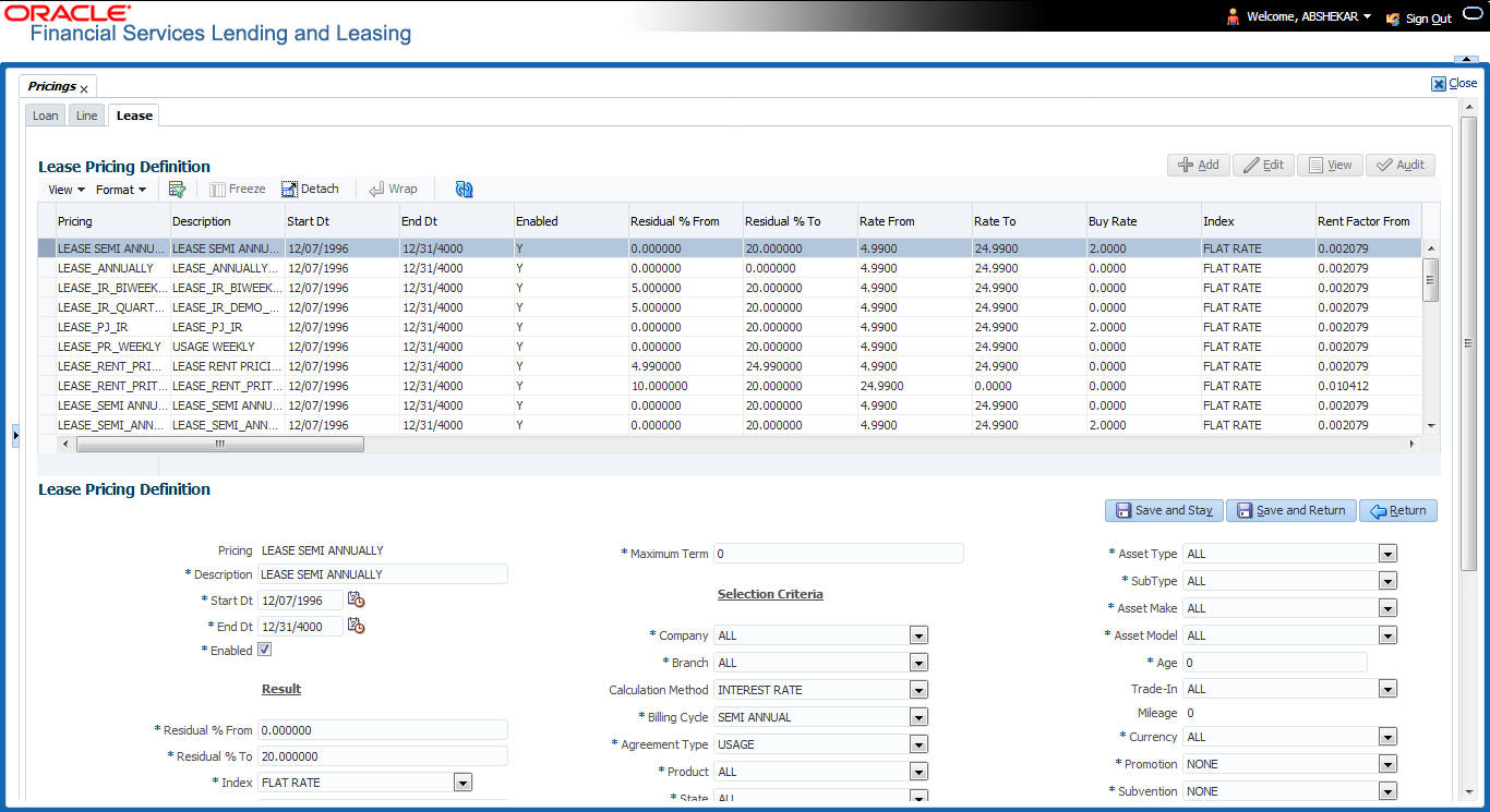

    Table 4-20 Pricing Definition
    Field Do this
    Result section
    Residual % From Specify the minimum residual percentage valid with this pricing.
    Residual % To Specify the maximum residual percentage applicable with this pricing.
    Index
    The index type associated with this rate pricing is autopopulated based on lease calculation method selected in Selection Criteria section. The same is derived from INDEX_TYPE_CD lookup.
    Note: For RENT FACTOR calculation method, only FLAT RATE index is applicable and is selected by default.
    Rate From Specify the minimum applicable rate.
    Rate To Specify the maximum applicable rate.
    Buy Rate Specify the buying rate.
    Rent Factor From
    Specify the minimum money factor valid with this pricing.
