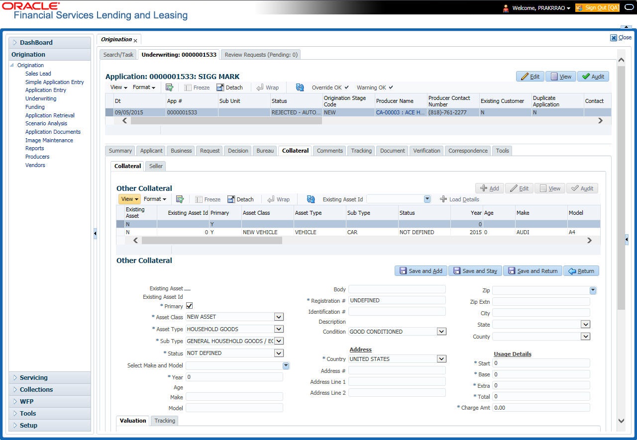

To verify information about the collateral
  1. Open the Underwriting screen and load the application you want to verify.
  2. Click the Collateral tab.
    Depending on the type of collateral, information about the vehicle, home, or other type of collateral appears.
    If you are entering an unsecured LoanLine of creditLease, the Collateral link is present but inactive; in which case, skip this step.
  3. In the Collateral Details section (This is information that was recorded during the application entry process or gathered during the credit pull.)
To enter collateral information
  1. On the Underwriting screen, click Collateral. If the collateral is a vehicle, the Collateral link displays information about the vehicle.
  2. Perform any of the Basic Operations mentioned in Navigation chapter.
    A brief description of the fields is given below:

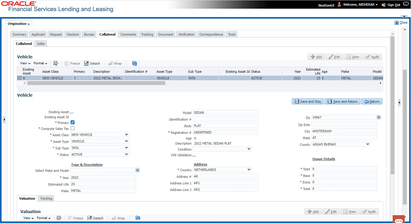

    Table 7-54 Collateral Information
    Field Do this
    Existing Asset Check this box to indicate that the vehicle is an existing asset.
    Existing Asset ID View the existing asset identification number.
    Primary Check this box if this is the main asset on the application.
    Compute Sales Tax Check this box to include the collateral for computing sales tax. If not selected, then the collateral details are not shared to external system and is excluded from sales tax computation.
    Asset Class Select the asset class.
    Asset Type Select the asset type.
    Sub Type Select the asset sub type.
    Status Select the asset status.
    Type and Description
    Select Make and Model Select the make and model of the vehicle from drop-down list.
    Year Specify the year of the vehicle.
    Age View the age of the vehicle
    Make Specify the make of the vehicle.
    Model Specify the model of the vehicle.
    Body Specify the body of the vehicle.
    Registration # Specify the vehicle registration number.
    Identification # Specify the vehicle identification number.
    Description View the vehicle description.
    Condition Select the vehicle condition.
    Address
    Country Select the country.
    Address Select the country.
    Address # Specify the apartment number.
    Address Line 1 Specify the first address line.
    Address Line 2 Specify the second address line.
    Zip
    Select the zip code.
    For non US country, you have to enter zip code.
    Zip Extn Specify the zip extension.
    City Specify the city.
    State Select the state.
    County Select the county.
    Table 7-56 Collateral
    Field Do this
    Address
    Zip
    Usage / Rental Details (Cycle)
    The below Usage / Rental sections are displayed only if the current Collateral is either of type VEHICLE or HOUSEHOLD GOODS AND OTHER COLLATERAL and the billing is based on Lease Usage or Rental type.
    For more information on how OFSLL handles Usage based leasing, refer to unresolvable-reference.html#GUID-B9ACB9DB-C51D-4BD4-87A4-D22809B433CD chapter and for Rental based leasing, refer to Rental Agreement section in Application Entry chapter.
    Usage / Rental Cycle
    Select the frequency of billing the asset from the drop-down list and click on Load Details button. If details are maintained for the selected billing frequency in Setup > Products > Asset Types > Usage/Rental Details screen, the same is auto populated and can be modified in this screen.
    This field is enabled only for USAGE agreement type.
    Min Usage per cycle View/specify the minimum usage value of the allowed range.
    Max Usage per cycle View/specify the maximum usage value of the allowed range.
    Base Rental Amount View the calculated Base Rental Amount populated from Rental Agreement tab. This field is applicable for Rental/Usage Rental agreement type.
    Security Deposit View the security deposit amount paid upfront for the term. This field is applicable for Rental/Usage Rental agreement type.
    Discount % View/specify the percentage of discount exempted from final billing.
    Discount Amount View the flat discount amount allowed upfront from the final billing. This field is applicable for Rental/Usage Rental agreement type.
    Usage Rollover/ Advance
    View/select the type of asset usage calculation as one of the following:
    • ROLLOVER (remaining usage balance is carried forward to next cycle)
    • NO-ROLLOVER (remaining usage balance is not carried forward)
    • ROLLOVER AND ADVANCE (remaining usage balance is carried forward to next cycle + total usage limit for current cycle can be utilized upfront)
    • ADVANCE (total usage limit for current cycle can be utilized upfront)
    Note: For Rental based lease agreement, only non rollover usage method is applicable.
    Reset Frequency View/specify the reset frequency of the billing cycle. This field is available for ROLLOVER, ADVANCE and ROLLOVER AND ADVANCE methods of asset usage billing.
    Elastic Term Calc Method
    View the system predicted term remaining to reach the asset usage life which is calculated by one of the following methods as per current usage pattern.
    • ACTUAL - here the current details updated/received is treated as the final record for usage term calculation.
    • AVERAGE - here the average of usage details received in previous cycles are considered for usage term calculation.
    Excess Rent Collection Method
    If you have selected the Agreement Type as USAGE RENTAL, view the Charge Matrix selected as one of the following type to derive the Excess Rent Collection Method:
    • USING USAGE MATRIX
    • USING RENTAL MATRIX
    Usage / Rental Calculation
    Calc Method
    View/select the calculation method as one of the following from the drop-down list.
    • TIERED (billing is based on the defined Usage/Rental Charge Matrix). This is the default value for Rental/Usage Rental agreement type.
    • NON-TIERED (system automatically chooses the applicable slab based on the final usage value)
    Usage / Rental Receipt
    View/select the Usage / Rental details as one of the following from the drop-down list.
    • INCREMENTAL (Details updated/received is considered as incremental record and is updated as new record in Servicing > Collateral > Usage History section without modifying existing record)
    • ACTUAL (Details updated/received is considered as latest record and is updated in Servicing > Collateral > Usage History section with Active/ current status as Y). This is the default value for Rental/Usage Rental agreement type.
    Usage Details (Life)
    The details maintained in this section is used to calculate EXCESS USAGE FEE in payoff quote and termination transactions.
    Start View/specify the start unit of asset usage.
    Base View/specify the base units.
    Extra View/specify the extra usage units.
    Total View/specify the total usage units.
