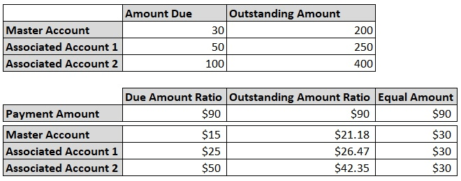

Following is an illustration on payment allocation:
Description of administrationuser_paymenthierarchy_illustration2.png follows
Description of the illustration administrationuser_paymenthierarchy_illustration2.png
