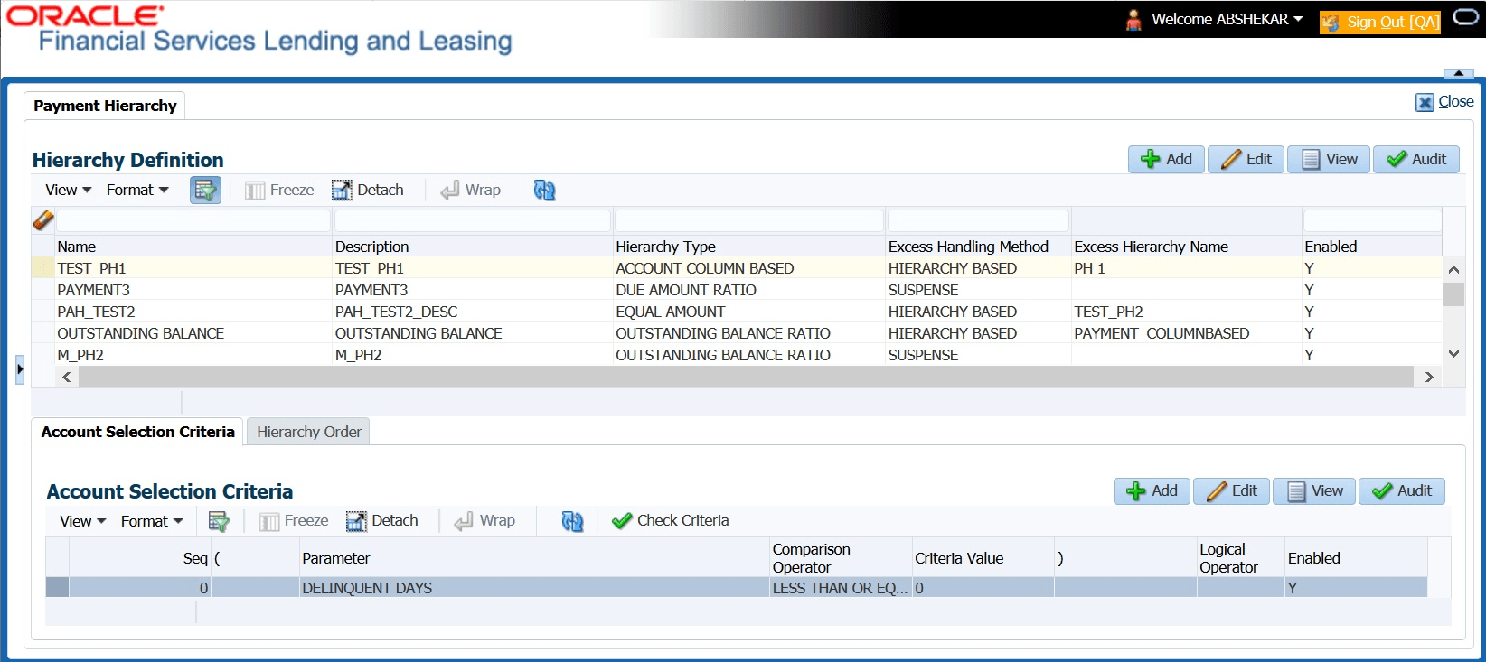

To set up payment hierarchy
  1. Click Setup > Setup > Administration > User > Payment Hierarchy.
  2. In the Hierarchy Definition section, perform any of the Basic Operations mentioned in Navigation chapter.
    Figure 3-72 Hierarchy Definition

  3. Perform any of the Basic Actions mentioned in Navigation chapter.
Account Selection Criteria
This sub tab facilitates to define the account selection criteria that is used to identify due account for payment allocation. Atleast one valid account selection criteria is required for all the Hierarchy Types.
  1. In the Account Selection Criteriasection, perform any of the Basic Operations mentioned in Navigation chapter.

Hierarchy Order
This sub tab facilitates you to define hierarchy order that is used to sort the due account for payment allocation. This sub tab is enabled only for ACCOUNT COLUMN BASED Hierarchy type.
  1. In the Hierarchy Order section, perform any of the Basic Operations mentioned in Navigation chapter. A brief description of the fields is given below:
