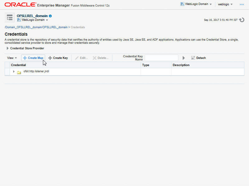

- Login to Oracle Enterprise Manager (http://hostname:port/em).
- On the left panel, right click on OFSLLREL_domain and select Security > System Policies > Credentials.The following window is displayed.

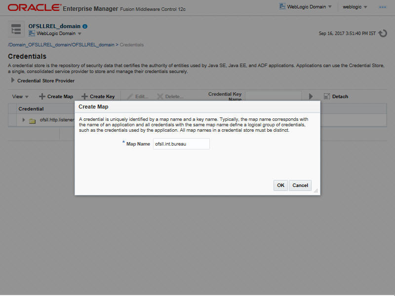

- Click Create Map.The following window is displayed.
- Enter Map Name as ofsll.int.bureau and click OK.

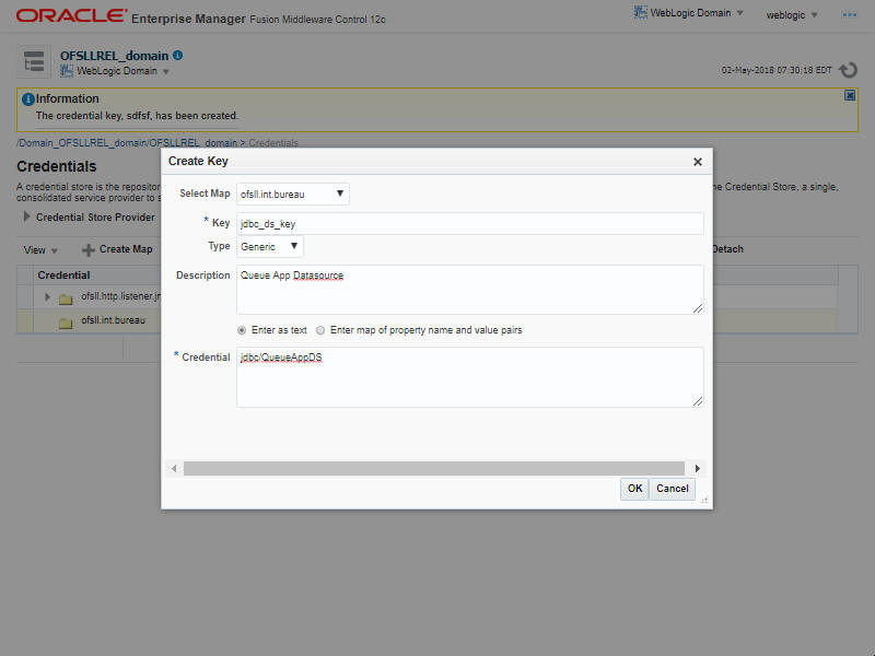

- Click Create Key.The following window is displayed.
- Specify the following details:
- Select Map as ofsll.int.bureau from the drop down list.
- Specify Key as jdbc_ds_key
- Select Type as Generic from the drop down list.
- Specify the Credential as jdbc/QueueAppDS
- Click OK.

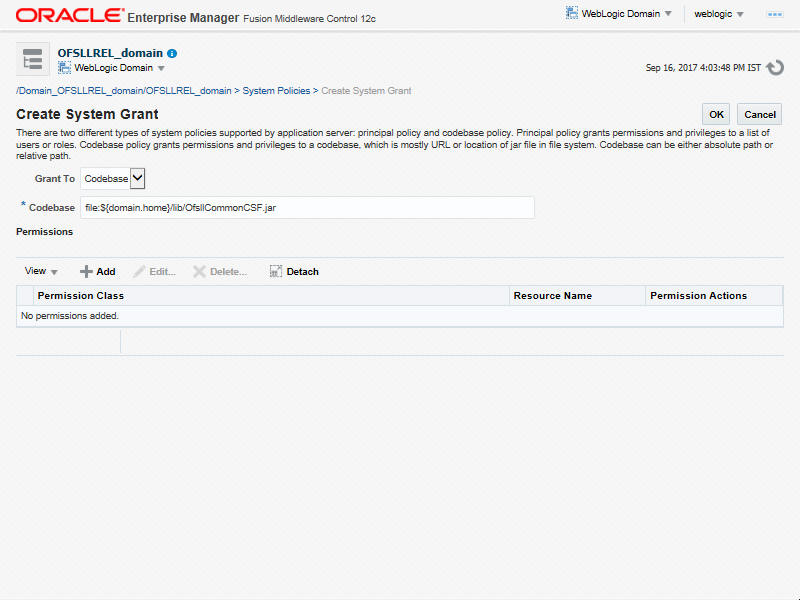

- Click Create.The following window is displayed.
- Enter the codebase as
file:${domain.home}/lib/OfsllCommonCSF.jar. - Click Add.The following window is displayed.

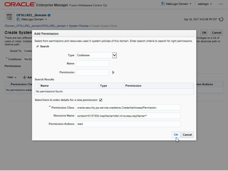

- Select the check box Select here to enter details for a new permission.
- Specify the following details as the first permission class.
Table 8-2 Permission Class
Permission Class Resource Name Permission Actions oracle.security.jps.service.credstore.CredentialAccessPermission context=SYSTEM,mapName=ofsll.int.bureau,keyName=* read oracle.security.jps.service.credstore.CredentialAccessPermission context=SYSTEM,mapName=ofsll.int.filetransfer,keyName=* read oracle.security.jps.service.credstore.CredentialAccessPermission context=SYSTEM,mapName=ofsll.int.outbound,keyName=* read oracle.security.jps.service.credstore.CredentialAccessPermission context=SYSTEM,mapName=ofsll.int.bip,keyName=* read oracle.security.jps.service.credstore.CredentialAccessPermission context=SYSTEM,mapName=ofsll.int.gri,keyName=* read oracle.security.jps.service.credstore.CredentialAccessPermission context=SYSTEM,mapName=ofsll.int.common,keyName=* read oracle.security.jps.service.credstore.CredentialAccessPermission context=SYSTEM,mapName=ofsll.http.listener.jndi,keyName=* read oracle.security.jps.service.credstore.CredentialAccessPermission context=SYSTEM,mapName=ofsll.int.webhook,keyName=* read, write, update oracle.security.jps.service.keystore.KeyStoreAccessPermission stripeName=OFSLL_STRIPE,keystoreName=OFSLL_KSS,alias=* read - Click OK.
