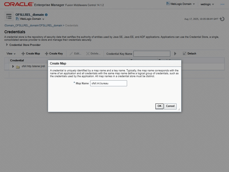

  3. Click Create Map.
    The following window is displayed.
  4. Enter Map Name as ofsll.int.bureau and click OK.

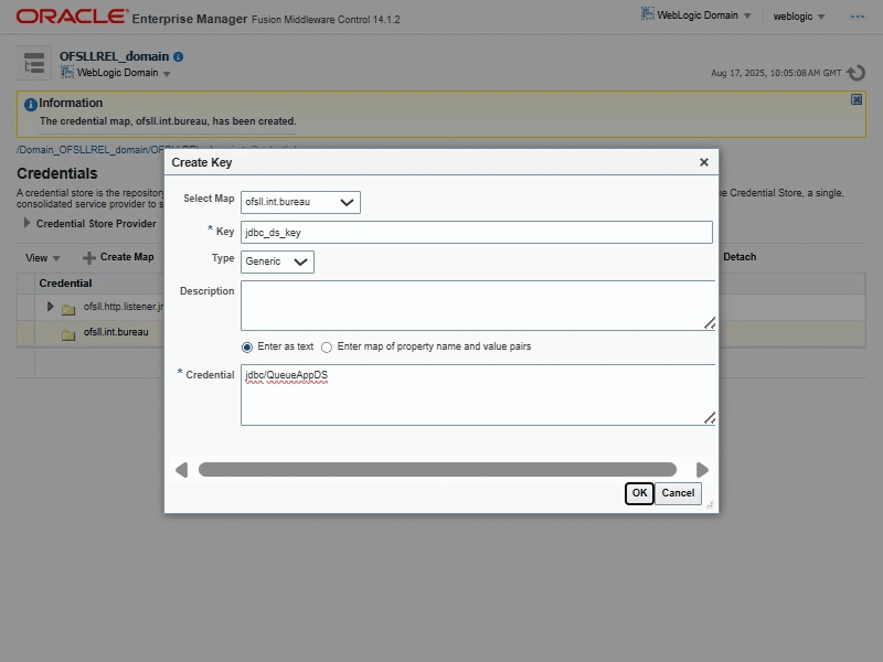

  5. Click Create Key.
  6. Specify the following details:
    • Select Map as ofsll.int.bureau from the drop down list.
    • Specify Key as jdbc_ds_key
    • Select Type as Generic from the drop down list.
    • Specify the Credential as jdbc/QueueAppDS
  7. Click OK.

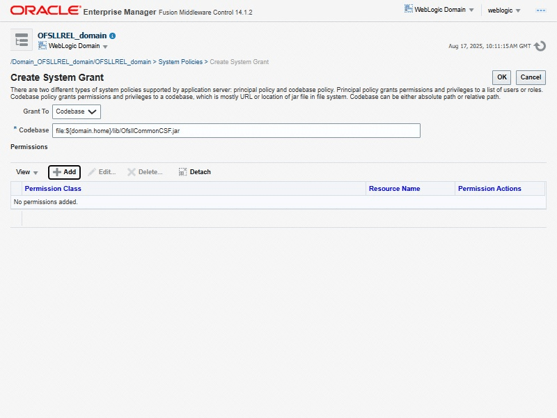

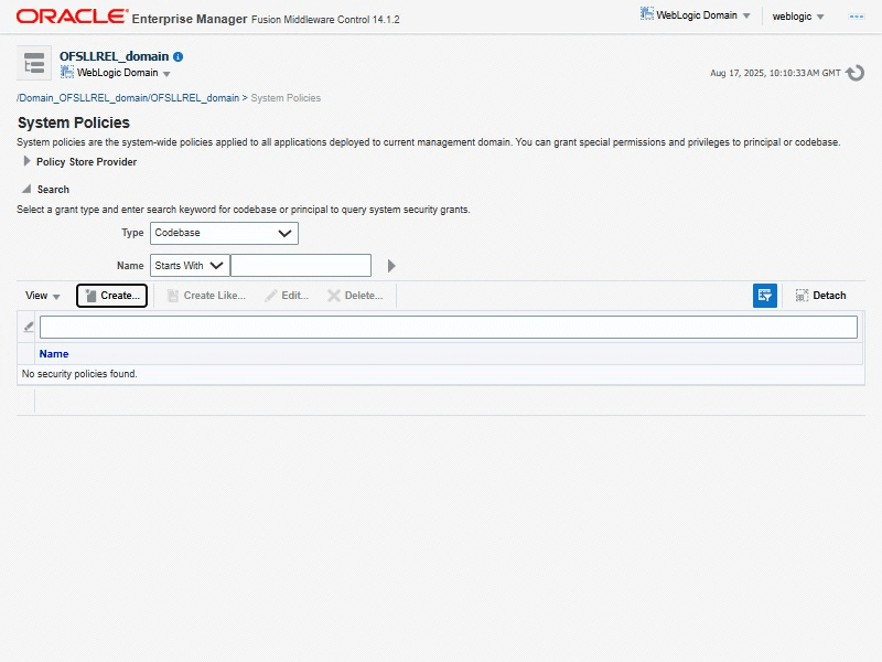

  9. On the left panel, right click on OFSLLREL_domain and select Security > System Policies.
  10. Click Create.
    Figure 8-73 Create System Grant
  11. Enter the codebase as file:${domain.home}/lib/OfsllCommonCSF.jar.
  12. Click Add.

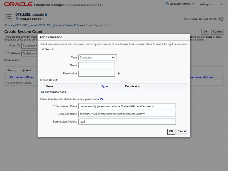

  13. Select the check box Select here to enter details for a new permission.
  14. Specify the following details as the first permission class.
    Table 8-2 Permission Class
    Permission Class Resource Name Permission Actions
    oracle.security.jps.service.credstore.CredentialAccessPermission context=SYSTEM,mapName=ofsll.int.bureau,keyName=* read

  15. Click OK.
